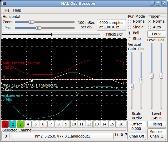

At last This my conf (ini file attach) .... it works quite good .... I change feedback signal to 2500ppr encoder direct ..... I have an other issue ... in pos move the machine go directly to quote ... in neg move it stop 8° first and than go to quote slowly ..... some reason or adjust to ini file for solve these??

hal scope image during working (+90 to -90° continuosly ...)
in addition I have to keep ferror 50 otherwise I get error tracking .... I tried to lower to the acceleration ... but I would be forced to lower it too ......
Can you use the "Calibrate axis" option in the Axis menu? That is a much faster way to test PID settings than editing the INI file.
If the system takes too long to correct a static error then you probably want a bit of I-gain. But it might also be that the P-gain isn't high enough.
There is a reason that they call it PID "tuning", you need to try a number see if it is better, try a bit more or a bit less, try again.
You _could_ try the Ziegler-Nichols method which is mentioned in this general page about PID control.
it.wikipedia.org/wiki/Controllo_PID
Last edit: 06 Nov 2015 21:17 by andypugh.

06 Nov 2015 23:08 - 07 Nov 2015 00:22 #64907 by bkt
Replied by bkt on topic servo dac offset
Ok but why only in one direction? How can make simmetric the error ? Because I move only +90° and -90° continuosly but only at -90° have a problem when go to +90° the axis stop perfect. On the the servo motor shaft is connected to anything . No load on servomotor shaft .... I expect an error identical on both directions.

07 Nov 2015 18:50 - 07 Nov 2015 18:50 #64957 by bkt
This night I have an illumination .... the halscope posted before show a mouvement of axis from -90° to 90° ..... in these space (this is more or less my axis working area) is impossible that the axis go to 1000°sec velocity ... this is normal ... but I have set the acceleration to 5000° sec .... in the draw of hascope, I see that is noth enough ... probabily I need to go at max vel (not 1000°sec but 500°sec is probabily enought) in 20-30msec ..... without these my tuning is not possible ....
regards
