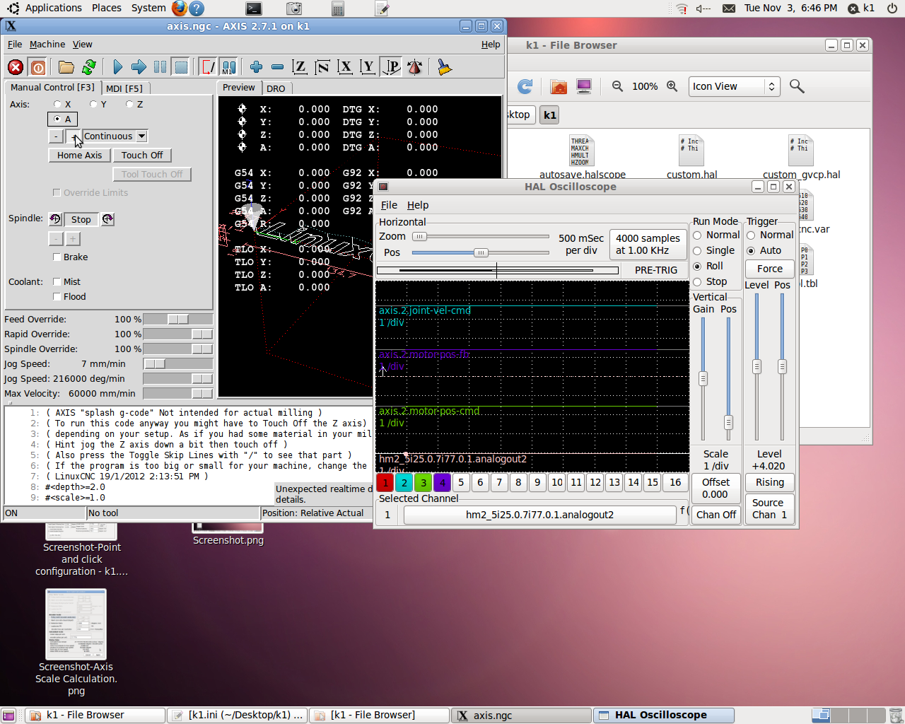

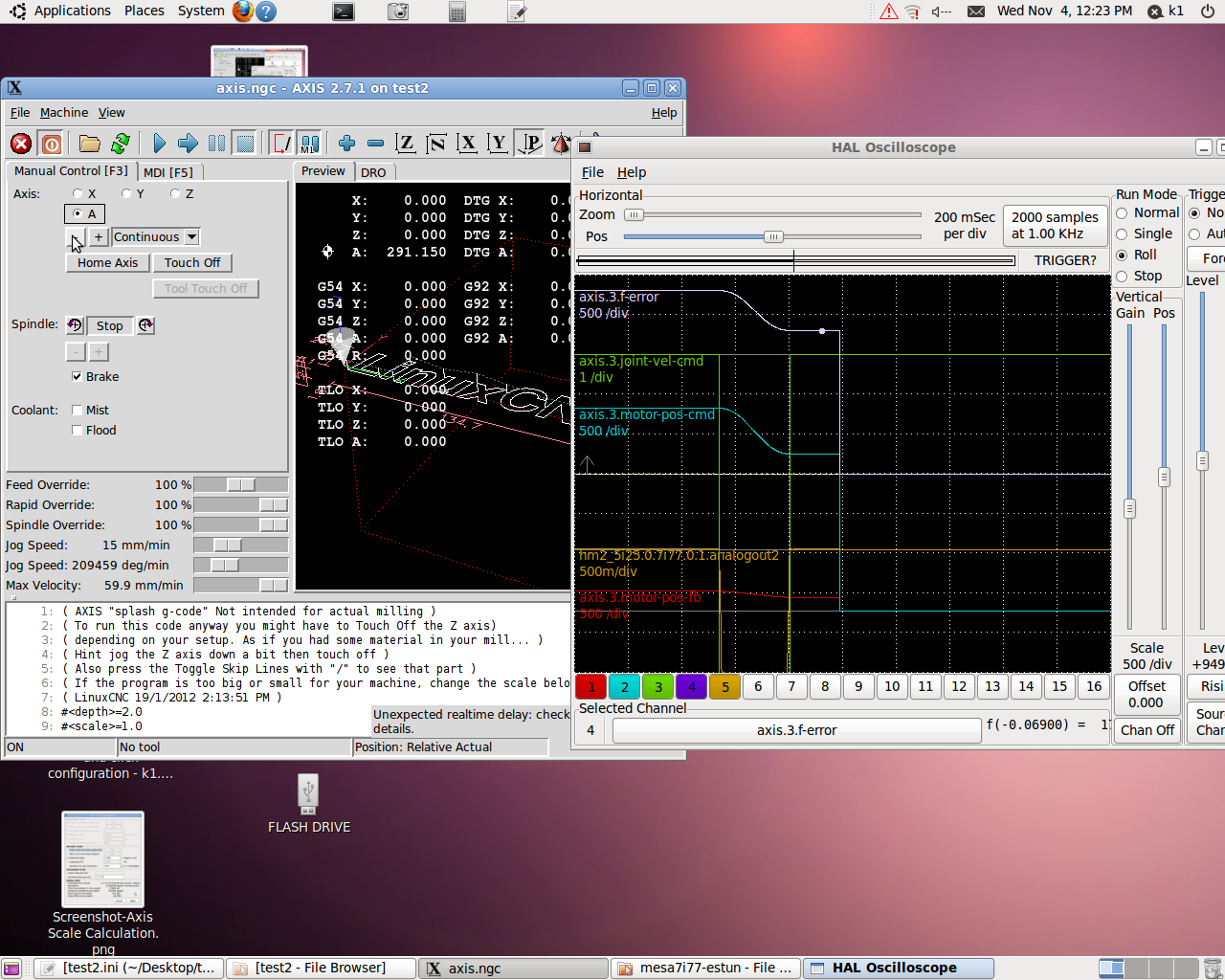

04 Nov 2015 19:54 #64743 by bkt
Replied by bkt on topic servo dac offset
I make a new conf ... than I restart .... all ok .... I try a tuning quite good .... but some things not understand (and I have follw error) ... add alscope image ... someone could teach me what 's wrong with this graph ? .... Work already encoder reversed ...
The motor run at desired vel .... and move to desired position .... (with some error because ferror is set to hight number for test the system)
regards
giorgio

04 Nov 2015 20:58 #64745 by andypugh
Replied by andypugh on topic servo dac offset
The graph looks like it does because you are in roll-mode with the trigger point in the middle.
In roll-mode the data slides out from the trigger point to the left.
The following user(s) said Thank You: bkt

05 Nov 2015 01:57 - 05 Nov 2015 02:03 #64760 by bkt
@ andyPugh Thanks ... it's clear these ... but I have these situation:
jog
the motor moves in the desired direction and at the desired speed
The motor stops when the desired position
automatically
engine " follows " the programmed path without much accuracy (they are testing and I set a high ferror )
It stops at the end of the program cycle in the wrong position , but very slowly back to the correct position when the program is now completed at least 1 minute
This default behavior qualceh good soul knows me indicate what is the symptom ? (is possible from motitor see anythings? these situation suggest to control somethings??)
My scale encoder and pid.... I set only P and I both drive on which LCNC , and a very low value ( 0.02 % ) of FF1 on LCNC and feedfoward percentage on the drive ......
I 250 ( * 4 ) pulses per revolution of LCNC and 2500 ( * 4 ) on the drive .... as I said the drive provides a function to reduce the pulses per revolution to control .... 1000rpm max speed reducer 10/1 ( 10 engine rpm = 1 turn led ) encoder ratio 27.7778 my units are degrees 1 tour conducted = 360 ° = 3600 ° engine

05 Nov 2015 03:23 #64765 by PCW
Replied by PCW on topic servo dac offset
Are you sure the drives are set-up for velocity mode?
PWM frequency is meaningless (not used by 7I77)
Most of your tuning is done with FF1 (assuming your drives are in velocity mode)
and then P is increased until it becomes unstable than backed off about 50%
FF1 = 1.0 if you set the analog output scale properly = machine units per second
(degrees per second at 10V for rotary axis) As the tutorial suggests, too much FF1
makes the position lead the command, while too little make the position lag the command
Unless you have extreme accuracy requirements (a coulple um),
A 1 KHz update rate is fine for velocity mode servos
(the drives themselves close the velocity loop at a much higher rate)
