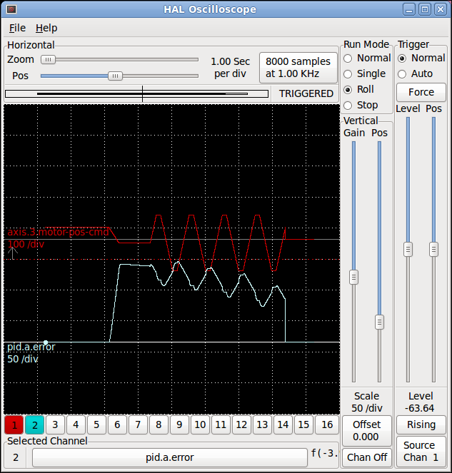

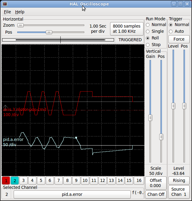

05 Nov 2015 19:40 - 05 Nov 2015 22:10 #64815
by bkt
Replied by bkt on topic servo dac offset
some filter in drive are active ... and I disable it ...ok.
I put P at 5 first and increase FF1 ..... At the end of operation P in Lcnc and in drive are equal ... FF1 in drive is at 1/4 of scale value but in Lcnc are much highter .. see below
in hal file all seems ok ...
But the result are not very good .... my gcode test put the axis to 90° make a pause of 0.1sec and put axis to -90° ... for 10 time ... after go to 50° and stop (all with G61).... the motor and reducer (at the motor I applied a reducer ratio 1/10) correctly turn on and turn of from 180° (I apply a hand to control the crowds results ... I can see 180° but not see the exact start and end point ... ) but in axis never see an exat stop to 90° or -90° bu for example 20 to -160 ... or 30 to -150 with random value .... the acceleration is hight .... but at the and When go to 50° the acceleration is 50% and in axis I see an stop at 70° and in 3 sec the end of program the value turn on 50°. During this positioning the program stop.
Hal scope Image of program run and during program stop ...

05 Nov 2015 20:00 #64816
by bkt
Now I try to reduce the velocity in G code to 0.1% .... in first test I set F8000 now I set F8 ...... the drive go to the maximum velocity at 10V refer and turn for 30000° +/- instead of 90° ...... ?????

06 Nov 2015 00:03 #64835
Replied by PCW on topic servo dac offset
Looks like at the minimum the FF1 is still completely wrong
I would set a P of say 1 and then adjust FF1 for as straight a line as you can get in the jogs
(dont worry about the offset error just try for a )
Also hard to see at that slow rate but it looks like the accel is very high I would lower this until
you get the tuning dialed in

sorry for spoiler .... but BBCcode editor not work now on my pc.... but as you see the attachment upload hanyhow
My intention is make 60rpm at the and of servomotor .... after the motor I have a reducer 1/10 ... so for 60rpm at the end the motor make 600rpm .... I have divide the encoder feedback to 1/10 The motor have 2500 ppr encoder with 0 signal so the drive output a feedback of 250ppr .... I try these with halmeter .... 1RPM at the end of servomotor = 10000 pulse encoder (250*10*4) ... it seems ok ... but when run my g code :
the A axis go to 31000 and -31000 in while cicle (plus or less not see exactly) ....
Now I see that F in gcode (and with these conf) is equal to velocity on drive ... so if I set F60 drive go to 60rpm ... if set F600 drive go to 600rpm ....and so .... The vel that I set was too hight .... but there are other wrong setting ...
G21 G90
#30 = 0
G0 F300 A0
o100 while [#30 LT 10]
G61 F300 A90
G4 P0.1
G61 F600 A-90
G4 P0.1
o100 endwhile
G61 F100 A50
M30the A axis go to 31000 and -31000 in while cicle (plus or less not see exactly) ....

OK for axis A a FF1 of 1 is probably about 30x too high
(FF1=1 _ONLY_ if the axis is scaled actual velocity = machine units per second at 10V to drive)

Sorry not understand very well ... actual velocity is velocity of motor (1) or final velocity after reducer(2)?
case 1 .... at 10V 600rpm ... 60°sec => 10
case 2 ... at 10V 60rpm ... 60°sec => 1
Anyhow ... with FF1 = 0.03 if move in gcode A = 90° obtain about 260/300° velocity decrease to 10%.... at 0.003 obtain about 150/200° but the velocity decrease to 1% .....
Regards
Giorgio
