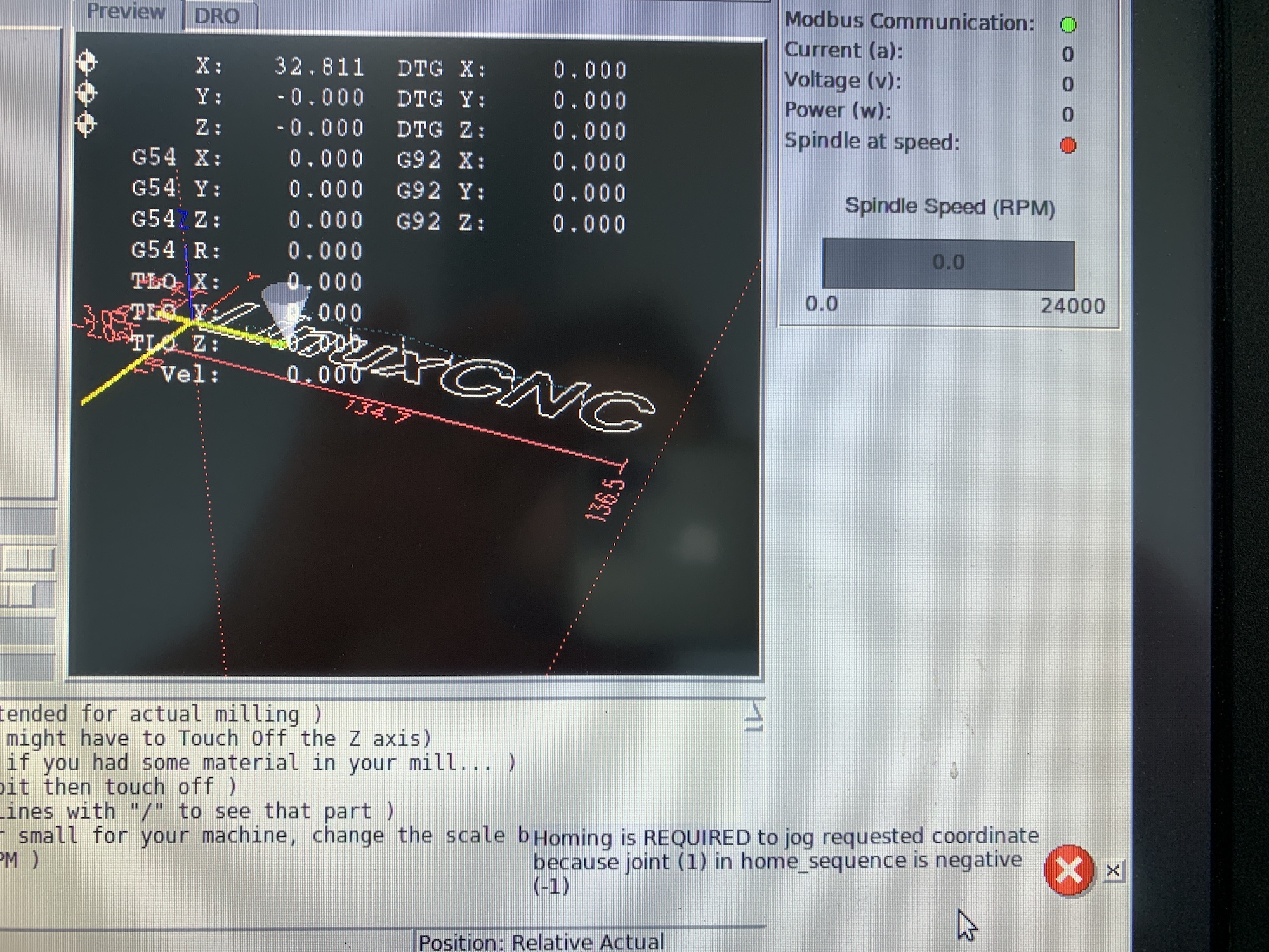

- deemoss
- Posts: 20
30 Sep 2019 11:59 - 30 Sep 2019 12:04 #146706
by deemoss
Replied by deemoss on topic How to. 2 or more motors on one axis. Gantry LinuxCNC 2.8 Master
Hi Guys, thanks for the excellent write up.
1.
I have implemented the changes in 2.8pre and it seems that I am able to home the 2 joint Y gantry (Home ALL). As you can see in the screenshot 1, the router LOOKS homed. Then when I try to jog Y, I get this error (as if it hasn't been homed). Why could this be?
2.
When (in Axis) going to Machine -> Homing I see two "Home Axis Y". If I try one of them does it mean that only one joint will start moving? Screenshot 2.
Cheers,
Dimos
1.
2.
Cheers,
Dimos
