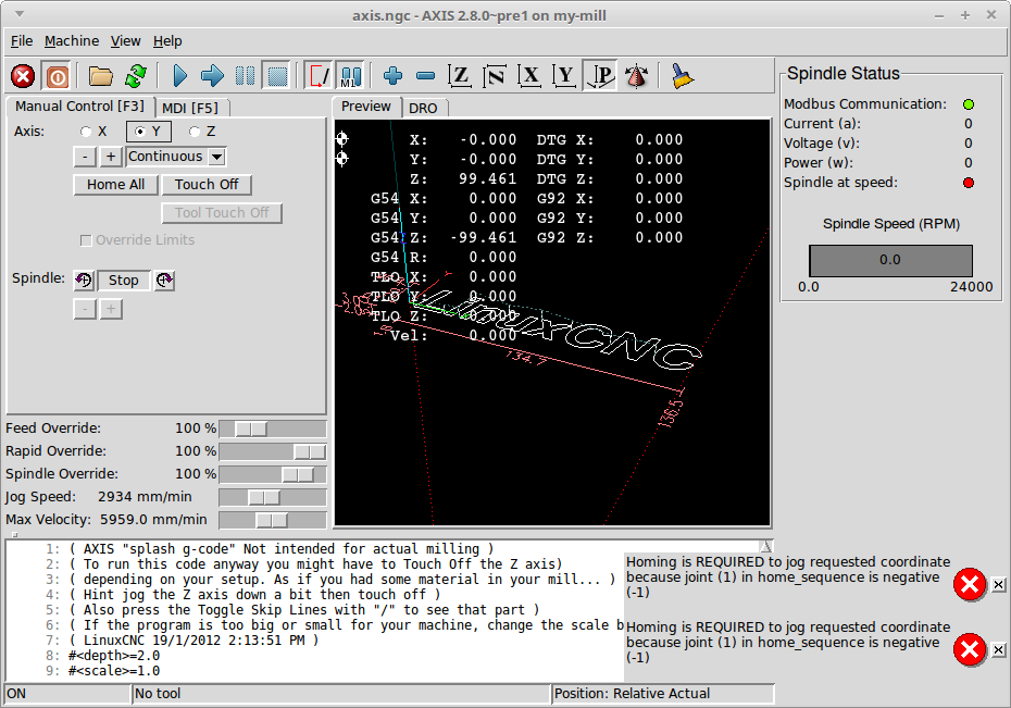

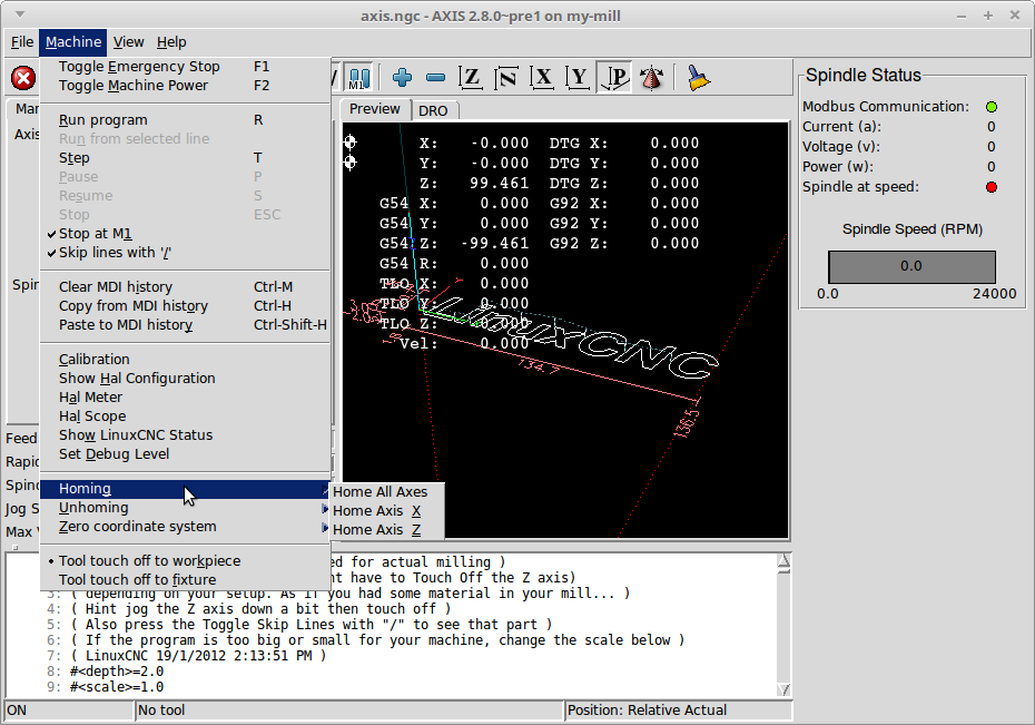

I (kind of) fixed it after reading your comments by adding the second Y to:
[TRAJ]
COORDINATES = X Y Y Z
Now when I go to Machine -> Homing i don't see the Y axis (is this correct?) see screenshot homing.png.
Also, after I do Home ALL (actually that does not include homing Z because I have no sensors on it - #HOME_SEQUENCE is commented out) and then try to jog Y, I get this error which refers to joint1 (part of axis Y) not being homed. The strange thing is that I can jog Y after I Touch Off Z. Screenshot Moving Y-after homing ALL.png.
I also attached my INI and HAL files.
Dimos
[TRAJ]
Dimos

01 Oct 2019 13:04 #146802
by dgarrett
Ref: linuxcnc.org/docs/2.8/html/config/ini-homing.html
Specifically:
Ref: linuxcnc.org/docs/2.8/html/config/ini-ho....html#_home_sequence
Use "Immediate homing" for the joint that
corresponds to the Z coordinate (joint 2 in your case)
if it has no home switches
Ref: linuxcnc.org/docs/2.8/html/config/ini-ho...ml#_immediate_homing
When using trivkins for a gantry with two joints for a
coordinant, it is recommended to use kinstype=Both in
order to see the homing condition for each joint.
The attached ini file is a sim config based on your ini
file for demonstration (it is a simulation, no hardware
required):
Replied by dgarrett on topic How to. 2 or more motors on one axis. Gantry LinuxCNC 2.8 Master
If HOME_SEQUENCE is not specified then the joint
will not be homed by the HOME ALL sequence (but may be
homed by individual joint-specific homing commands).Ref: linuxcnc.org/docs/2.8/html/config/ini-homing.html
Specifically:
Immediate Homing
If a joint does not have home switches or does not have
a logical home position like a rotary joint and you
want that joint to home at the current position when
the "Home All" button is pressed in the Axis gui, then
the following ini entries for that joint are needed.
HOME_SEARCH_VEL = 0
HOME_LATCH_VEL = 0
HOME_USE_INDEX = NO
HOME equals to HOME_OFFSET
HOME_SEQUENCE = 0 (or other valid sequence number)Ref: linuxcnc.org/docs/2.8/html/config/ini-ho...ml#_immediate_homing
required):
The following user(s) said Thank You: deemoss
