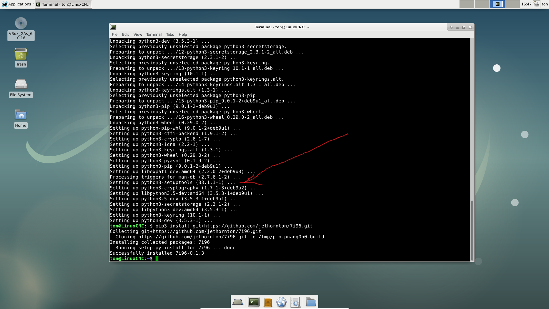

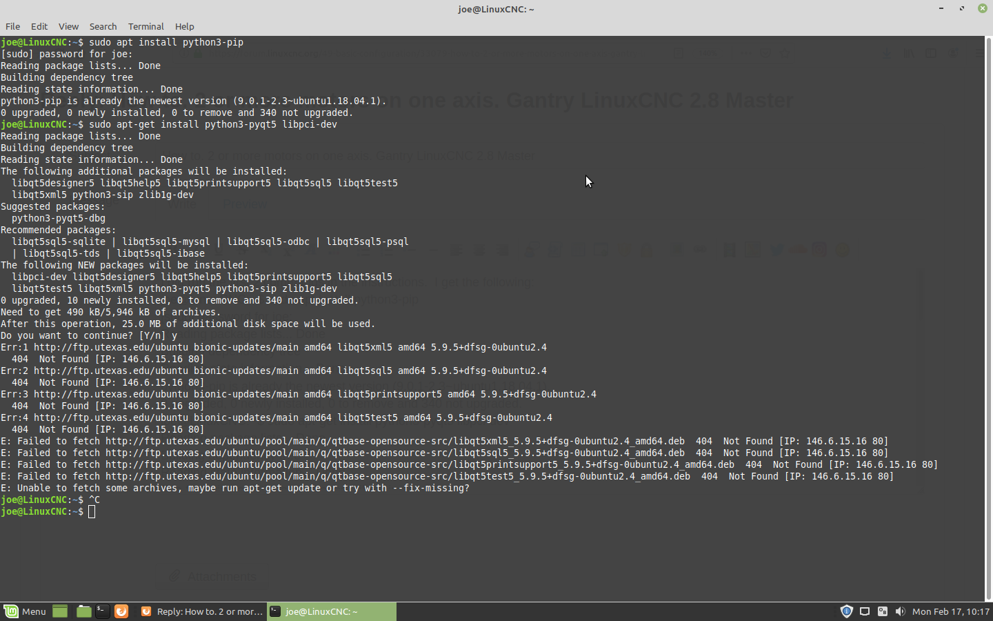

When I go to install the tool from github I get the following error,
"joe@LinuxCNC:~$ pip3 install git+https://github.com/jethornton/7i96.git
Collecting git+https://github.com/jethornton/7i96.git
Cloning github.com/jethornton/7i96.git to /tmp/pip-_77qnkxs-build
Complete output from command python setup.py egg_info:
File "<string>", line 1, in <module>
ModuleNotFoundError: No module named 'setuptools'
Command "python setup.py egg_info" failed with error code 1 in /tmp/pip-_77qnkxs-build/
I am running Mint 19.2 mate, don't know if that matters.

github.com/jethornton/7i96/issues/8
packaging.python.org/tutorials/installin...wheel-are-up-to-date
Debian is the way to go
python -m pip install --upgrade pip setuptools wheelDebian is the way to go

I am dropping this on this thread. I will rethink my options and maybe start over with Debian. Thanks for your help.
