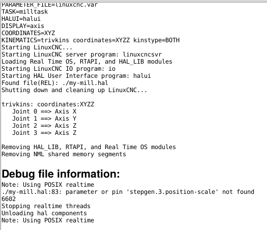

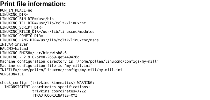

Replied by kevin19 on topic How to. 2 or more motors on one axis. Gantry
- Clive S
- Posts: 2204
- Thank you received: 486
09 Sep 2020 12:20 #181425
by Clive S
for a start change this in the ini file
COORDINATES = XYZ to
COORDINATES = XYZZ
Replied by Clive S on topic How to. 2 or more motors on one axis. Gantry
Hello, I did almost the same to have my 2 steppers in the Z axis in linuxcnc 2.9 master version but I am getting the following error, can someone help me? I am also attaching my ini and hal files to this message.
COORDINATES = XYZZ
The following user(s) said Thank You: kevin19
- Posts: 22009
- Thank you received: 7491
09 Sep 2020 13:40 #181440
Replied by tommylight on topic How to. 2 or more motors on one axis. Gantry
From your hal file:should be
loadrt stepgen step_type=0,0,0loadrt stepgen step_type=0,0,0,0
- kevin19
- Posts: 35
09 Sep 2020 14:05 #181447
by kevin19
Thank you!
