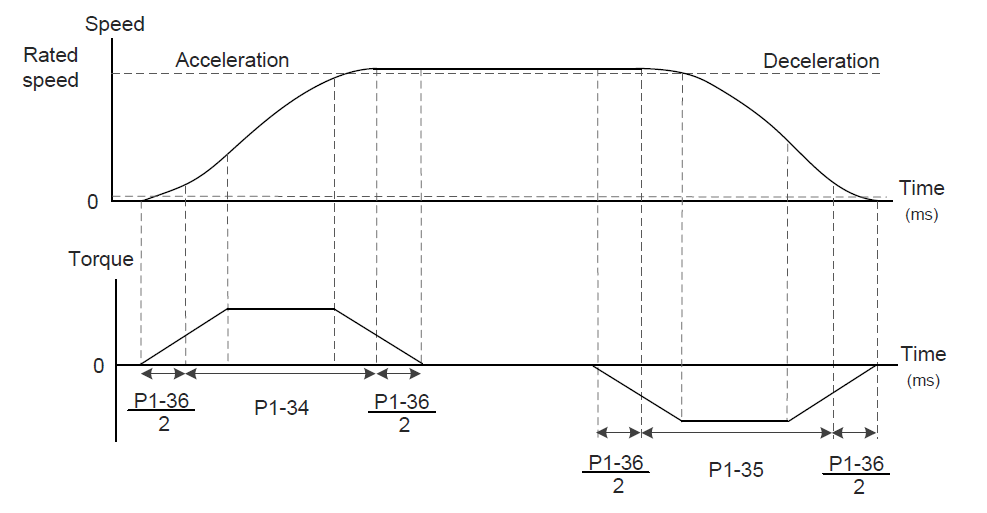

configure the parameters
P1-34
P1-35

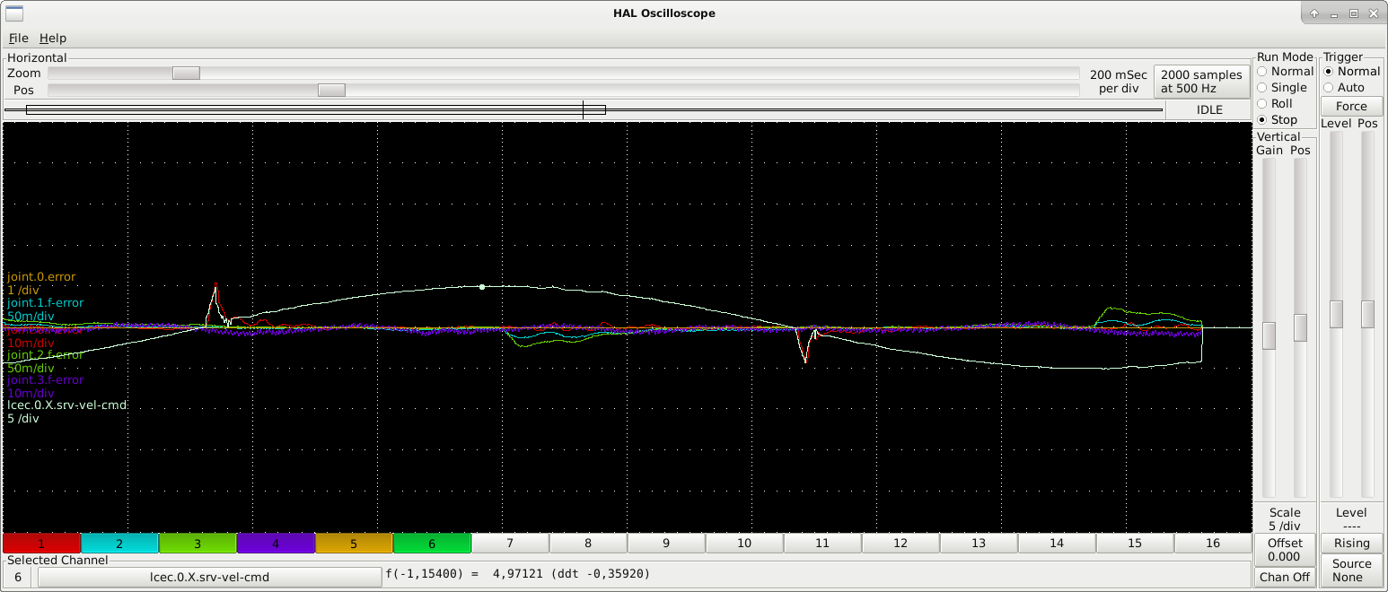

"lcec.0.x.srv-velo-cmd" refuses me.
Did you mean "lcec.0.x.srv-vel-cmd"? That was ok.
I setup:
P = 1 (gradually increased up to 25,000)
I = 0
D = 0
FF0 = 0
FF1 = 1
FF2 = 0
DEBAND = 0
MAX_OUTPUT 30000
and still a huge f-error.
I changed the encoder settings (P1-44 = 1 and P1-45 = 1)
SCALE = 15
and it was better.
I ended up here:
P = 130
I = 0
D = 0
FF0 = 0
FF1 = 1.12
FF2 = 0.006
DEBAND = 0
MAX_OUTPUT 30000
The result in the pictures. It's a spiral again.
I don't think it's ok.
How to improve it?

have you given him more acceleration?
P1-34
P1-35

I only set the acceleration to 1500 in Lcnc.
Visible change in acceleration.
But I will try to set the acceleration of both P1-34 and P1-35.
I thought it would be enough to set up Lcnc.

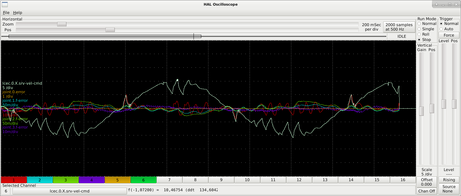

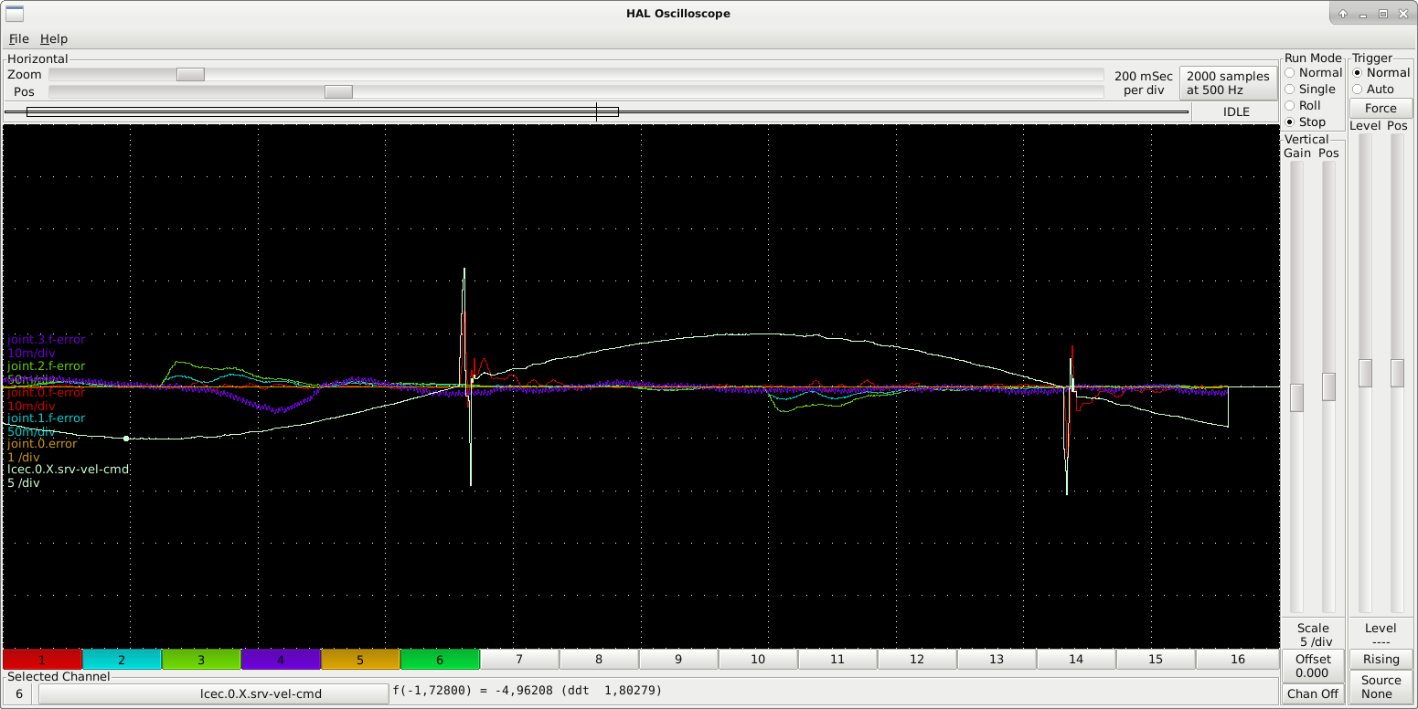

25 Jun 2020 06:44 #172704 by jirkam
Replied by jirkam on topic ASD-A2 EtherCAT on LinuxCNC
Hi @chimeno
Here are the pictures with "lcec.0.x.srv-velo-cmd".
P = 120
I = 0
D = 0
FF0 = 0
FF1 = 1.12
FF2 = 0.006
DEBAND = 0
MAX_OUTPUT 30000
SCALE = 15
P1-34 = 200
P1-35 = 200
Thanks jirka
25 Jun 2020 07:22 #172717 by tommylight
Replied by tommylight on topic ASD-A2 EtherCAT on LinuxCNC
As far as i know, FF1 can not be over 1.
I might be wrong though as i never checked, but i also never needed to go over it to tune a servo system.
25 Jun 2020 07:38 #172719 by jirkam
Hi @chimeno
Replenishment.
I forgot to change one parameter in the .ini.
MAX_ACCELERATION = 1500.0
This is how the curve changed.
Thanks jirka
