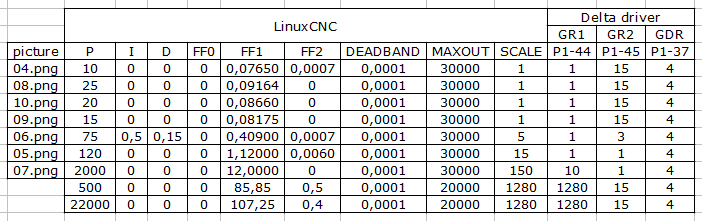

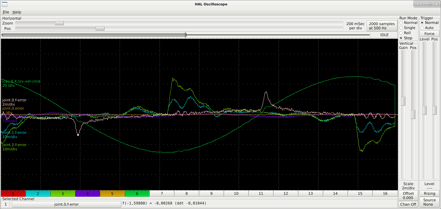

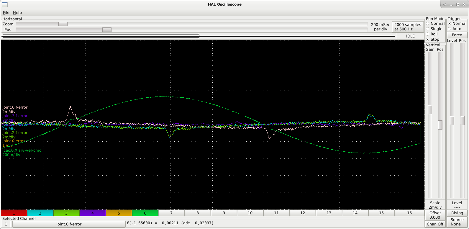

04 Jul 2020 20:39 #173625 by jirkam
Replied by jirkam on topic ASD-A2 EtherCAT on LinuxCNC
@tommylight
I found that "I" depends on the output resolution of the ASD-A2.
Here is a table of test settings.
The result is almost the same. Only when the resolution of the ASD-A2 is higher is it very difficult to set and the system is then unstable after 5 minutes of milling.
For pictures, watch only the "joint.0.f-error" - light color curve.
The following user(s) said Thank You: chimeno

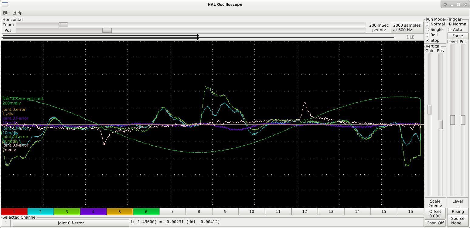

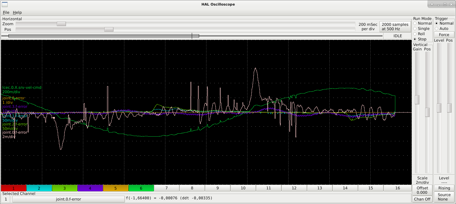

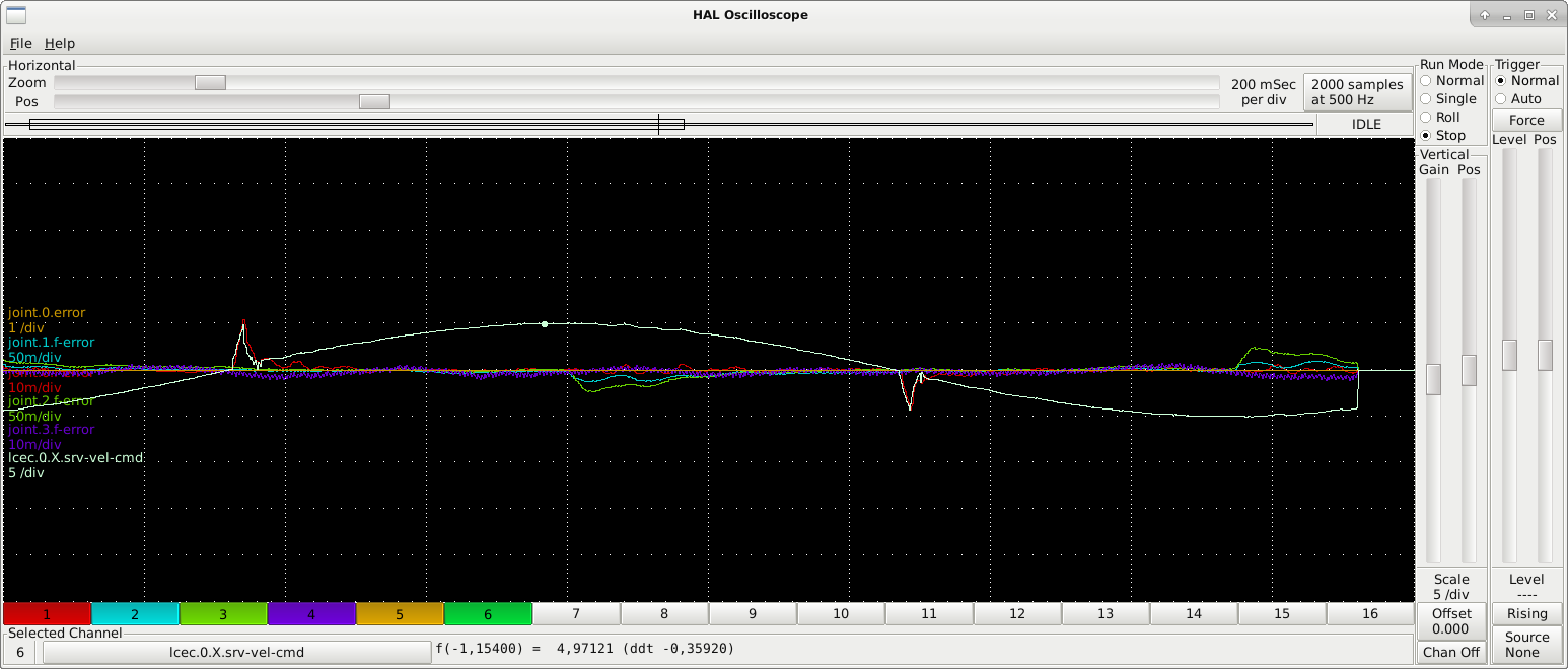

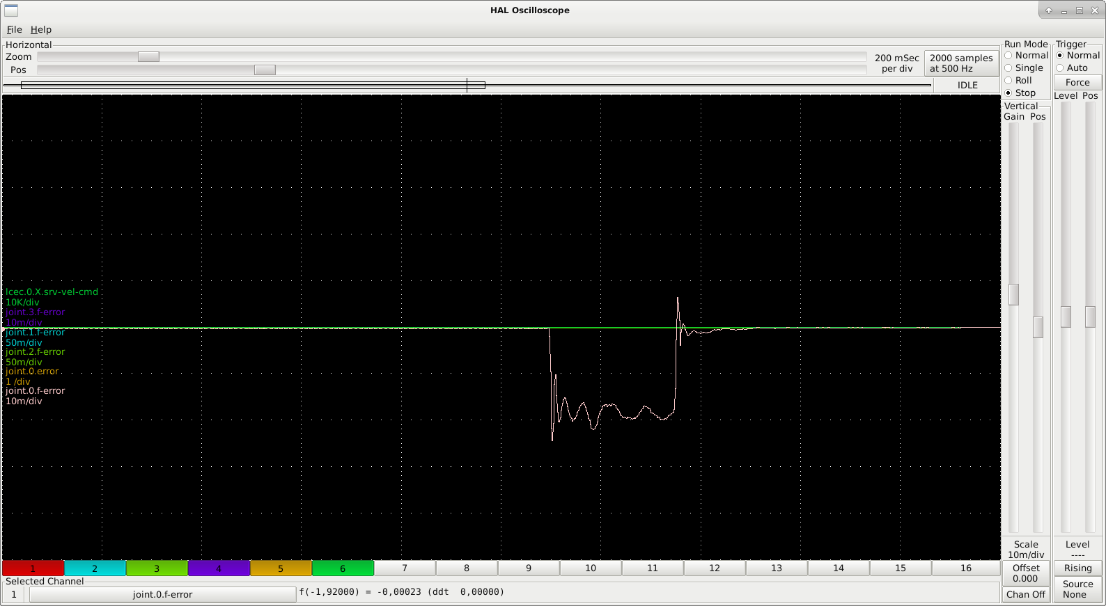

04 Jul 2020 20:42 #173626 by jirkam
@chimeno
Does not matter. I've been testing all week. See above.
I'm done setting 10.png. But I will make a few more changes according to you.
the speed control problem that you first have to adjust in the drive configuration so that it works at the speed and acceleration you need in the machine and then finish adjusting in linuxcnc
Do you mean "MAX_ACCELERATION", "MAX_OUTPUT" and "MAX_VELOCITY"?
"MAX_ACCELERATION" is parameter P1-34 and P1-35 for ASD-A2. But I don't know how to convert "MAX_ACCELERATION = 1500" to "ms" for ASD-A2?
And which ASD-A2 parameter corresponds to "MAX_OUTPUT = 30000" and "MAX_VELOCITY = 200"? P1-40 or P1-55?
I apologize for the large number of questions.
Thank you very much and have a nice day.
Jirka

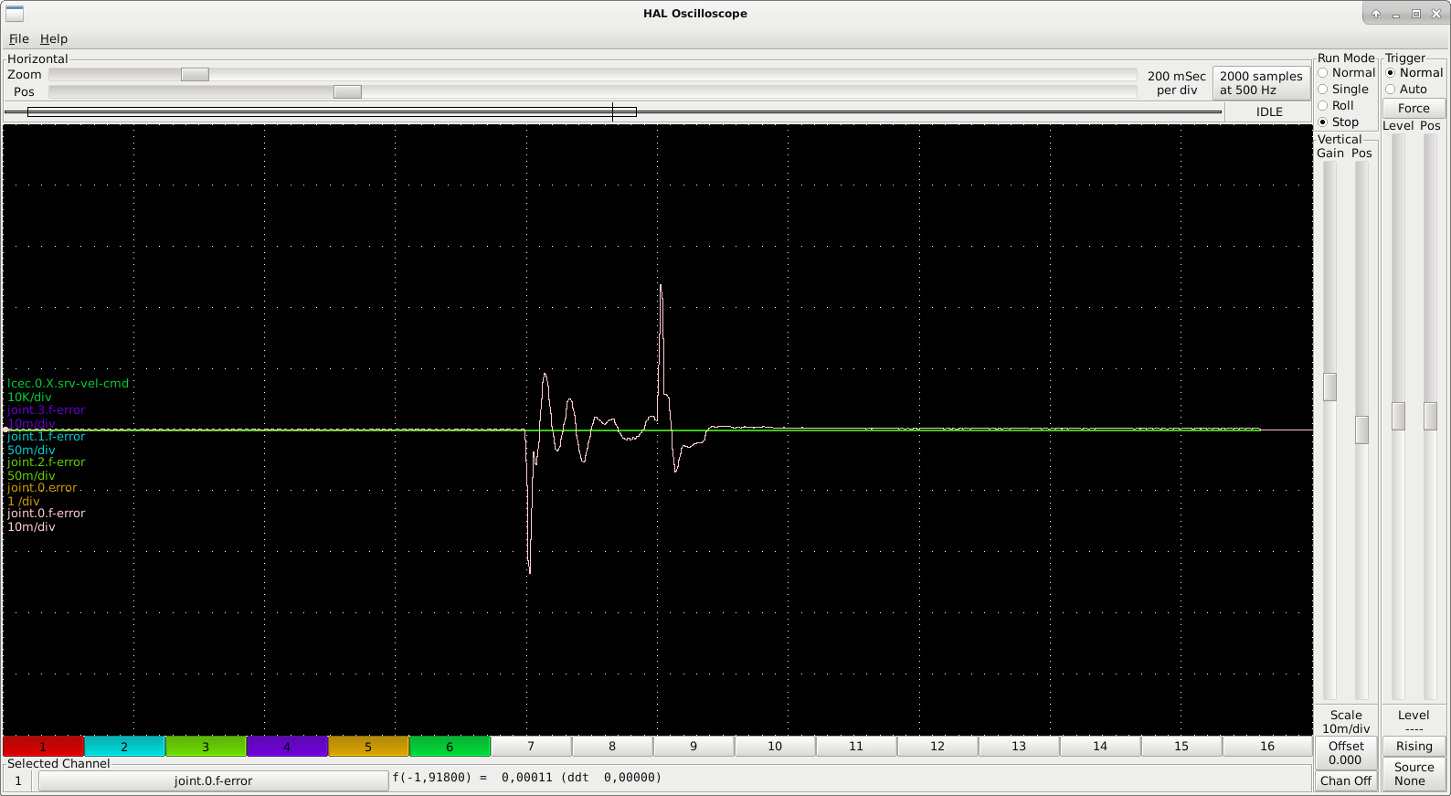

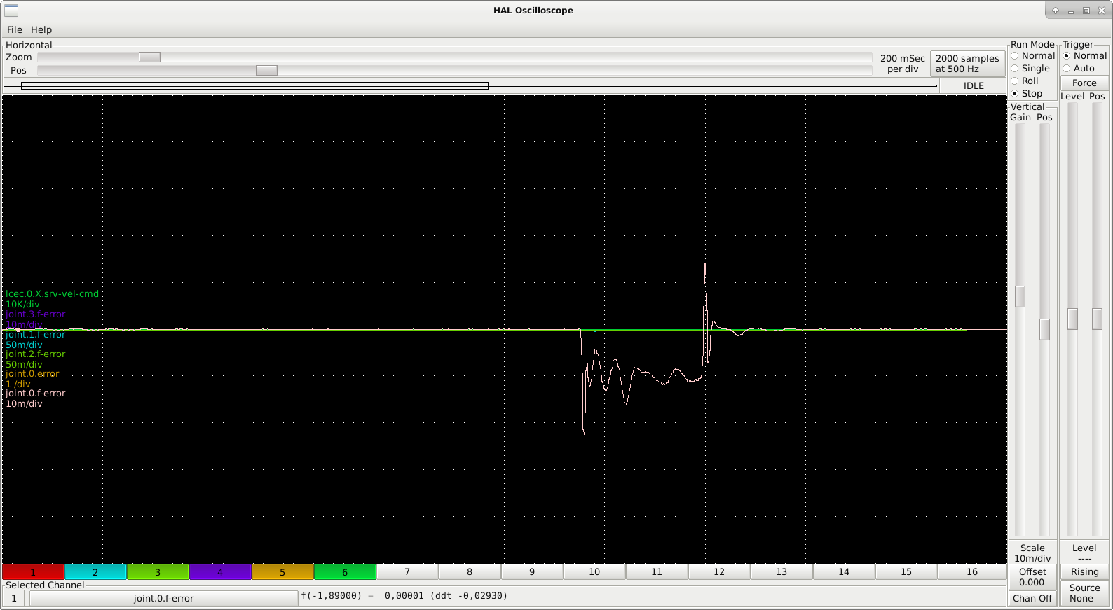

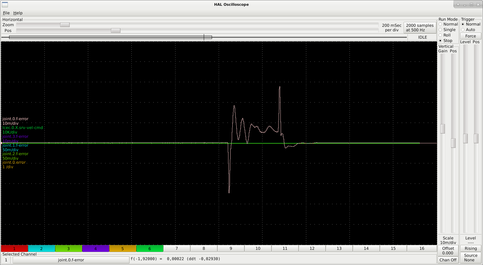

04 Jul 2020 20:51 #173628 by jirkam
The big bugs in this picture are thanks to .COMP where I had "950 0.020 -0.030" set. After adjusting to "950 0.020 0.020" it is no longer a problem.
