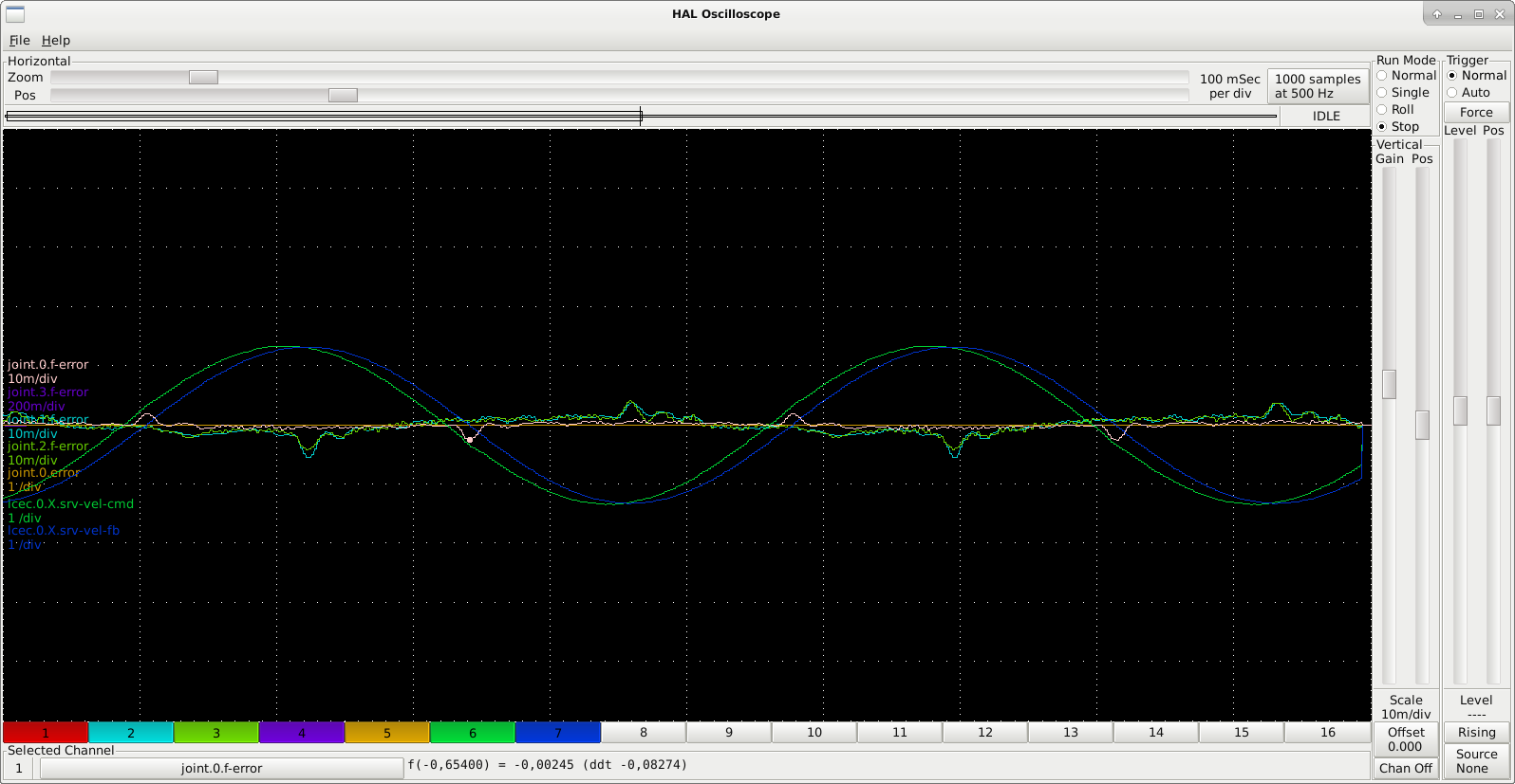

Is it even realistic to achieve a better result than 0.002 mm with Delta?
I discovered new facts.
But for the Y-axis (gantry), I found that both servos were arguing. At least I think according to the picture "2xY.png". It is at a manual crossing of 18000mm / min. The eye can see how the portal vibrates.
I don't know how to set it up to improve.
Due to inaccurate combs I have to use Y1.comp file and Y.comp file. And it will be more complicated.

What was the error in the oscilloscope?
I did the tests with new servos, the error was 0.0155, I have not adjusted the servos.
the truth is that I get better results with PID in linuxcnc at high speeds I think not,
it's very good!
Thank you so much for the ideas.

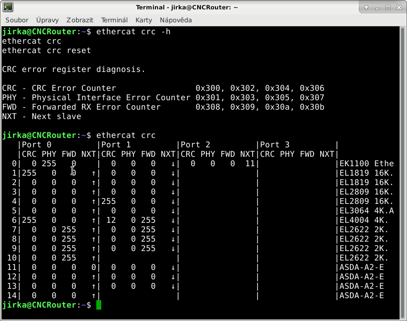

have you used it as
ethercat crc
while servos are in OP, working? If so, you have no problems with errors in frames, although you can still try to place the ASDAs first and then leave the inputs / outputs..

Yes, I tried "ethercat crc" when spiral milling.
Thanks so much for your time.

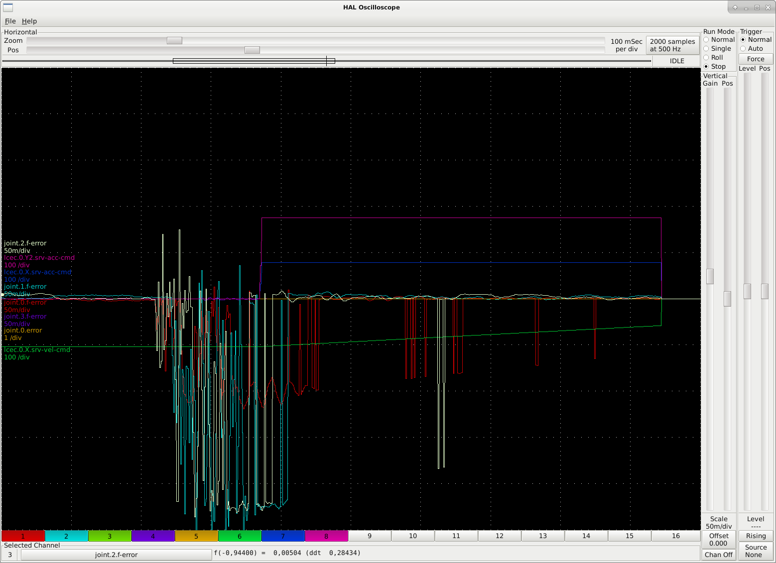

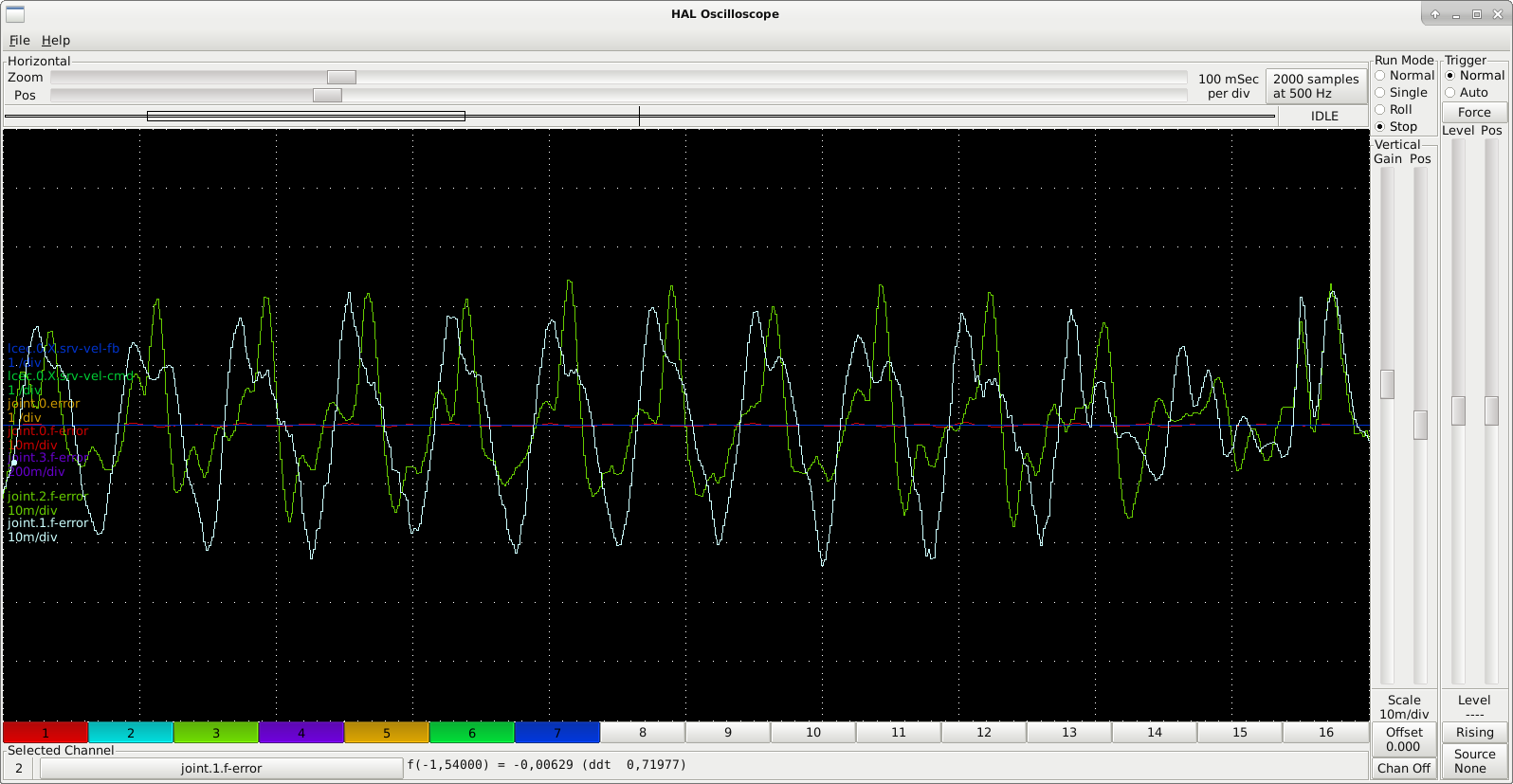

27 Mar 2021 17:21 #203852 by jirkam
Replied by jirkam on topic ASD-A2 EtherCAT on LinuxCNC
Good day.
I have fine-tuned the position control (thanks to a smarter colleague from the forum) and I can do it with an accuracy of a few thousandths. It is super.
But ... :-)
The video "
" shows how it goes without any problems.
It's not okay on the video "
". It starts to show such errors, which do not affect the milling in any way, but in about 30 seconds of the video it goes to a worse variant - it can be heard on the servos and sometimes it ends with an error.
I know it depends on what's coming from Lcnc. I may have managed to capture this in the image vrceni.png.
This is a situation where the servo growls - the sound is heard and can be seen on the graph.
I don't understand why it sometimes runs for two hours without a mistake, then it growls for two seconds and continues for an hour, ok.
Then there are days when it growls from morning then does not growl for a while.
Other times, after an hour of milling, it starts to growl and Linux bugs crash.
It does it differently in all three axes. It does not depend on the movement of two axes - it only goes in X, for example, and suddenly it starts to growl.
I found no dependence on anything.
Can't think of where the problem might be?
Thank you very much and have a nice day.
Jirka
28 Mar 2021 01:32 #203867 by chimeno
Replied by chimeno on topic ASD-A2 EtherCAT on LinuxCNC
Hello @jirkam,
I am very glad that it works perfectly for you, it may be that you have some kind of deviation in the synchronism on the clock of the ethercat bus, you can examine the time of lcec in hal using halcope, if this were the problem the solution would be to install the add-tasks -pll-functions-2.8.patch.
Greeting
Chimeno
