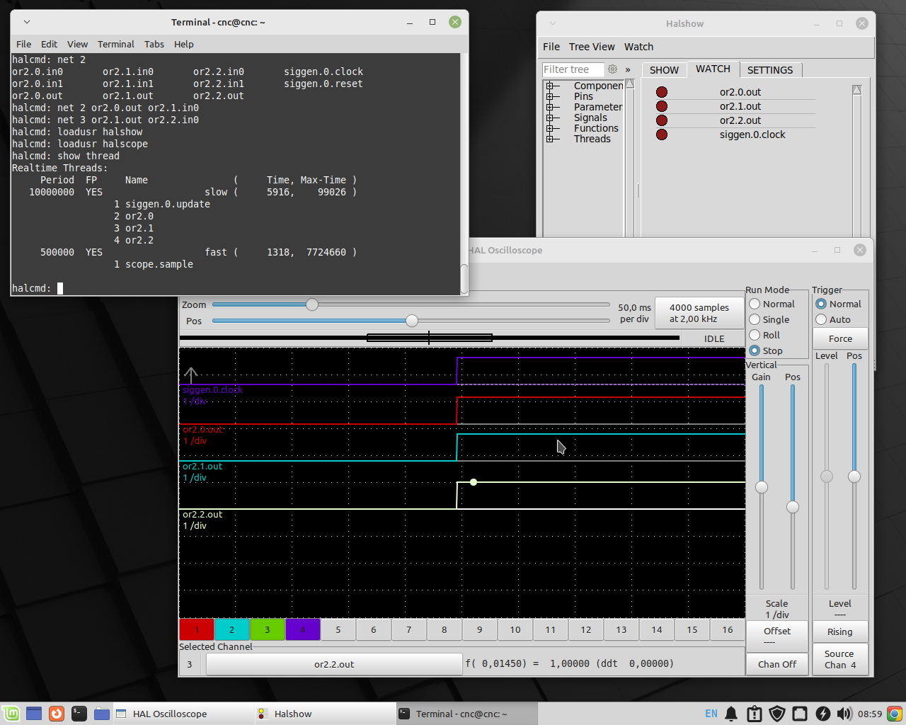

09 Dec 2022 02:36 - 09 Dec 2022 02:36 #258978
by fupeama
Replied by fupeama on topic ASD-A2 EtherCAT on LinuxCNC
Yes guys you are both right and i was wrong.
I made easy experiment.
load function or2 (three times) and connect
siggen.clock -> or2.0.in0
or2.0.out -> or2.1.in0
or2.1.out -> or2.2.in0
wrong order
addf or2.2
addf or2.1
addf or2.0
addf siggen.0.update
three cycles are needed to change the signal at the end of the chain
right order
addf or2.0
addf or2.1
addf or2.2
only one cycle is needed to change the signal at the end of the chain YOU CAN SEE THE TIME SEQUENCE FROM THE PICTURE
You can see the time sequence from pictures.
I apologize once again for the mystification
Martin
wrong order
addf or2.2
addf or2.1
addf or2.0
right order
addf or2.0
addf or2.1
addf or2.2
Martin
Last edit: 09 Dec 2022 02:36 by fupeama.
