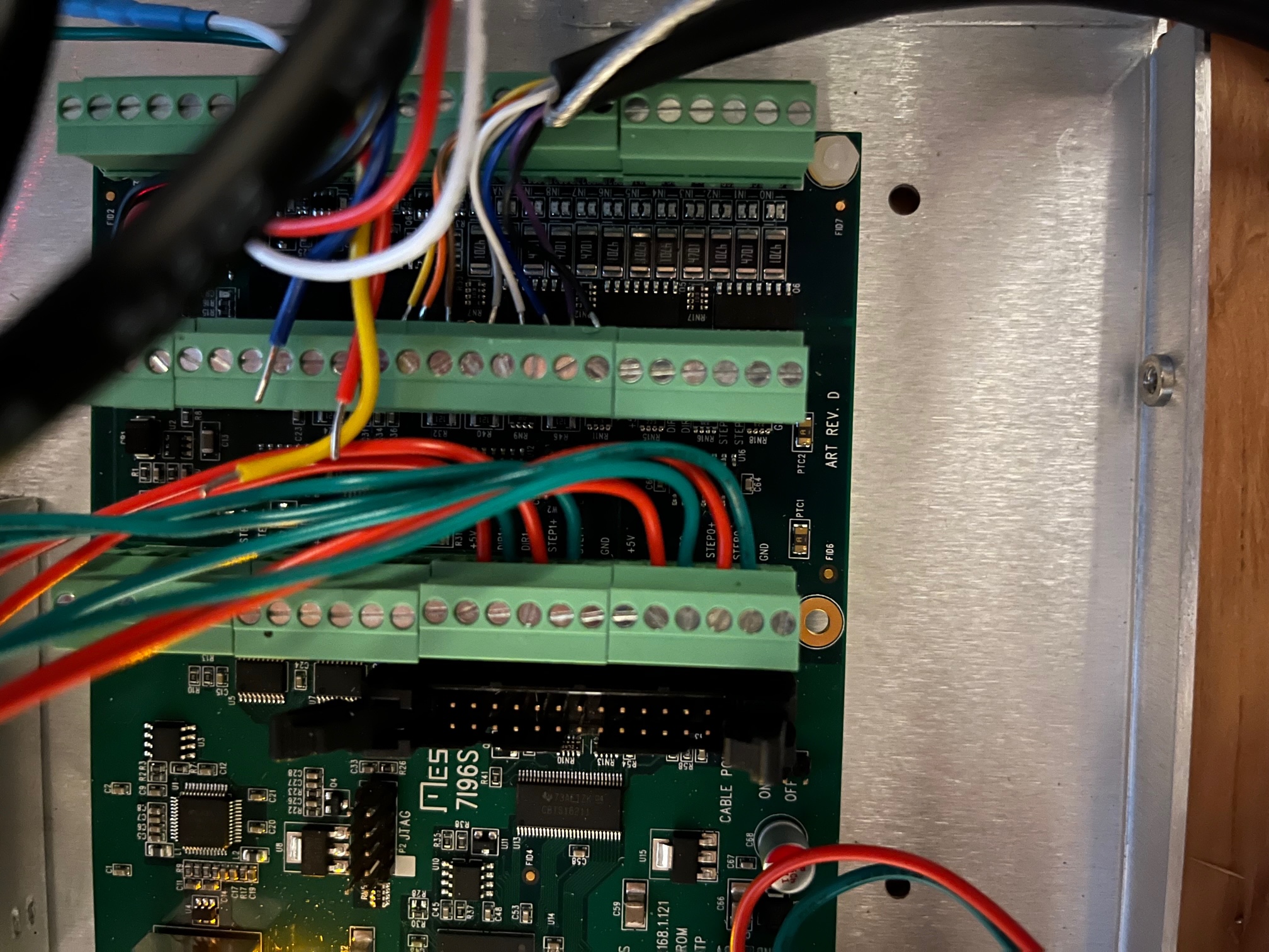

The should be left open for single ended level signals@PCW: What is the correct way to connect single ended encoders? Should the A- B- and I- terminal on the mesa card be left floating or grounded? (Or it doesnt matter as long as the jumpers are set correctly)

The very best would be for you to provide an exact diagram of the connection between the encoder, the mesa card and the pow supplies.
I think you are mixing ground with earth ground...
Ground (GND) often identify the negative side of the power supply. This can also be named common, V- or in your case -ve for the encoder. You will then connect the ground of the encoder to the -ve of the power supply AND also to the GND of the encoders on the mesa card. For the 7i96s this is pin 9 (or 15) of TB2. The ground should NOT be connected to the shield or earth ground.
Earth ground is often identified by the (earth ground) symbol below:
Earth ground is usually connected to the chassis/frame and also ONE (and only one) side of the shield of a cable. It should NOT be connected to the ground (as defined above). The exterior of the db9 connector (shell) should be connected to earth ground, but NEVER to the ground, same for the shield of any cable. What you wrote before suggest that this is what is happening.

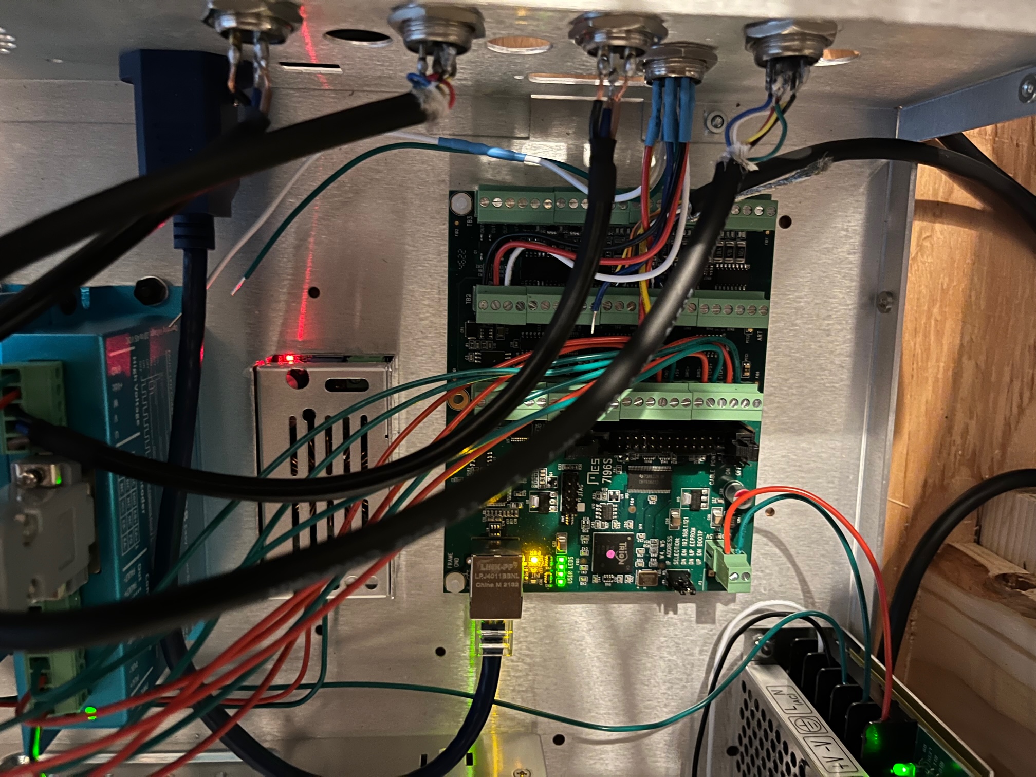

A 48VDC and 7.3A power supply output is inlet a voltage regulator and pot adjusted to approximately 13VDC output. The voltage regulator 13VDC and Ground connect to a circular connector with matching terminals to a cable. The other end of the cable has a DB9 and the Ground is soldered to the exterior DB9. The Masso Optical Encoder came with a provided cable and Ground already soldered similarly. The ground pigtail could be used optionally but didn't seem necessary to receive the encoder's high and low voltage.

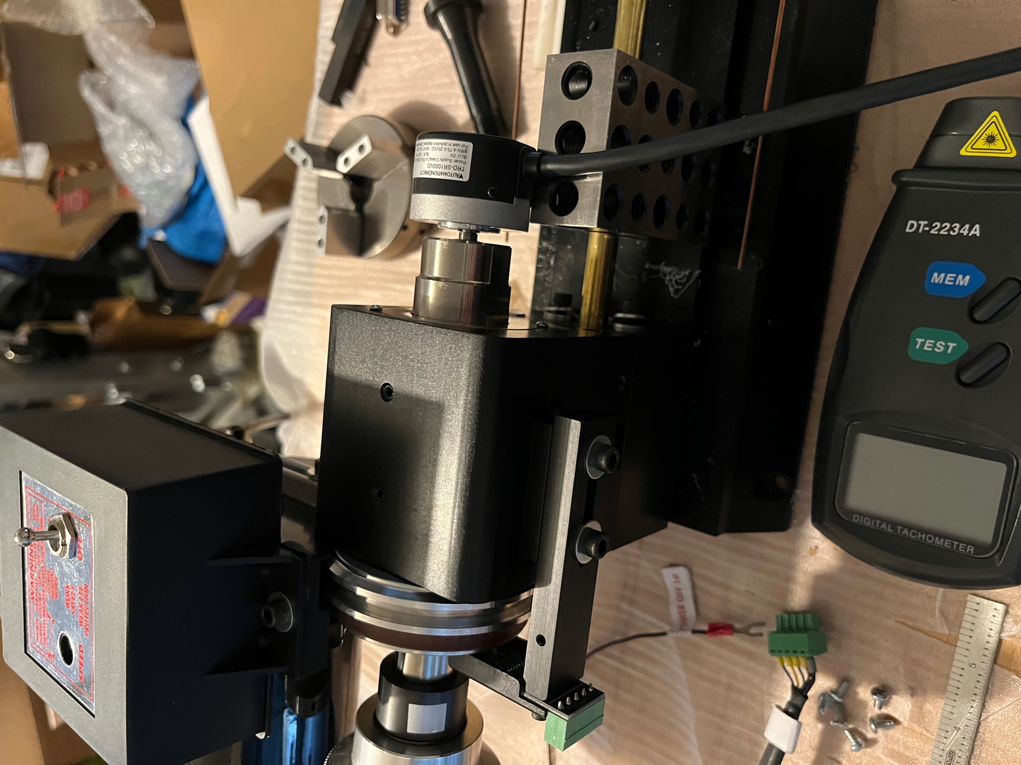

Manually rotating TRD-SR1000VD encoder shaft high and low signals.
VDC digital multi-meter readings from 7i96s encoder terminal block.

Temporarily, I connected the TRD-SR1000VD encoder wires immediately to the 7i96s encoder terminal block including differential signals to configure and test the encoder until I made a new cable and connectors. The present cable connected to the control box is from a previous Masso encoder that uses TTL signals and is only used now during testing and for P1, P2 and P3 speed controller. The 7i96s, W1, W2 and W3 jumpers are moved to the right. Meanwhile, the encoder shaft is placed in the mini CNC lathe collet chuck before mounting on a bracket for consistent shaft rotation and initial testing.

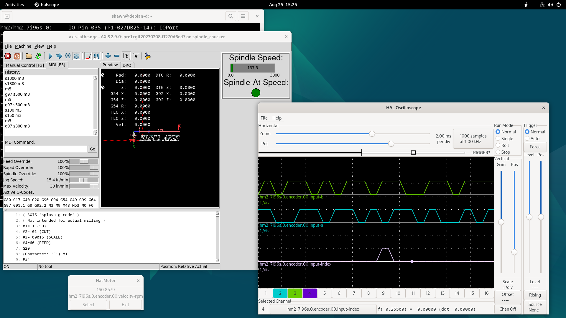

The TRD-SR1000VD encoder is 1000 PPR and radial. Unsure if magnetic but generally radial is magnetic. The encoder at steady rotation the PyVCP and Hal Meter RPM are fairly accurate readings with the portable tachometer but the commanded RPM isn't and considerably partially due to the pulley ratio. Is the PncConfig Wizard not calculating the max spindle and pulley ratio and PWM of 10V to the commanded RPM? The PyVCP and Hal Meter RPM are twitchy at a tenths and ten-thousandths decimal places during rotation but when no rotation both RPMs remain at a stable 0. Could the RPM be rounded to the nearest whole number to prevent twitching? The encoder at steady RPM and the Hal Scope , A and B channels aren't quite 90 degrees out. Should and can the signals be nearer 90 degrees out and more square at low to medium RPM with this encoder and how?

Is another oscilloscope suggestible, free software and Linux download to recheck the encoder signals without probing the terminals?

As long as the encoder has valid quadrature so counts correctly
I would not worry about it.
You can filter the displayed RPM to eliminate most flicker
