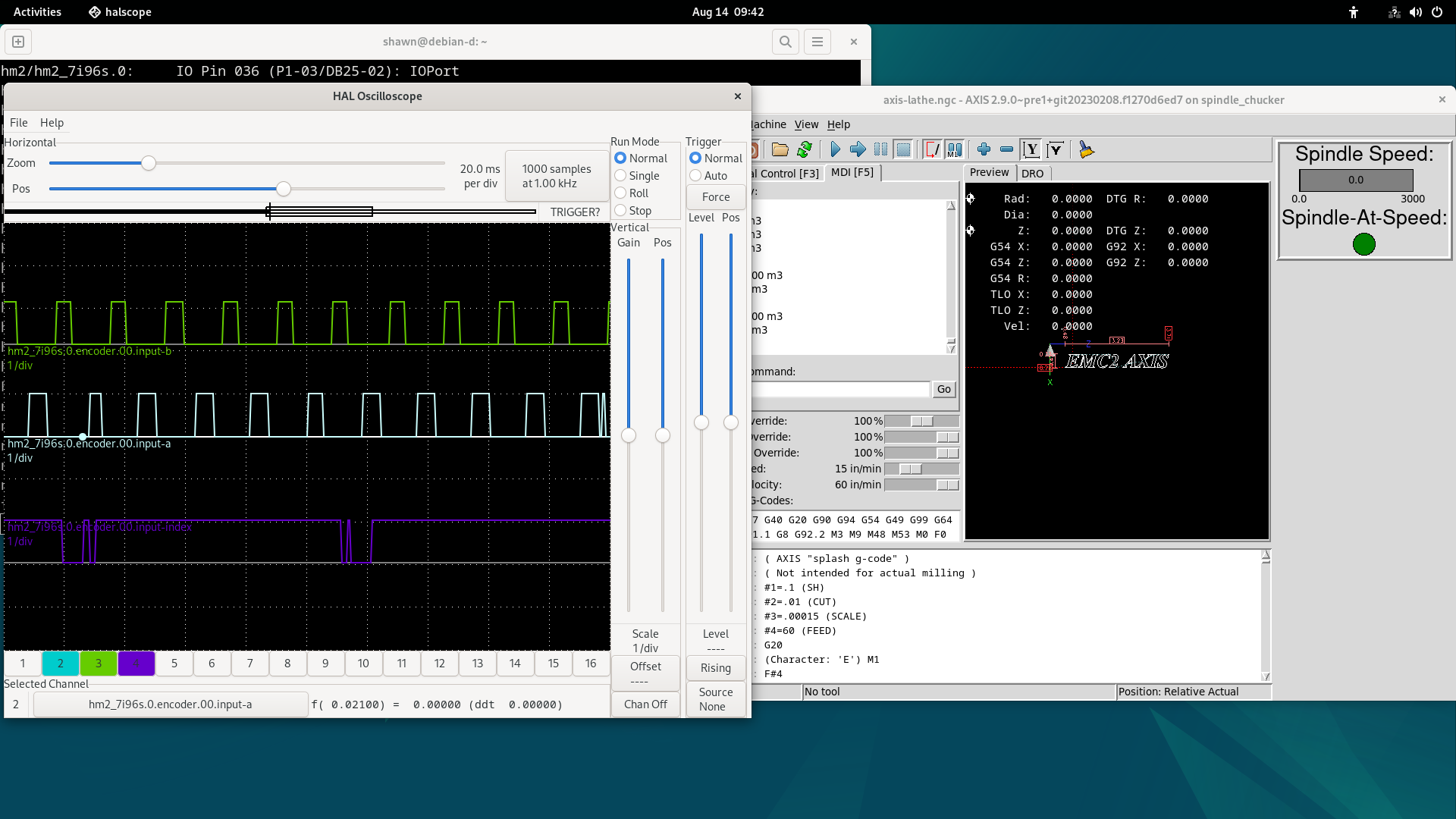

Then, I'd suppose either the black or white squares are lines similar to a slit on a code wheel. I can try reconfiguring 5 LPR and 20 CPR. The encoder should work well enough because Sherline uses it with their Chucker Lathes, however, nowadays they might use Masso's CNC more often. I like LinuxCNC for the parametric programming and unallocated g-code and I program both.
Last edit: 14 Aug 2023 11:49 by smplc. Reason: 20

I set Encoder lines per revolution 5 at Spindle Motor and Spindle Scale Calculation of the PncConfig Wizard. MDI, g97 s1000 m3 and portable tachometer read 665 RPM. The Hal Scope of channels A and B don't appear to improve much. The GUI RPM still shuffles.
Last edit: 14 Aug 2023 11:59 by smplc. Reason: Shuffle.

The A/B signals are not affected by any scaling, these are simply representations
of the input signals.

Does A/B or Z adjust the RPM? Are the Encoder lines per revolution 5 correct? I have BobCAD/CAM, an inkjet printer and some blank shipping labels that are designed to cover other shipping labels. I could draft a new black-and-white code wheel. How about 80 or 64 black-and-white lines per revolution? I can draft an additional inset (offset) line for the Z channel too. Would that improve the A and B channels 90 degrees out? Would the analog signal be any squarer?

If in quadrature mode, both A and B determine the velocity (RPM) value
You cannot change the pitch (PPR) without changing the wheel diameter
because the A/B detectors have a fixed distance on the encoder detector
module to generate the 90 degree phase difference.
What is the diameter of you current wheel?

Approximately 2.500". The Mesa Card 0, TB1/TB2 and pin Spindle signal PWM Gen-P (pg. 2 earlier in string). That probably enables the spindle to be programmed. Should I maintain Encoder lines per revolution 5 meantime using the present encoder and code wheel?

AGAIN, the 5 ppr encoder wheel will ONLY work if the diameter is BETWEEN 1.75 and 2.00 inches !!!
here: forum.linuxcnc.org/49-basic-configuratio...oder?start=40#277942
I you are ignoring this fact this will NOT work. PERIOD.
For some reason the wheel you have is just wrong (if it is indeed more than 2.0 inches diameter.)
If you want to do it right just go there: docs.masso.com.au/wiring-and-setup/setup...asso-optical-encoder
Click "generate encoder disk"
Enter the EXACT parameter
Print and attach to your spindle.
First thing you will notice is that there will be more pulses (black/white), 6 or 7 according to the EXACT diameter

Thanks. The A and B LED's of the encoder card appear to coincide at about a 1.07 radius (2.140 dia.). Is expected the LED's within a diameter 1.75 to 2.00?

I just specified the Masso encoder wheel to 2.5 OD and 0.875 ID printed and appears the 2.140 diameter is slightly under the center line of the wheel encoder ring. I'll give that a try.

I'm pretty sure that the diameter you need to enter in the 'generator' should be the same as the diameter of the surface where it is attached. This is pretty much the same diameter as the wheel you've got with the kit from sherline.(shown on the picture you've uploaded earlier)
Do not deduct for the position of the leds or the sensors since the wheel itself should go past those. If the wheel is too small the sensors will only see the edge of the wheel. Correct position is when the sensor are about in the middle of the printed black/white trail. .
