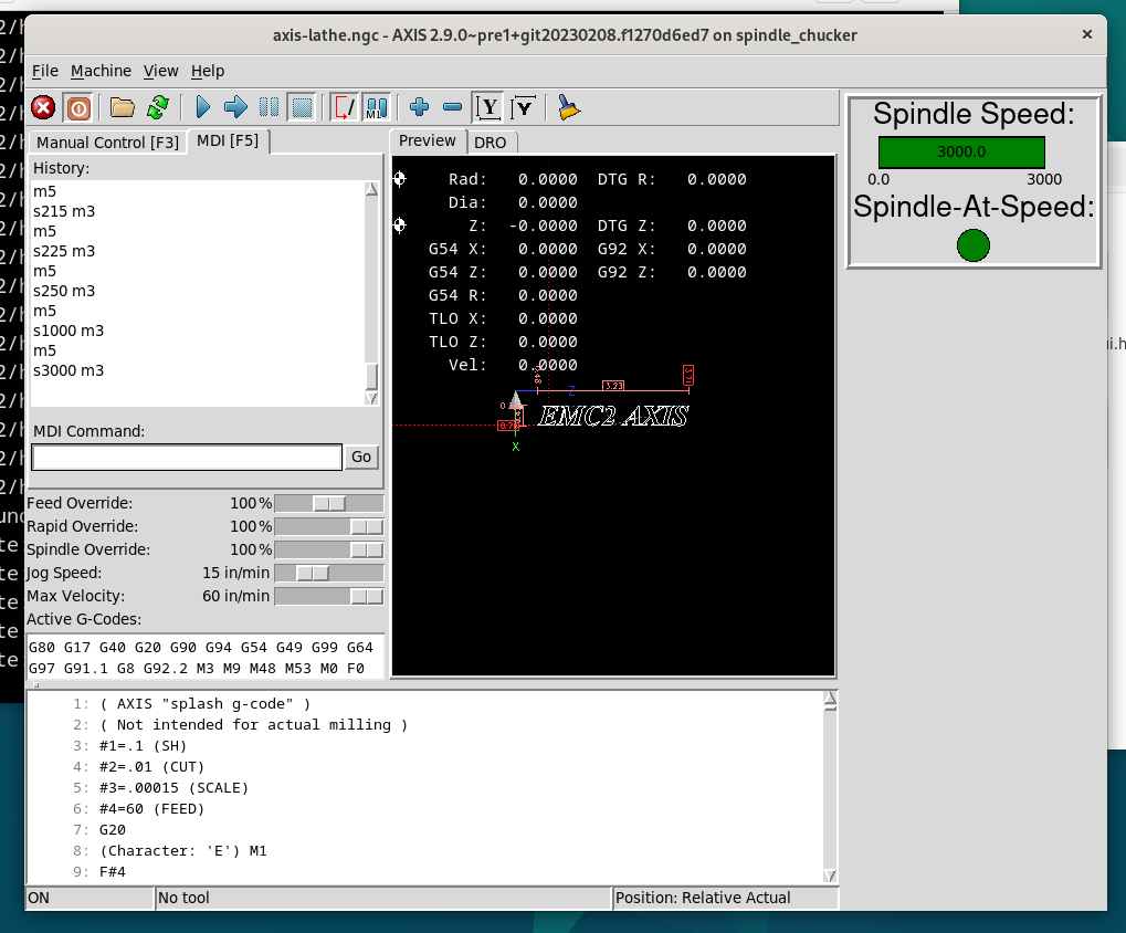

MDI, G97 S250 M3 but tachometer 23 RPM.
MDI, G97 S1000 M3 but tachometer 370 RPM, Spindle+ & Spindle Out 2.4VDC, and Spindle+ & Spindle- 2.85VDC.
A+ 3.3VDC, B+ 3.3VDC & Z+ 6.4VDC.
MDI, G97 S3000 M3 but tachometer 2312 RPM.
MDI, G97 S250 M3 is about the lowest commanded RPM the control accepts yet to rotate the spindle.

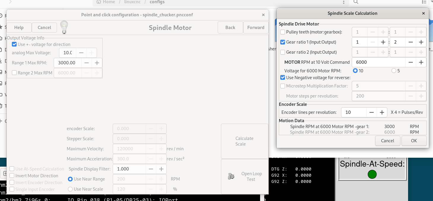

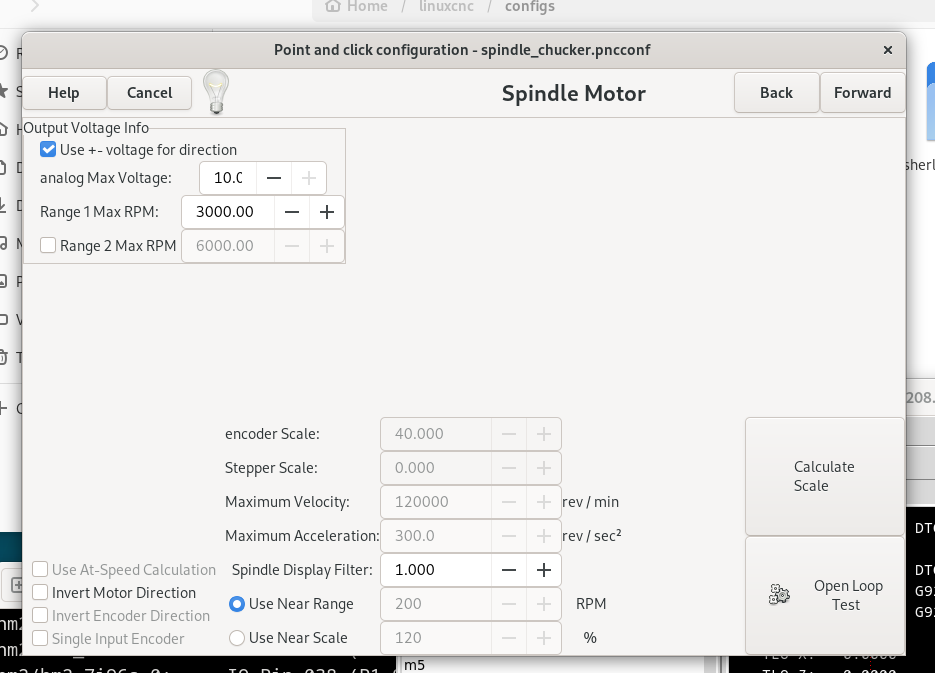

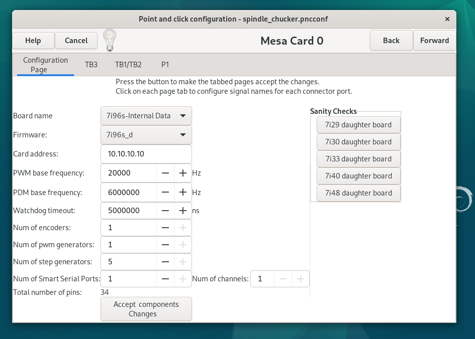

PncConf Wizard
Meso Card 0
7i96s
7i96s_d
I set 'Num of channel 3' and tried 'Accept component changes' but 'Num of channel' defaults to 1. Should it be 3 channels if the encoder is A, B and Z?
Does the Spindle Motor page not have enough specifications to calibrate the spindle motor and encoder, positioning and or indexing, constant surface feet and accurate RPM and GUI feedback?

Are 12.2.2 and 12.2.6.1 configurations required in addition to the .hal file the PncConf generated and to calibrate the spindle motor and encoder, positioning and or indexing, constant surface feet and accurate RPM and GUI feedback? Do any PINs need to be edited to match the 7i96s? Does PWM Spindle Speed and Spindle Synchronized Motion get inserted at the top of the .hal page underneath the other loadrt? Do any additional specifications need to be inserted in the .ini file to configure the spindle?

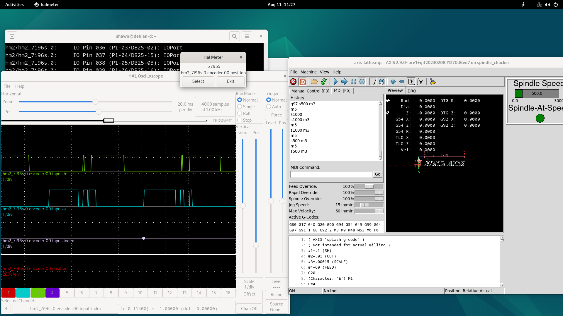

Does the encoder work? That is, does the spindle position increase
or decrease by 1 each turn of the spindle?

Yes, the encoder works as much to my awareness. The encoder inputs signals to the 7i96s, EncA+ 3.3VDC, EncB+ 3.3VDC and IDX+ 6.4VDC. The encoder A, B, and Z LED's are blinking every line count. Does LinuxCNC have a file and where that'd show the encoder line counts when rotating the spindle?
- Posts: 18118
- Thank you received: 5336
10 Aug 2023 17:05 #277575
Replied by PCW on topic Spindle and encoder
Yes you would look at:
hm2_7i96s.0.encoder.00.position
with either halshow or halmeter
You can launch either from Axis's "Machine" pull down menu
(you launch halshow with "Show Hal Configuration")

The halmeter hm2_7i96s.0.encoder.00.input-index alternates True/False. The halmeter hm2_7i96s.0.encoder.00.position twitches less or greater some manual rotations (graduations) but gradually the greater and some other manual rotations just increase 1. How is the spindle configuration file updated? Should the 12.2.2 PWM Spindle Speed and the 12.2.6.1 Spindle Synchronized Motion be used? I'd like the programmable spindle accurate about a few RPM read with a tachometer.
