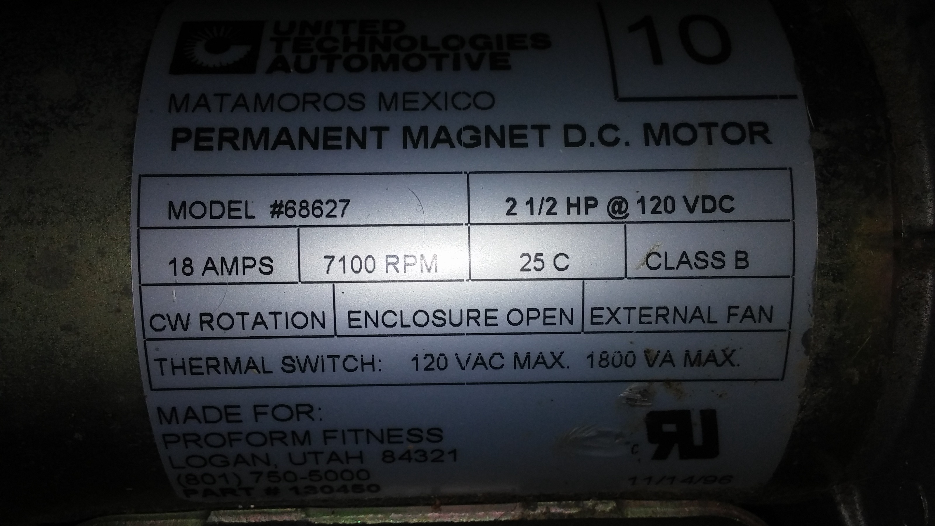

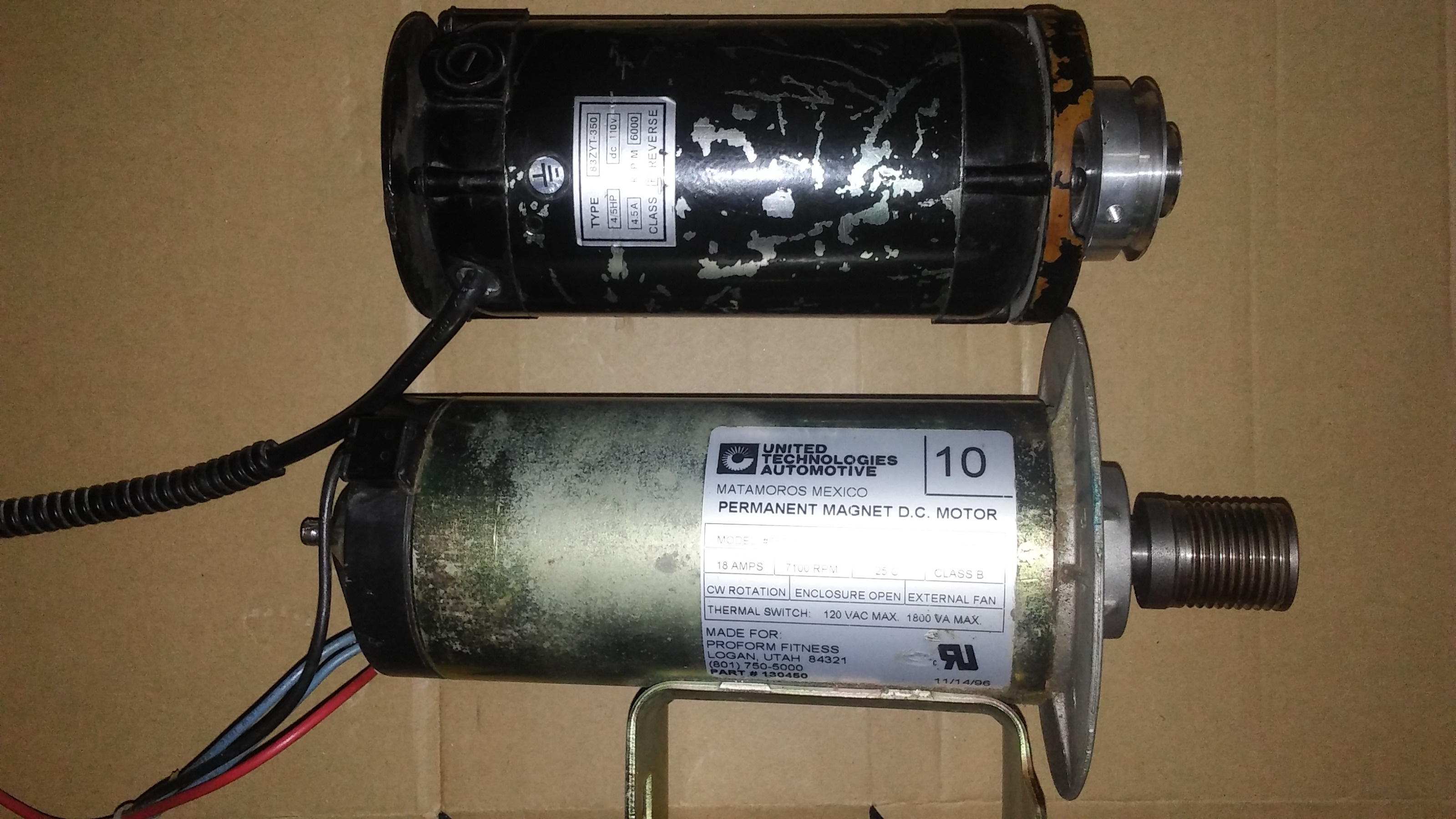

long story short i pushed my spindle to hard one to many times and killed the driver board i think. which in turn got the wheels turning and is usually where i dive down a rabbit hole and come up with a half baked idea
Youtube is great for this
seen some people doing some interesting stuff with treadmill motors and the MC-60 drives. it started off with the knife guys making belt sanders from them and then lead me to find some guys using them on mini mills which is basically what i have on a gantry machine. i just happen to have a treadmill pushed in the corner doing nothing so i tore into it to see what kind of goodies i could find inside
what i found was the MC-60 speed control board and a 2.5 hp DC motor only problem is this thing is old and the manufacture is not around anymore as far as i can tell? i was trying to figure out how much torque this motor has? taking the info from the ID tag i'm guess it is rated at somewhere around 2.5 Nm ? does this sound about right ? and the original mini mill motor i was putting at about .9 Nm
looking at a way to drive things i can reduce the speed to about 4000 rpm from 7100 rpm or do 5500 from 7100 rpm if this thing is big enough to do away with the high and low range. i would like to do a 1 to 1 ratio and get the full 7100 rpm but i doubt i would have much luck in the torque department in slow speeds?

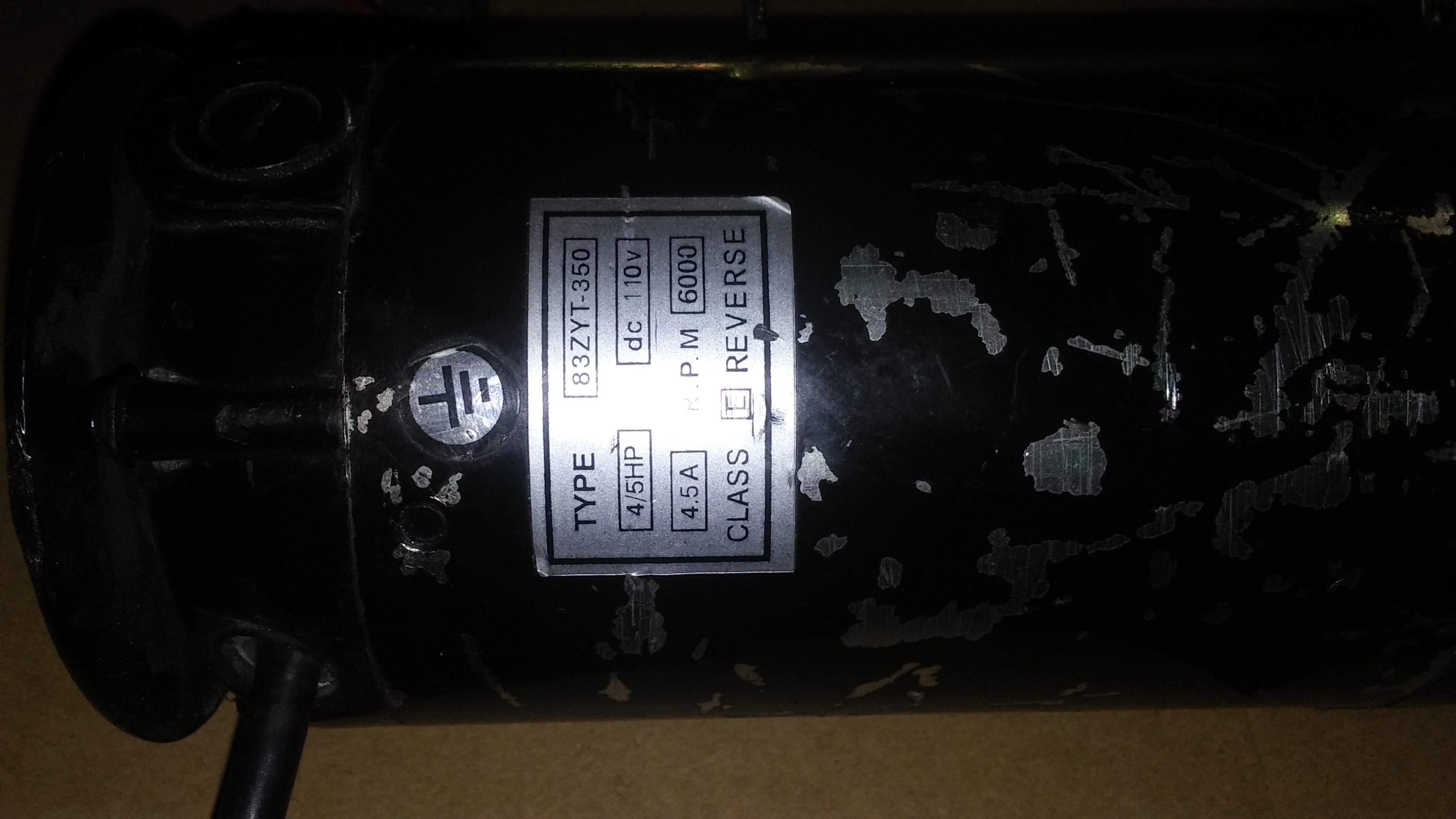

it was interesting to see the two motors side by side since they are close to the same size but as you can see the specs are quite different

20 Mar 2021 00:49 #202920
Replied by andypugh on topic Random stuff, reduction, servo motors, ideas and thoughts
If you play around with FSWizard (or some other online feeds and speeds calculator) yiou can often get a value for the torque required.
Play around with cutter sizes and materials to figure out if the motor could drive directly.

20 Mar 2021 09:06 #202949
by machinedude
Replied by machinedude on topic Random stuff, reduction, servo motors, ideas and thoughts
i was looking at things trying to come up with a starting point that was not to involved to start with. i have a motor pulley that can be bored out to fit the bigger motor but the original low range gets cut away doing this since the mini mill motor has a 9mm shaft and the treadmill motor has a 17mm shaft. if i go by what that is rated for it's still a step up from the original 4200 rpm to 5300 rpm,
i did not even think about direct drive so i will look at that option so thanks for the input. i'm not sure if i can do it or not though since the flange at the base is so big on this treadmill motor.
any kind of spindle speed gain would be a huge bonus even an extra 1100 make a big difference in material removal rates.
if things work well at 5300 then your idea would be he next step.

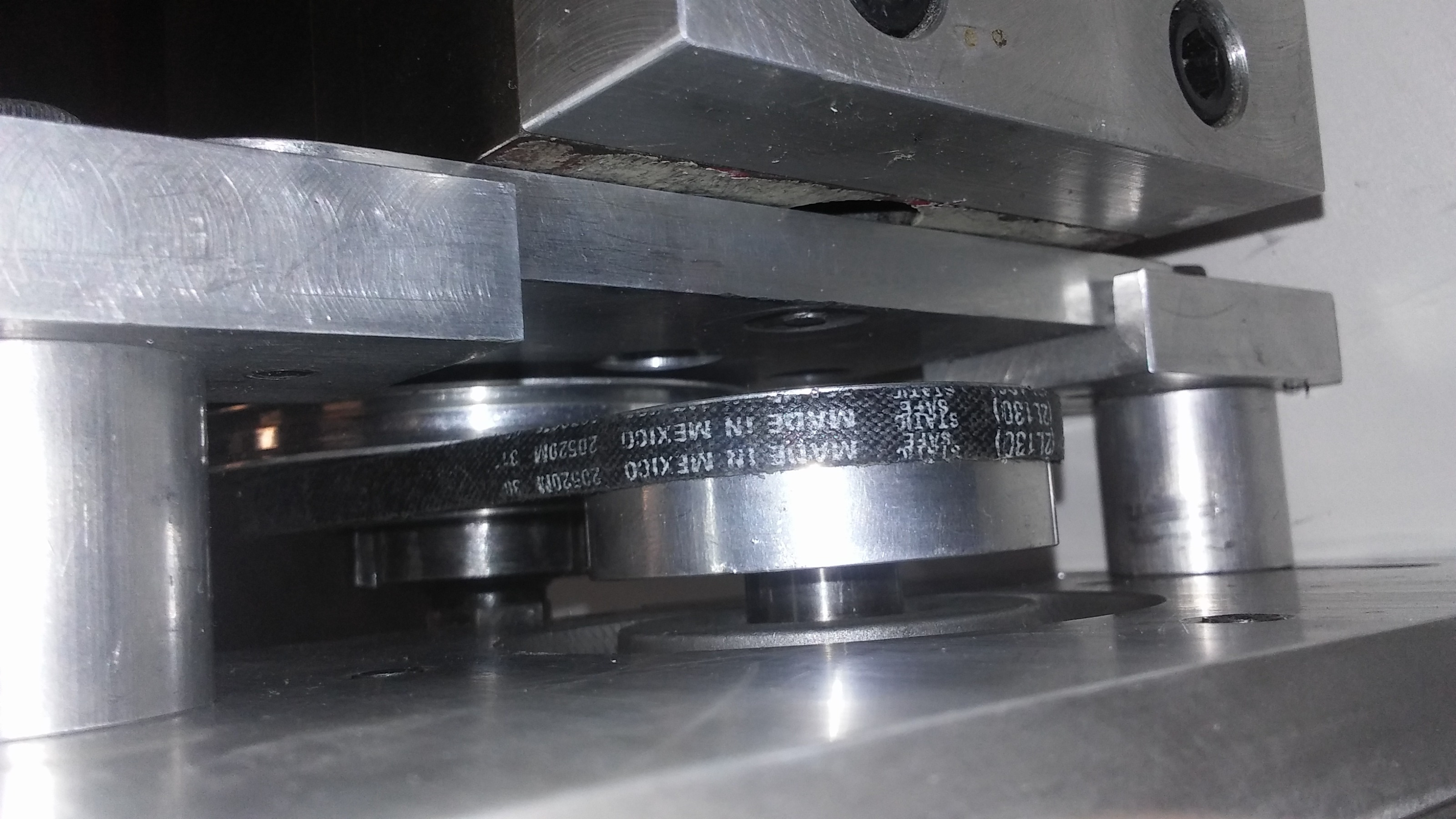

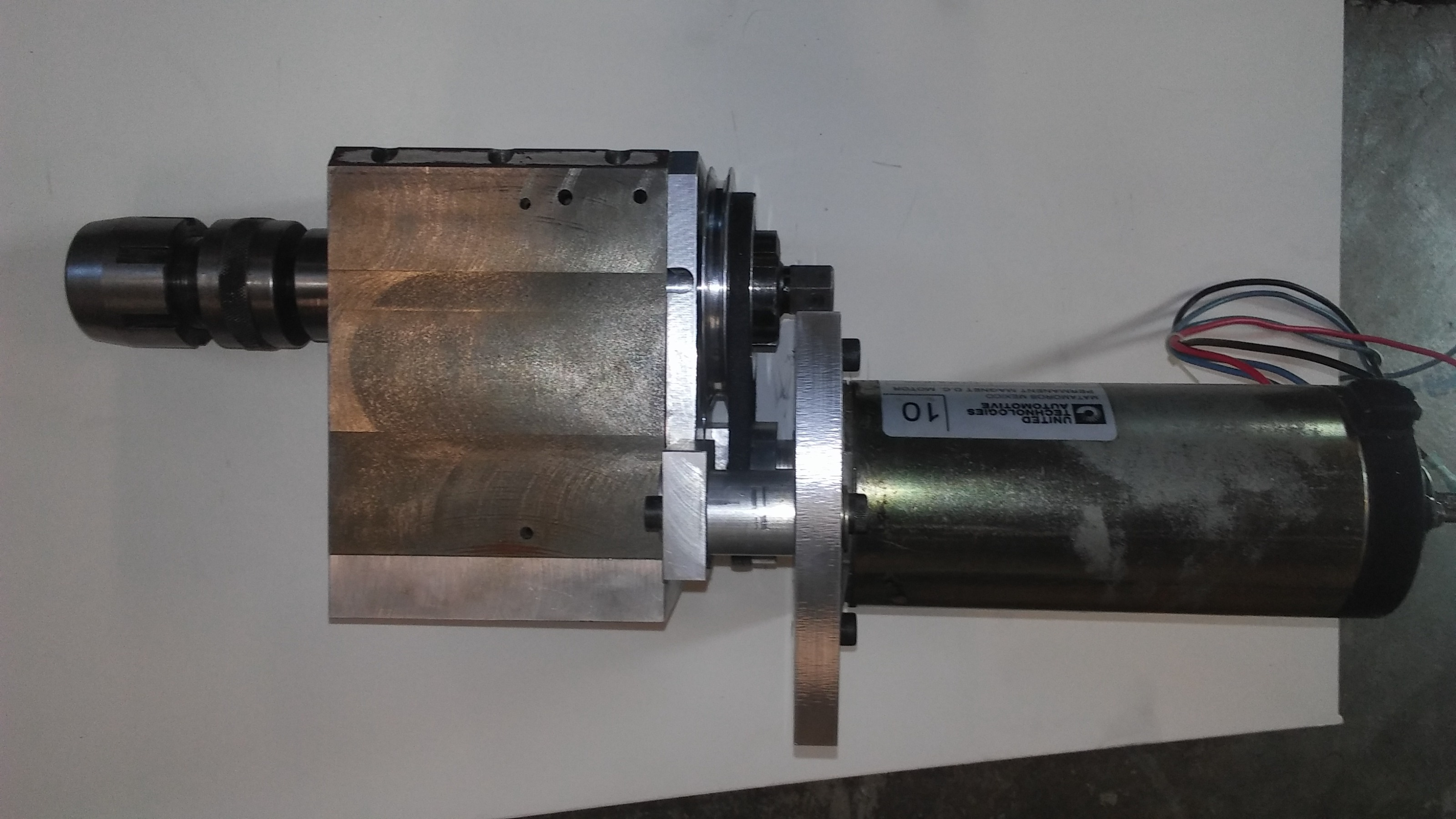

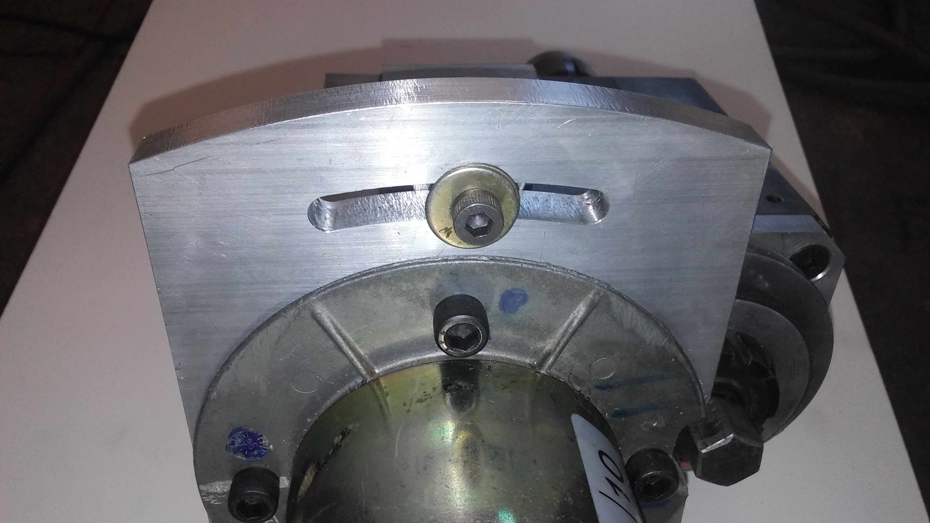

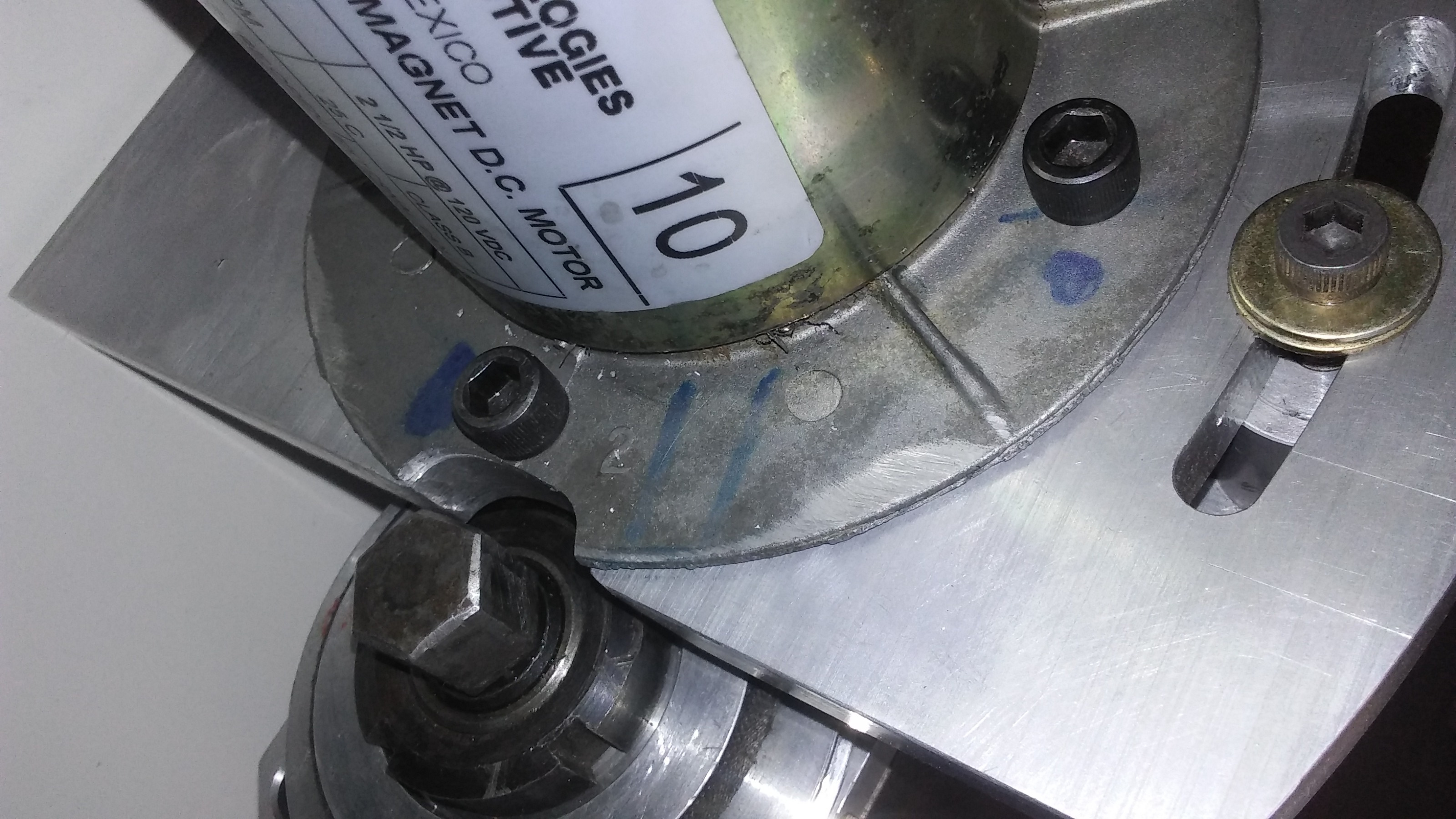

had some rethinking to work out but this is what i ended up with in the end. the drawbar was an issue because this motor has a big flange at the base so i had to cut some clearance for the drawbar with a burr tool by hand. the entire motor mount plate had to be remade and the bottom plate had to have some extra stock added for some mounting point for the swing on the belt tension radial grove. took a while to make since i had to do things old school with a rotary table on the Bridgeport mill. everything works well so i an happy with it as is.
so if this new motor has enough torque on the bottom end it will be a single pulley set up rather than the step pulley like the original and should top out at around 5,300 RPM. should be a safe starting point to play around with i hope
so on with the pictures that's what everyone likes anyways

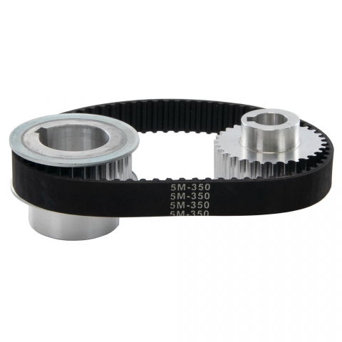

i did happen to come across this high speed drive kit for a different mini mill than the one i modified it could very well work if the bores are the same? i will have to look into it some more and see if it could work? what i have now will work for now but the timing belt drive seems to be a better choice i think for power transmission. this particular kit is a 1:1 ratio so that would loose some torque but take the spindle speed up to 7,100 rpm. i did look into what kind of bearings this head has and it has the 6206 bearings so that's a plus most of them seem to fall in the 10,000 to 12,000 rpm range and the worst one i could find was 7,500 rpm. the higher end brands were rated as high as 25,000 rpm so there is room to work with in that department.
figured i would post a picture of the drive system i was thinking so see if anyone had any feedback.
- arvidb
- Posts: 459
- Thank you received: 158
26 Mar 2021 12:13 #203699
by arvidb
7100 rev/min ≈ 743.5 radians/s
1.86 [kW]/743.5 [radians/s] ≈ 2.0 Nm - so 2.5 Nm was a good guess!
The power on the nameplate is probably electrical (input) power, so you need to reduce the torque accordingly. If the motor is 90 % efficient then 1.8 Nm.
Replied by arvidb on topic Random stuff, reduction, servo motors, ideas and thoughts
2.5 hp ≈ 1.86 kWwhat i found was the MC-60 speed control board and a 2.5 hp DC motor only problem is this thing is old and the manufacture is not around anymore as far as i can tell? i was trying to figure out how much torque this motor has? taking the info from the ID tag i'm guess it is rated at somewhere around 2.5 Nm ? does this sound about right ?

27 Mar 2021 05:00 #203773
by machinedude
then that's pretty good for the type of machine it is. deflection will probably be an issue before running out of power at the spindle becomes an issue. i will get to play around with it this weekend since the rotary pot came today so it's just a matter of putting things back together and finishing the wiring which is not to involved at this point. i know the real test is going to be at slower speeds. the old motor was not very good on the low range so running faster worked but was hard on carbide inserts. got my fingers crossed and hoping it makes me giggle just a little bit
