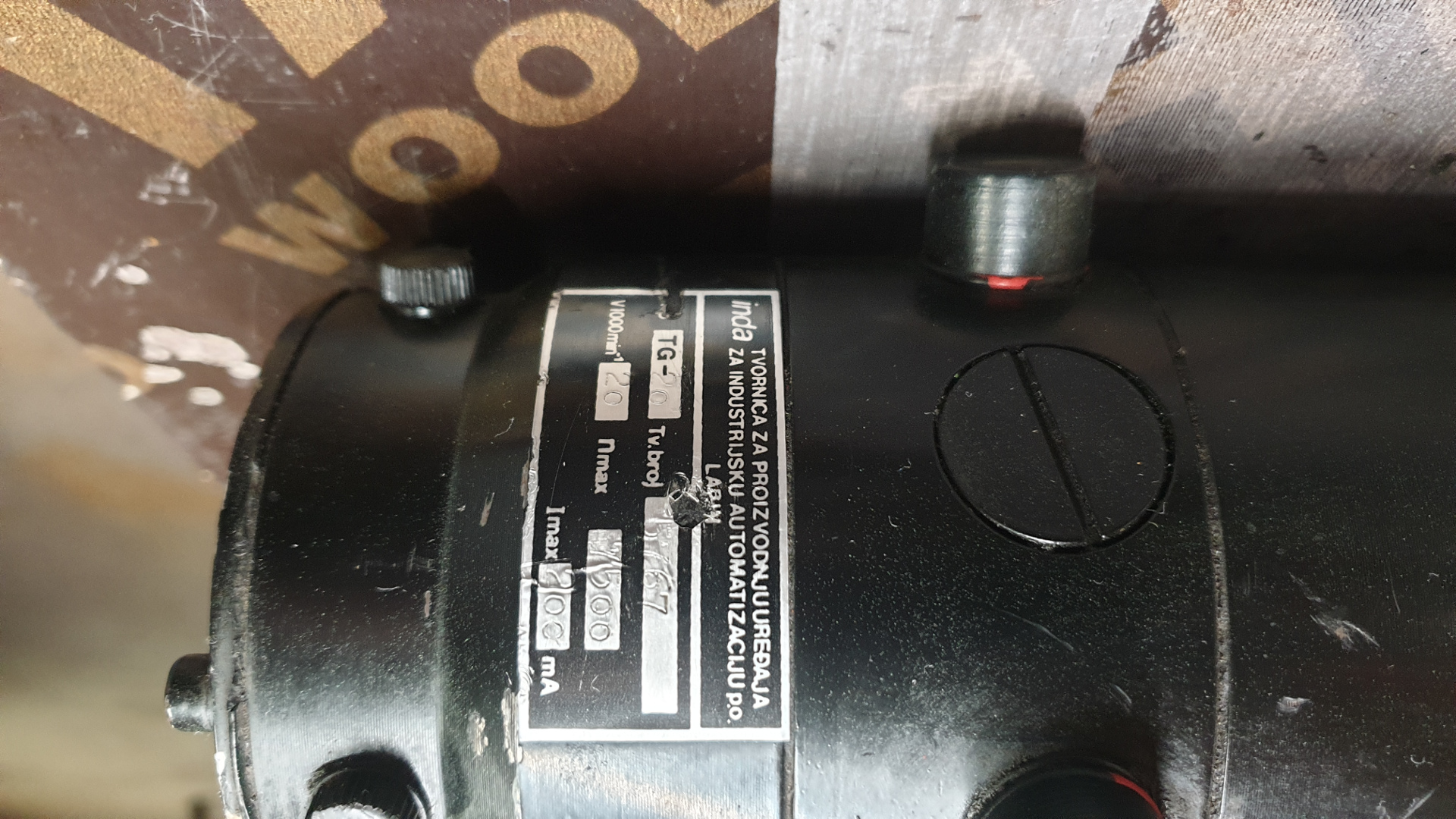

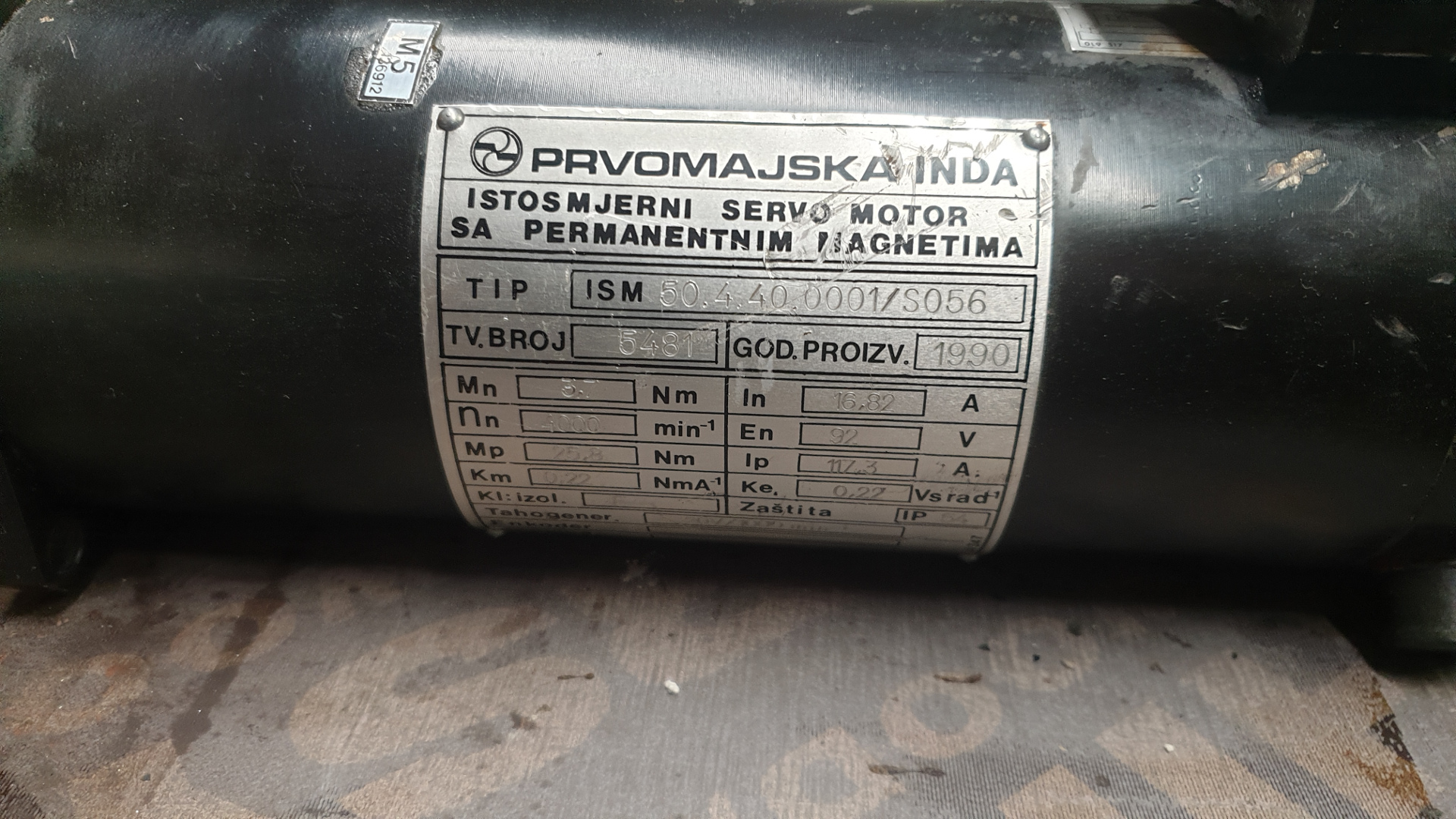

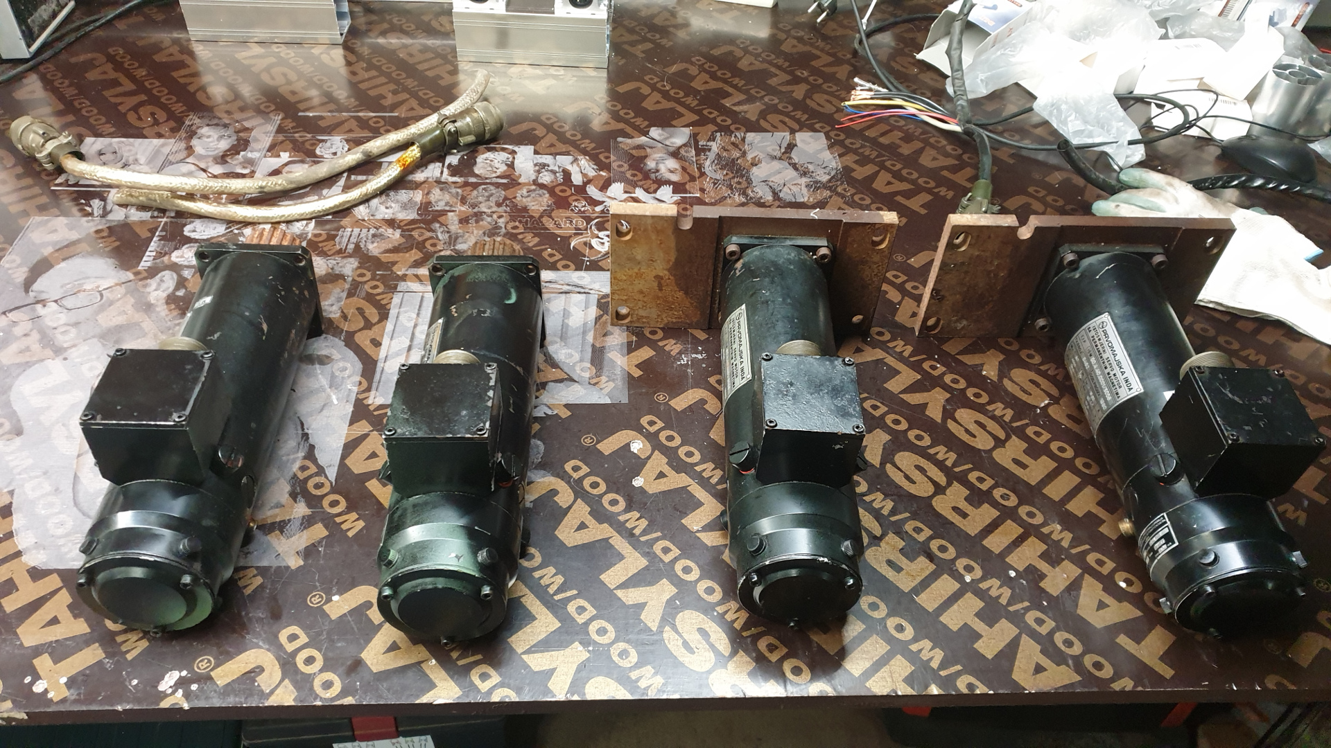

Use this as random everything, so to start here are some pictures of 4 servo motors i bought used for 120 Euros a while back, they seem to be 1.5KW, 4000RPM, 3.7MN and 25.8MN peak, they have tachos but no encoders and there is no easy way to mount them.
Spec:

I have another 4 much bigger from the same machine/manufacturer on hold at 50$ a piece that i will collect after this "V mess", they should be at least 2.5KW or more, they are to damn heavy.

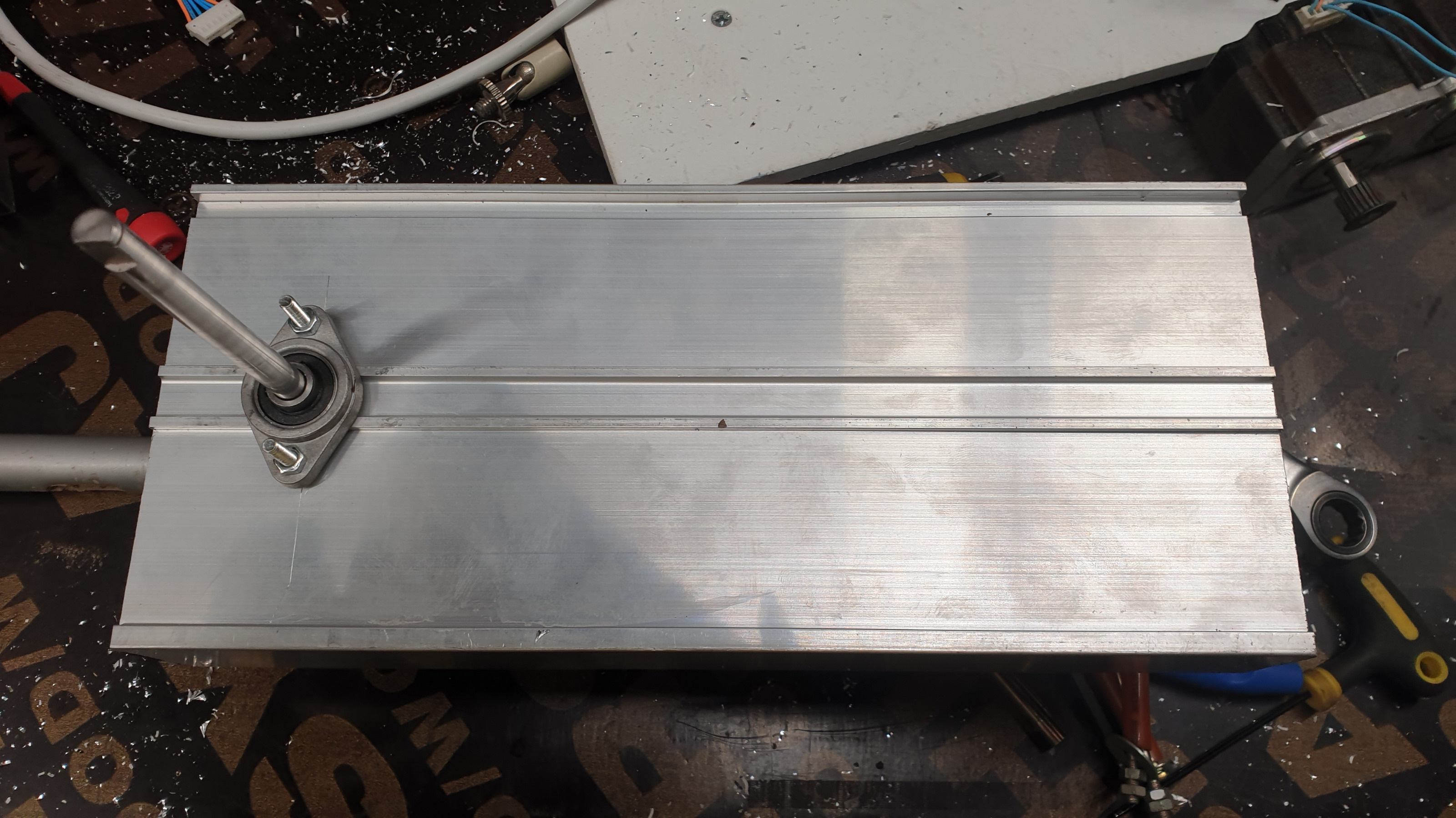

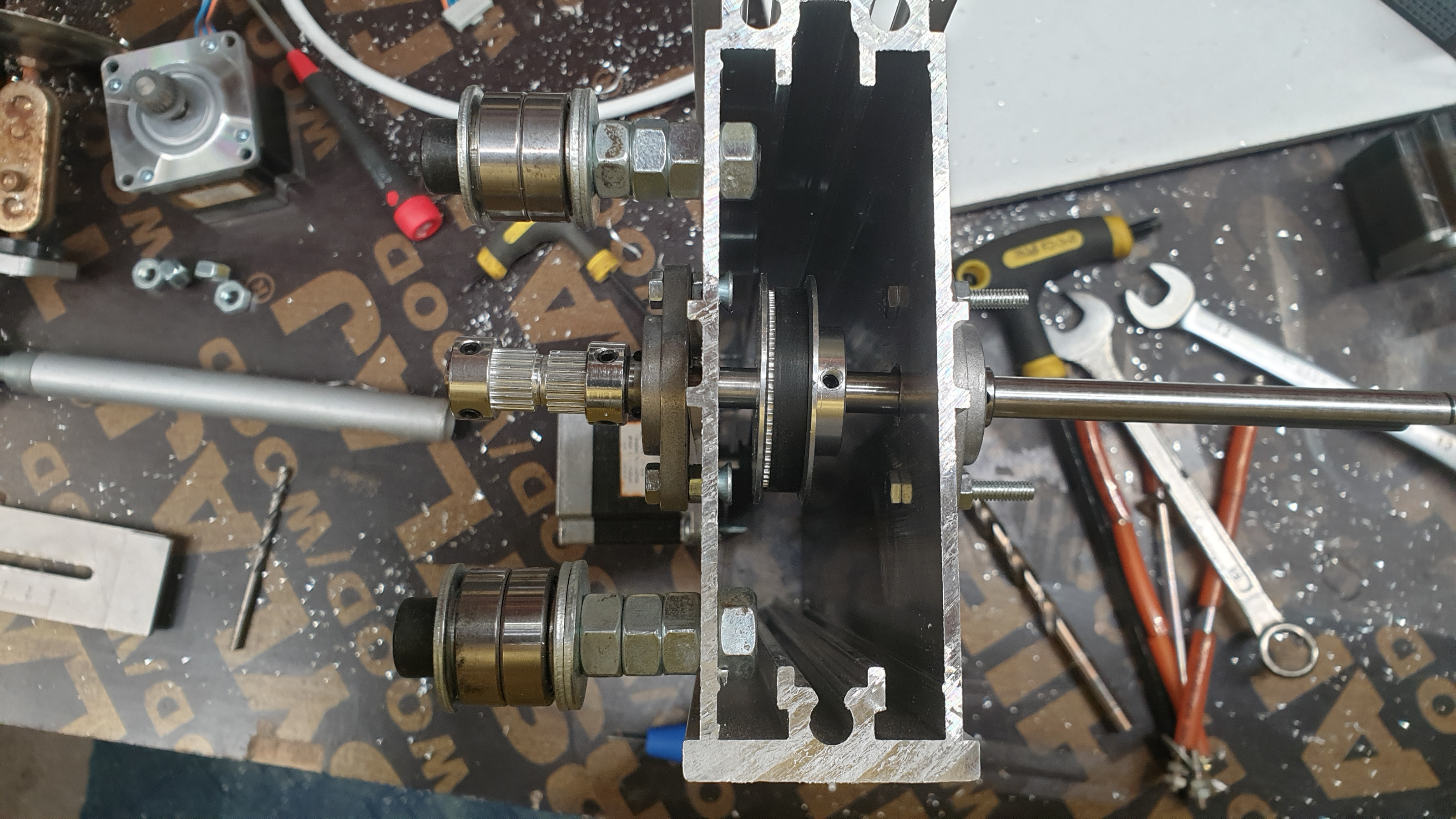

Today i did some experimental work on a reduction for smaller machines with belt drive, using some aluminium profiles, and there is no way on earth i can explain how it is done so here are pictures instead of me yapping to no end:
Front:
And from above so you can see what is going on inside:
Thoughts, ideas, critique ? Free velocity servo drives ???
Spec:
Front:

isent this a standard 42 mount
and the tachos are hooked up
take the backcase off and mount cheep 20USD 2000ppr Hole/Shaft encoders and you got a real good system

They are 98mm frame, so not exactly nema42, and i did open them but there is no way to mount anything on them.
I do have 5x of 2500ppr encoders with 8mm shafts that will need mounts and axle made to be mounted beside the motor and driven by the belt. Not the best solution, but it works.
Thank you.

Another option is to mount the encoder on the far end of the ballscrew
Though this adds to wiring complexity

Use the servos in velocity mode with linear scales for position feedback.
