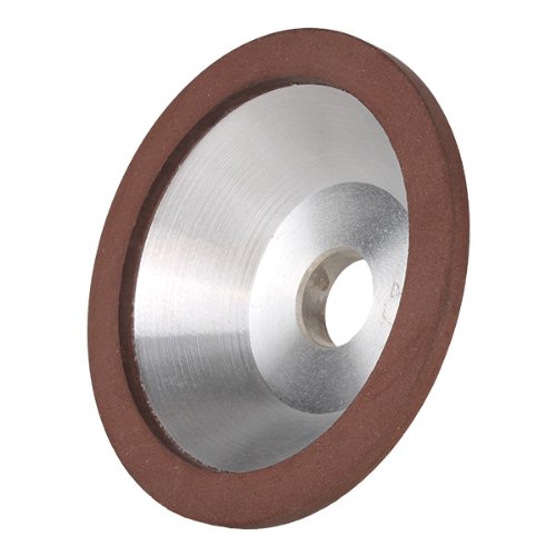

one of the things i was looking for was a way to grind tungsten and seen the standard attachment that fits on a hand held engraver but they seemed a bit over priced and i was not feeling the diamond cut off wheels as something that would work real well for grinding so i bought a diamond cup wheel for $16 bucks. i was going to mount this on a hand held grinder but the I.D. of the wheel is not fitting the grinder so i started to think up a plan B. i have a 1/4 HP 1725 RPM induction motor with a half inch shaft. so now i'm thinking of just making a rigid coupling for the motor and just attach the cupped wheel directly to motor.
i also bought a set of casters so i can make a cart for this thing as soon as i get every thing situated. i need to add and outlet for 240V so hopefully i can at least get that in over the weekend. i figured why buy a cart when it would make a good practice project
i think this type of wheel will work better for grinding tungsten though.

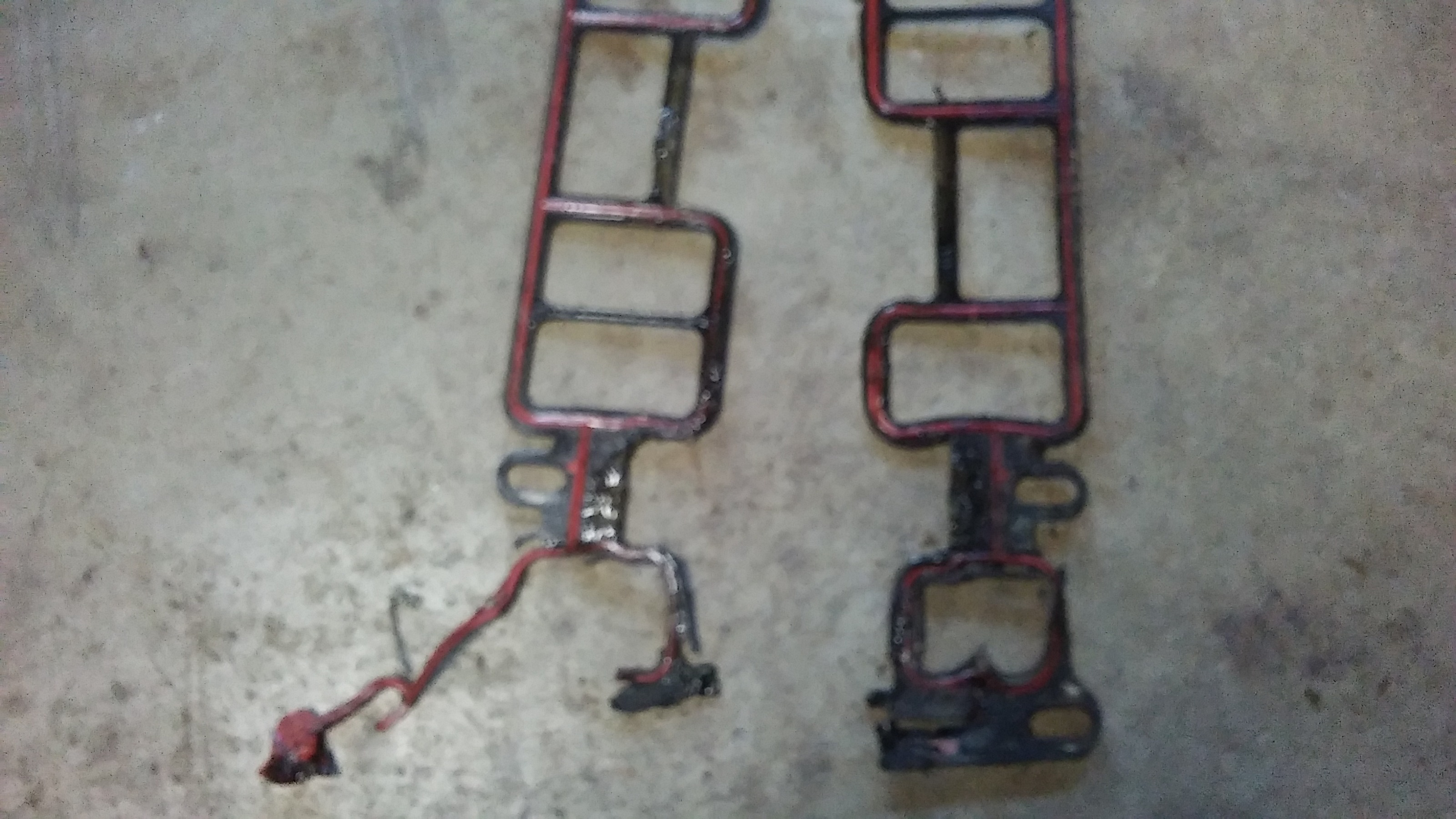

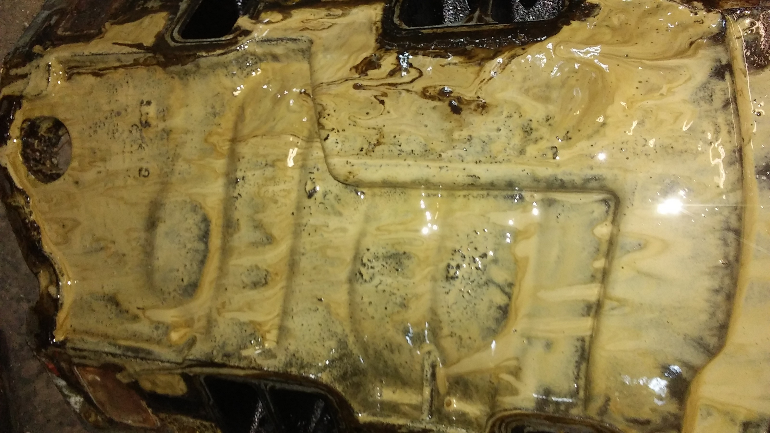

daughter wrecked her car total loss for the kid so i gave here an old SUV i had so she would have some time to get back on here feet with the car situation. this SUV had been parked for about 4 years and it ran decent and fired right up once i jumped the battery so i went through getting it ready to get inspected and transferred every thing over to her. thought i had things wrapped up and drove it out to the gas station to fill it up and the thing starts over heating? temp gauge quite working so i thought the thermostat was sticking so i put a new one in. same problem. added some water and it started running cooler but was still a little hot from normal. went over every thing and could not find and leaks so i was starting to think water pump? well long story short i pulled the dip stick to find a milky mess on the end of the stick. so tore into things and found this mess
first thought was a head gasket but these motors had a lot of issues with intake gaskets so that was my focus. sure enough a water port on each side of the intake on the front was the problem.
