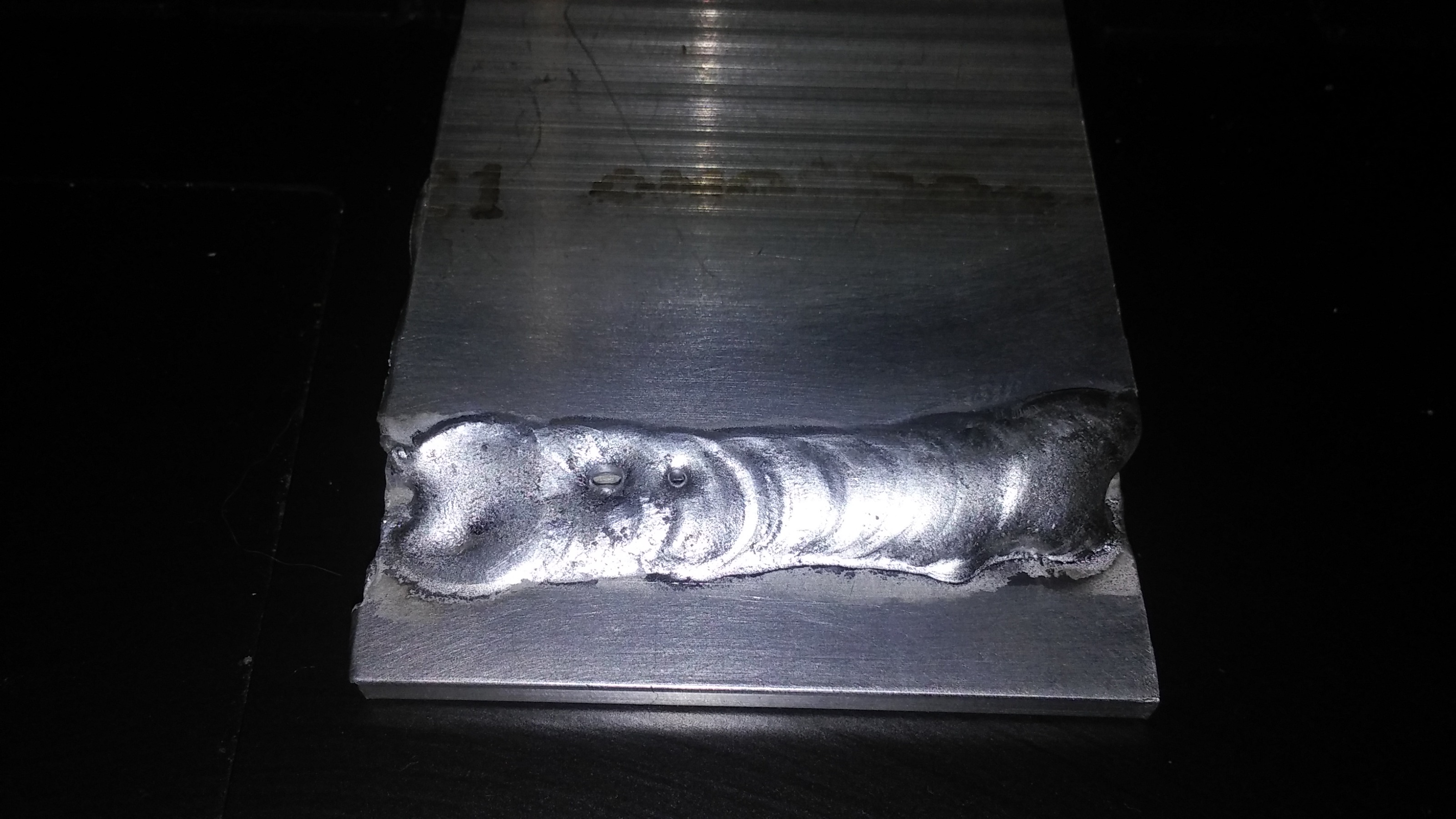

yeah i'm in the United State. I'm not a welder by trade it's just something i like to do and is useful around the home. i'm actually a Machinist by trade so sometimes being able to add material to rework something is handy in a pinch
Aluminum is a little different than steel and can be tricky. it does have an oxidation layer that needs removed before welding can actually happen. the melting point of the oxidation layer is much higher than the base metal so getting it cleaned off is the first step. so a stainless steel brush works for that then a wipe down with acetone to make it really clean. welding aluminum is really sensitive to contamination so lots of prep work is needed. the AC does the cleaning to help get under the oxidation layer too but to much cleaning is no good either then it harder to actually weld from what i understand about it.
i was trying a lap joint after i got some rhythm down and was getting more consistent but i think my gas was about out on this piece. not very sexy as far as welds go but it would probably not break that easy. i definitely need more practice
it was cold in the first 1/3 and hot on the last 1/3 of the bead but looked ok in the center section
this was the last piece i got before the welds got nasty looking from not enough gas so that could have been part of my problem but i am sure just lack of experience is in the mix as well.
Last edit: 14 Sep 2020 14:21 by machinedude.

Your bead crater at the end you need to regulate your machine crater option (current, post flow).
If all are regulated you are taking off the torch too fast, you need sincronize your hand touch off with postflow.
Usually my preflow is fast and postflow i dont touch just when i work with something thin and this is rare, here in japan thin job dont pay well.
I touch a lot the start, when work and finish arc.
In japanese we call クレーター (crater?)i search for translation and get it.

yes i agree with the end crater. i seen its common for weld in Aluminum to fail over time because of this and crack the length of the weld as a result. the welder i have only has post flow control the foot pedal controls the amps so that's more me not reducing the amps as the heat builds up in the part.
the welder i got is not a top level machine but not bad for under $700 for an AC/DC unit. it did come with finger control as a hand trigger to not use the foot pedal and that part has control for the starting amps and ending amps but i did not mess around with that part yet so i don't know how well it works?
as for the post flow i had it set around 7 seconds and try to keep the shield gas on the weld while it is on. the the tapering off on the amps i am getting use to still. i never used a TIG welder before this weekend
the material i was practicing on was 1/8 thick material or close to 3 mm thick. not very thick but about the middle of what the machine is rated at. the tungsen i am using is 3/32 but maybe a 1/16 would be better suited? seems like the weld is bigger than what i would expect?
i think the black color in spots could be the signs of my argon fading in and out since this was the end of my cylinder? like i said before everything after this piece was just not working at all until i seen the ball below were i had it set when i started. i ran quite a few flat beads that were a lot better. at first i just thought it was me not getting the arc cone in the right spot to fuse the two pieces but ran out of gas before i could do another one.

Looking at your weld picture, it looks like you could speed up a bit and narrow the puddle a bit. For 3mm plate I think the weld bead is a bit wide. If you can get the hang of TIG welding aluminum you will be able to weld anything!
From your posts you seem to have a good handle on critiquing your welds. Thats what you need if your going to improve, posting pics on sites like this helps but even us pro welders have to do that to ourselves to keep our welds looking good.
But basically it comes down to practice, study the weld, correct any defects and more practice! Hang in there and your welds like look like a row of dimes neatly stacked.
