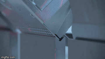

[1]
This is triumph 5000 I think. Superb! work efficiency
- Posts: 4819
- Thank you received: 2177
10 Oct 2020 08:04 #185563
Replied by Aciera on topic Linuxcnc Press brake - Open Source
Automatic angle measuring system. Very cool. Maybe achievable by using external offsets?

by pinder
Angle defined by tool height and shape of the base and tool.
External offset will surely help in aacuracy. Some kind of measuring system with light system
on one side and camera on other.

Replied by rodw on topic Linuxcnc Press brake - Open Source
Yeh, that is a cool video. I might have this a bit wrong but on my 2 axis press brake, it looks really simple. X axis is the back stop and Y I assume is a threaded acme rod each side that acts as a stop for the punch so you set the axes and press on the foot pedal which activates the hydraulics. More sophisticated machines will control the height of the back stop and position them left to right.
Setting the X axis is easy as it comes from your cad drawing so you just need to do some maths to convert the bend angle to a Y axis position. SO just get that far to start with and add the bells and whistles later.
