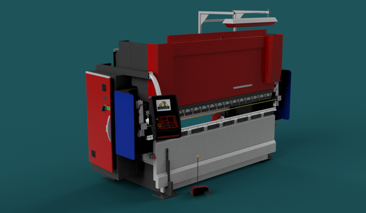

deep digging some non-english forums and websites led me to a nice Cad model.
I think it's an Amada press brake. I will update with links for files.
What format suits you all. F3d or stp?
people with cad abilities can modify and update it.
Last edit: 11 Oct 2020 06:13 by pinder.

I made some translations.
You can check github for source and edit.
github.com/hardwork-machines/Linuxcnc-Press-Brake

A question. Am I right here?
I think there there are two option for setting the tool height
1) we use linear encoders along with ram.
2) we can use ballscrews on both sides which trigger endstops. When we need different height l, setter moves up or down.
Foot pedal triggers the ram down until it hits endstop and then returns up.
Last edit: 27 Oct 2020 17:58 by pinder.
- aleksamc
- Posts: 569
- Thank you received: 67
27 Oct 2020 20:25 #187464
by aleksamc
Replied by aleksamc on topic Linuxcnc Press brake - Open Source
I think that for getting height you need to take linear encoder. If there is source of presure from few sourses, then you need linear encoders on two sides of press. Presure in each cylinder should be controled separetly.
Bottom side of press form should be one height. Up side of press form could be changable. It's height should be controlled with laser pointer with mirror that will give height of that pressform.
If press need to control only angle, than PLC is enough. You need to know only thikness of the material and bending radius.
It's m vision for this.
The following user(s) said Thank You: Diederik, pinder
