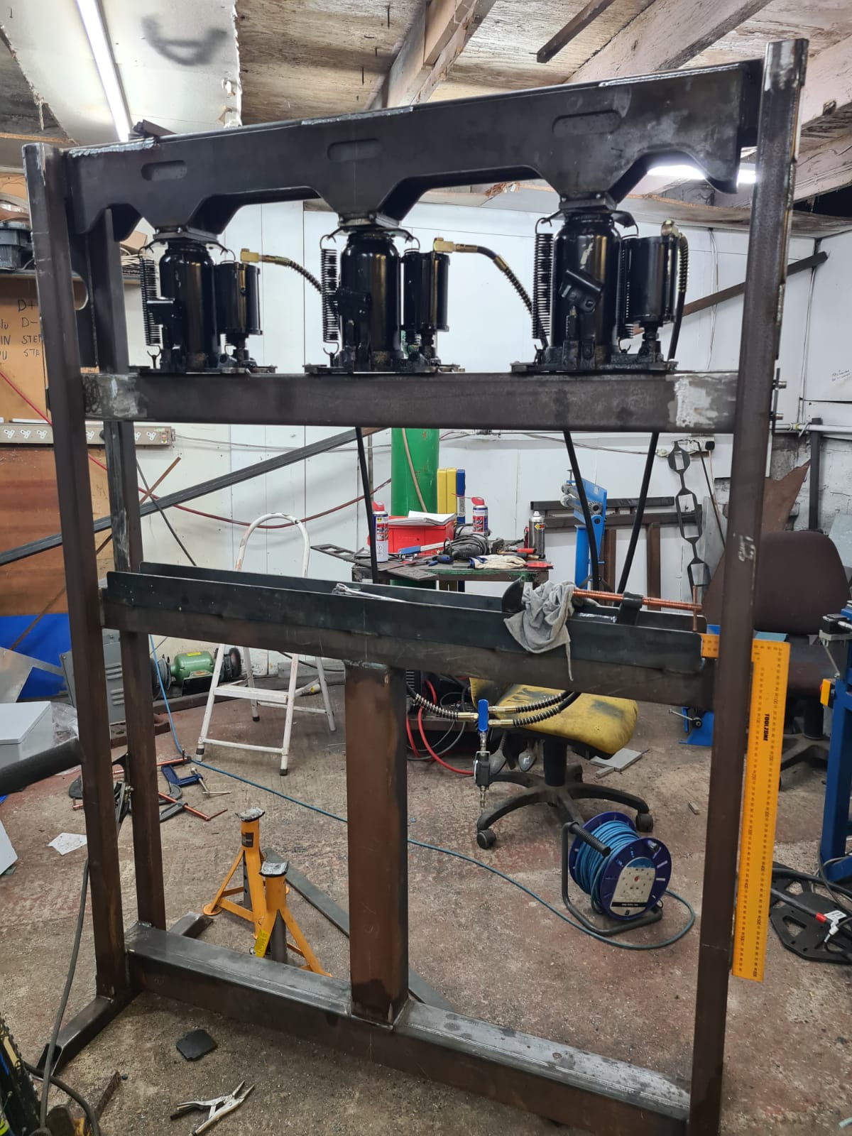

This is one my mate is building all cut out with PlasmaC
I think it is 100 box with 10mm wall

This is a work in progress. I am sure it could be cnc'd

Sorry, but if you do not have the material precisely in the middle it will not press square. With three cylinders parallel connected this constrution will move that cylinder the longest way witch has the lessest force to fight.
m5c
Mike
Yes I had thought that as well. How do the presses work with a ram at each side as that would have the same problem.
I don't have any experience with this sort of stuff.
