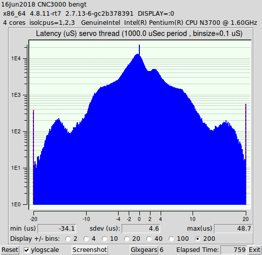

16 Jun 2018 12:05 #112484
by tecno
Replied by tecno on topic Complete HOW-TO Linux Mint 18.1 32/64 PREEMPT with RIP or build a .deb
bengt@CNC3000 ~ $ uname -a
Linux CNC3000 4.8.11-rt7 #1 SMP Sat Jun 16 11:12:14 CEST 2018 x86_64 x86_64 x86_64 GNU/Linux
bengt@CNC3000 ~ $
Does not look OK
Back to recompiling or give up ?
bengt@CNC3000 ~ $
Does not look OK

- Posts: 18118
- Thank you received: 5336
16 Jun 2018 15:10 #112492
Replied by PCW on topic Complete HOW-TO Linux Mint 18.1 32/64 PREEMPT with RIP or build a .deb
That should be OK but I would disable ISOLCPUs it will just make things run slower

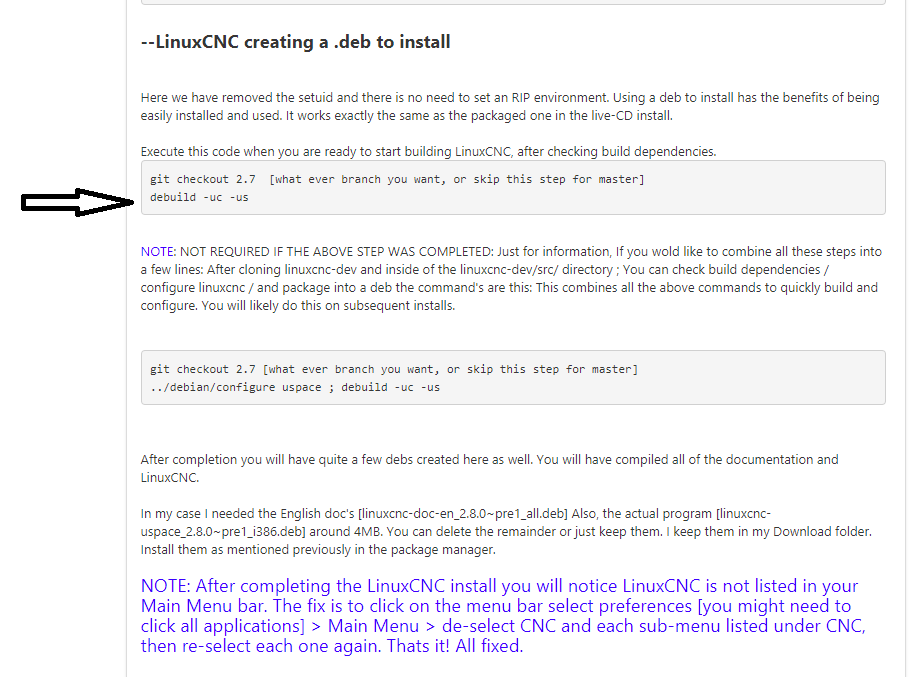

- ozzyrob
- Visitor
16 Jun 2018 15:48 - 16 Jun 2018 15:56 #112495
by ozzyrob
Replied by ozzyrob on topic Complete HOW-TO Linux Mint 18.1 32/64 PREEMPT with RIP or build a .deb
OK but that didn't install the version you just compiled, you may have installed the packages from the buildbot repository.
After debuild -uc -us you have to go to the directory above linuxcnc-dev where you will find the *.deb files you built.
You need to run dpkg -i the_name_of_linuxcnc_uspace_package_just_built
And dpkg -i the_name _of_the_linuxcnc_doc_package_just_built
Remember to change to the actual names of the deb packages. There does seem to be an omission in the original post regarding installing the just built debs. Debuild only builds the packages, it does not install them. Although it does mention installing the kernel deb packages by clicking on them.
I edited this post to show how to enable the source code repositories (in case you missed the previous post about it)forum.linuxcnc.org/9-installing-linuxcnc...deb?start=480#112467

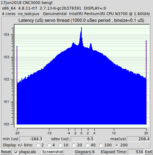

17 Jun 2018 03:20 #112500
by tecno
Recompiling now with above set correctly.
Got a note from fellow CNCer here in Sweden to check /boot/config-4.8.11-rt7
# CONFIG_PREEMPT_RT_FULL is not set
I think I have to get this one sorted out first, but how?
- tecno
- Posts: 1850
- Thank you received: 127
17 Jun 2018 07:44 #112504
by tecno
