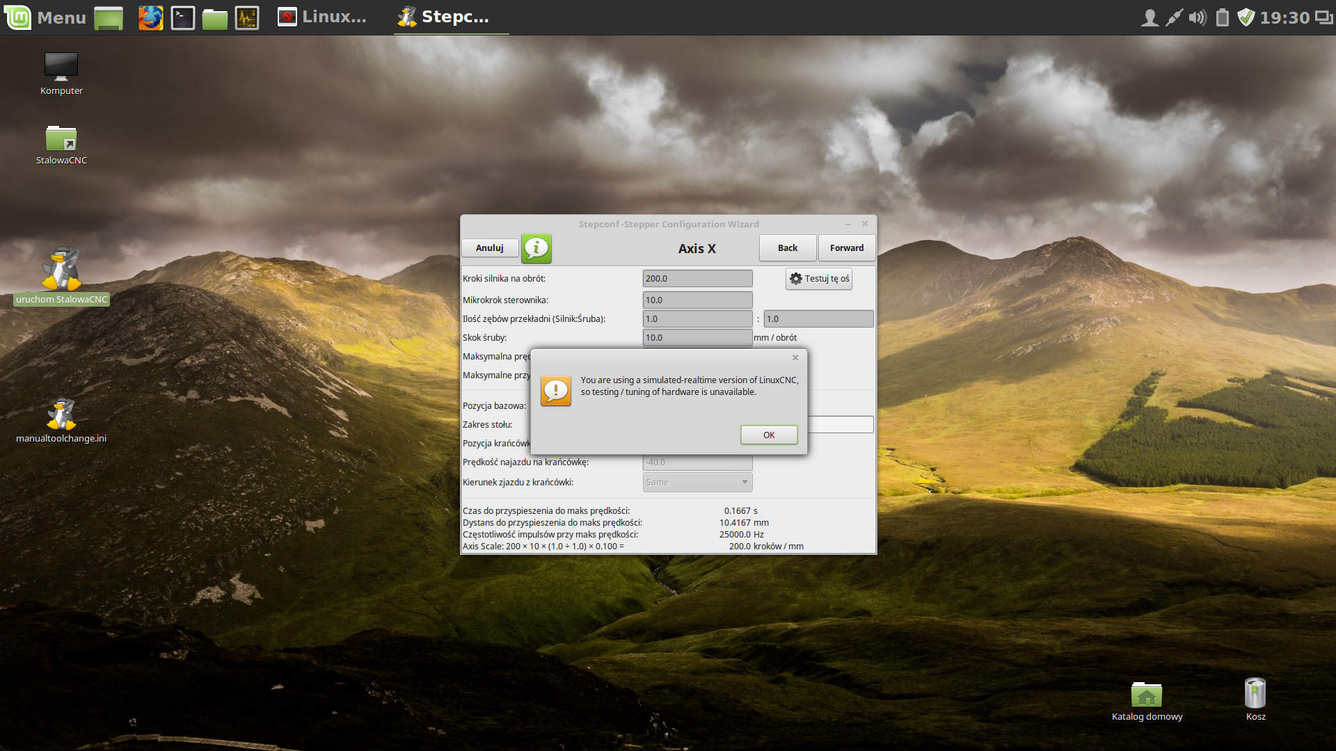

I think you forgot to " sudo make setuid " at the end of the install of linuxcnc after the " make " command.

At the second screen in stepconf untick the "use simulated somethingoranother".

Yes, I think that is probably the problem.
Replied by andypugh on topic Complete HOW-TO Linux Mint 18.1 32/64 RTAI or PREEMPT with RIP install or deb

"Create simulated hardware configuration." - I did not enable this option, I did all the settings as in the original emc.
- Posts: 19904
06 Jan 2019 14:46 #123635
On some versions the "create simulated config" was selected by default.

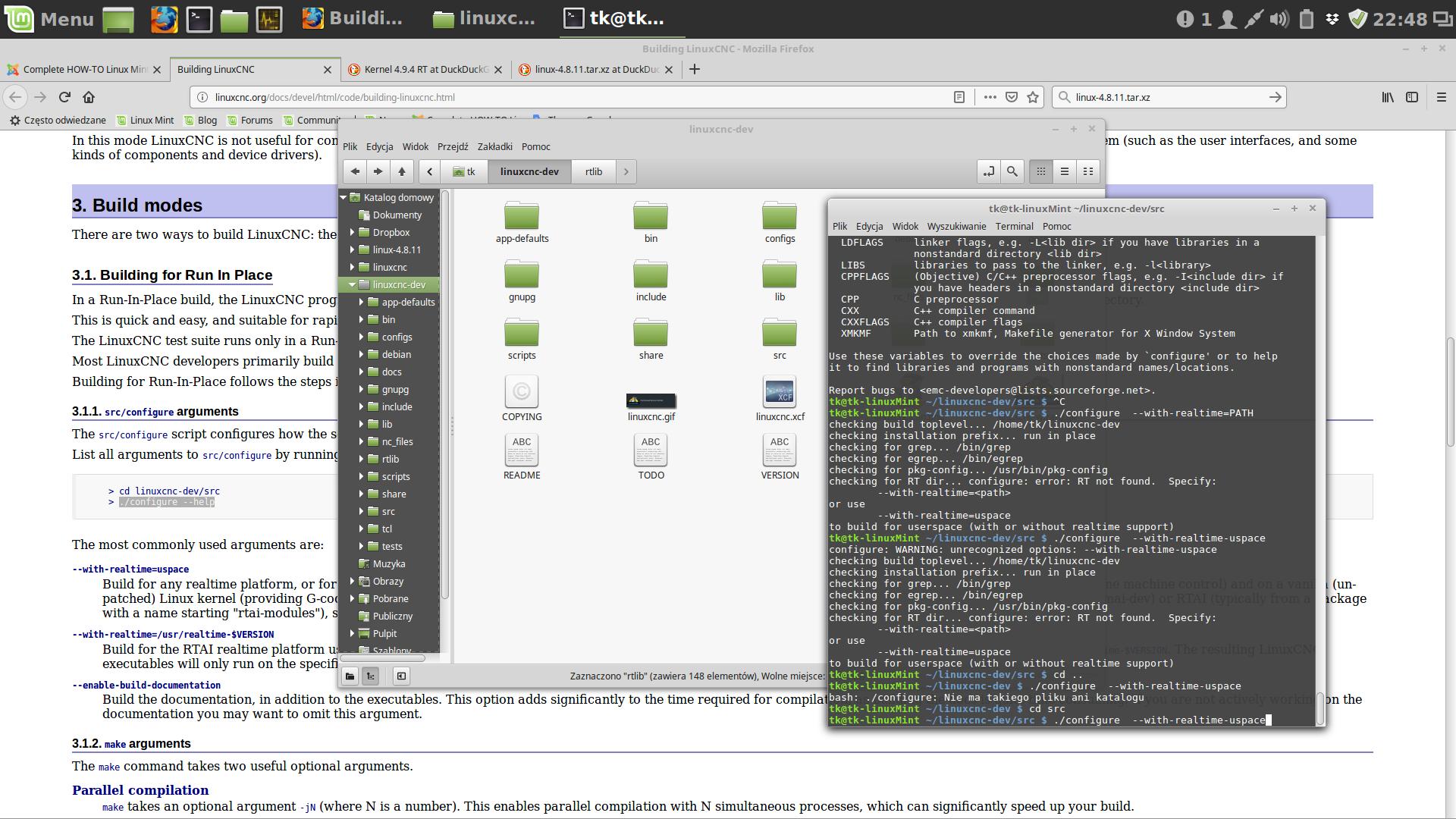

- richard123
- Posts: 11
13 Apr 2019 09:44 #130772
by richard123
Replied by richard123 on topic Complete HOW-TO Linux Mint 18.1 32/64 RTAI or PREEMPT with RIP install or deb
Hello, I am a very beginner in Linuxcnc. I was trying to follow the instruction of installing the rtai linuxcnc on my Mint 18.1 32 bit with cinnamon desktop. When I get to the step of installing the linux-headers-3.4.9-rtai-686-pae, it is said that it need gcc 4.6 but it is not installable.
after this, I tried to follow the instruction for the rtai 4.1.0.1 version. With this version, when I got to the ./configure -r , it is said that there is no available rtai kernel for my Linux kernel which is 4.4.0-53-generic.
Can anyone help me please?
