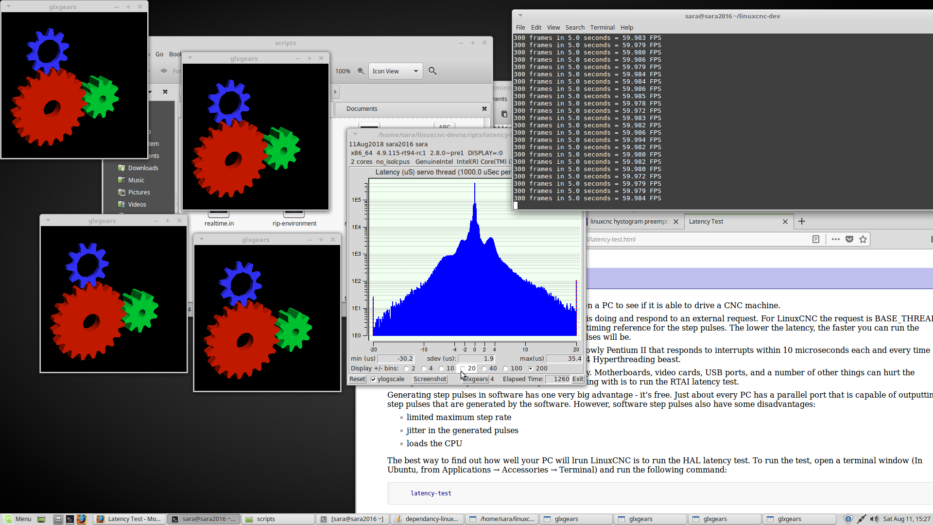

these my first run in mint --- no isolcpu, 64bit, no hyperthreading, no suspend ram, no ACPI ..... better than same config than debian RTAI .... these is good ... mint with mate is fantastick for my pourpuse ....
but if run "youtube" the latency run out to 70 (the same during the writing time of these post ... not know if upload image related or how) ... some suggest for keep a decent latency of 30/35??
using H97M gigabite, intel I3 3,6Ghz (4th gen) 4g ram ... ssd sata6. I'm on kernel 4.9.115 rc1 rt-patch.
regards
Giorgio
regards
Giorgio

after a month of work it is certain that with a mesa 7i77 board on board the latency value of 70 does not disturb at all.
