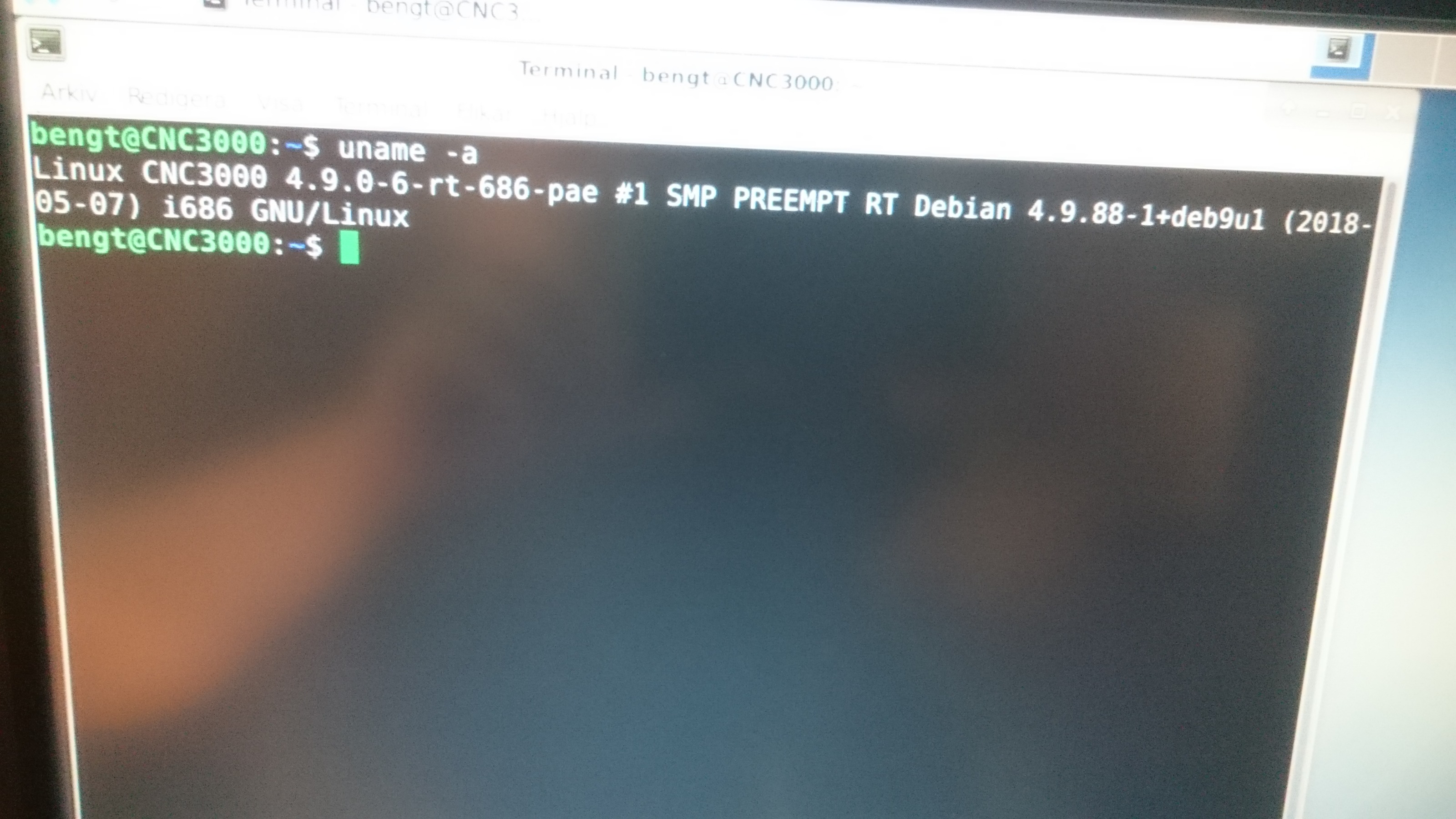

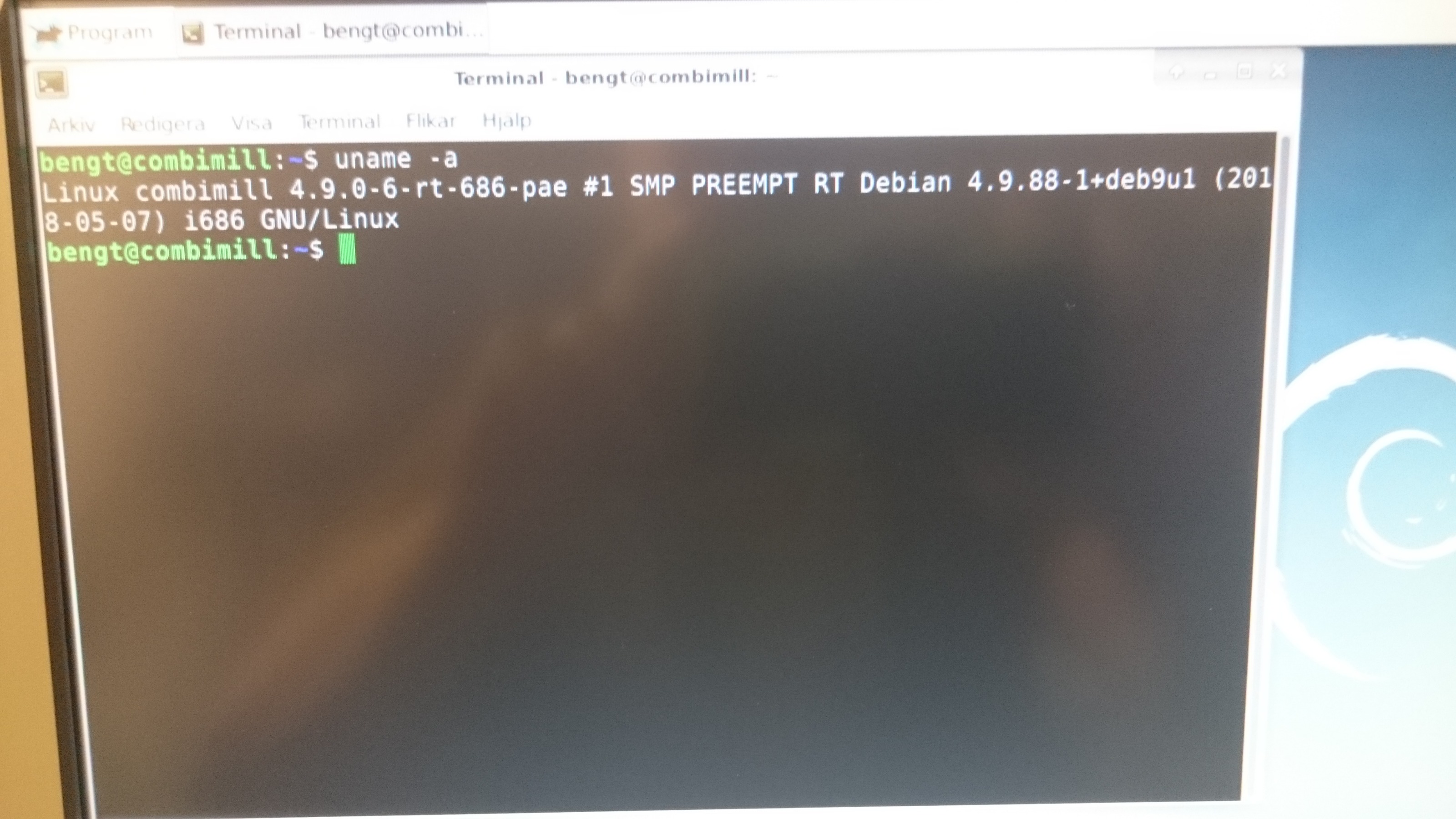

sounds like you accidentally "upgraded" your OS also
what does
uname -a
print?
what does
uname -a
print?

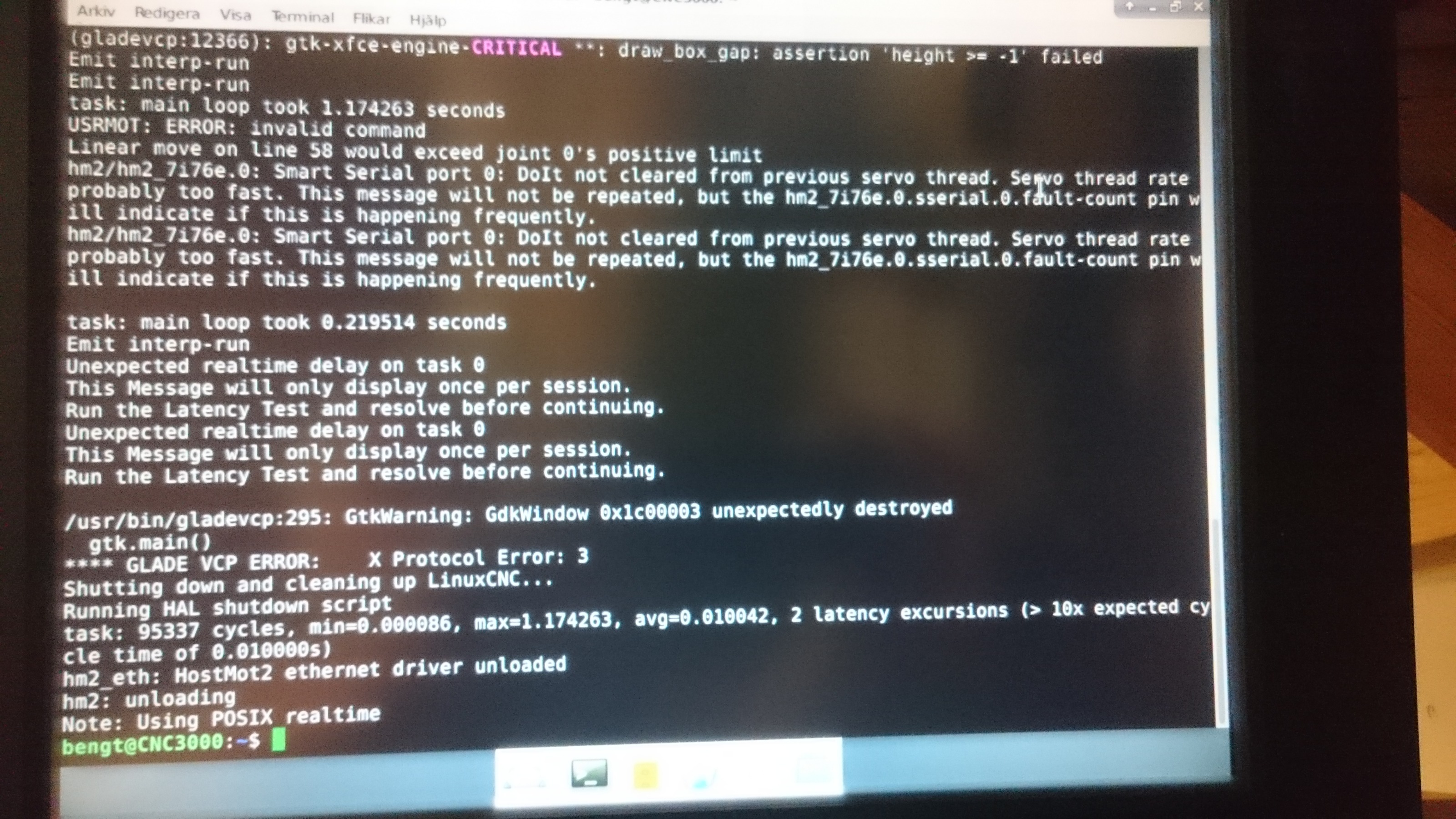

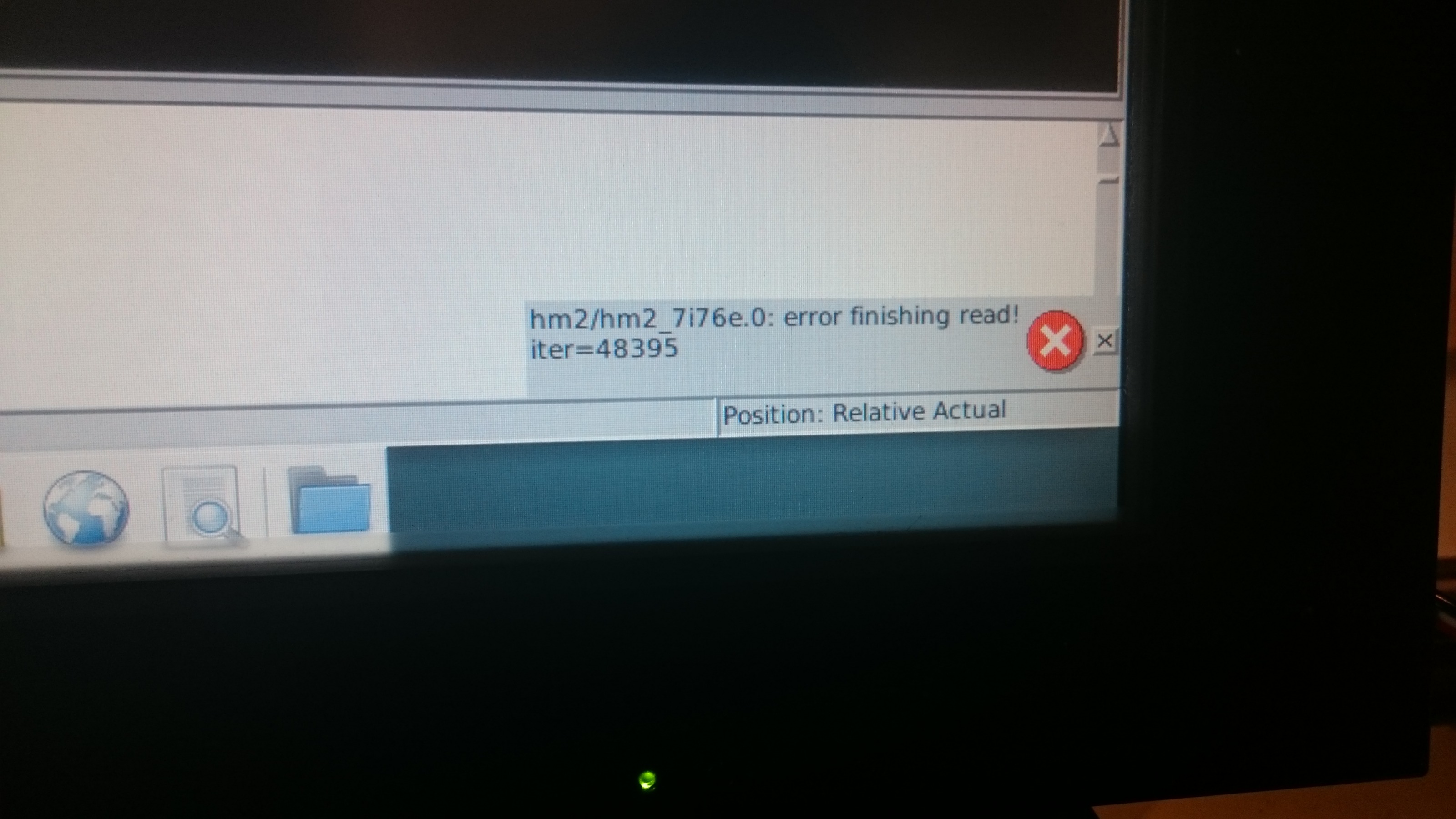

Mill appears to work as usual, just tested some axis movement + spindle and homing.

OK so that's the correct kernel so maybe the LinuxCNC is not the uspace version (so its running in non-realtime=simulation mode)

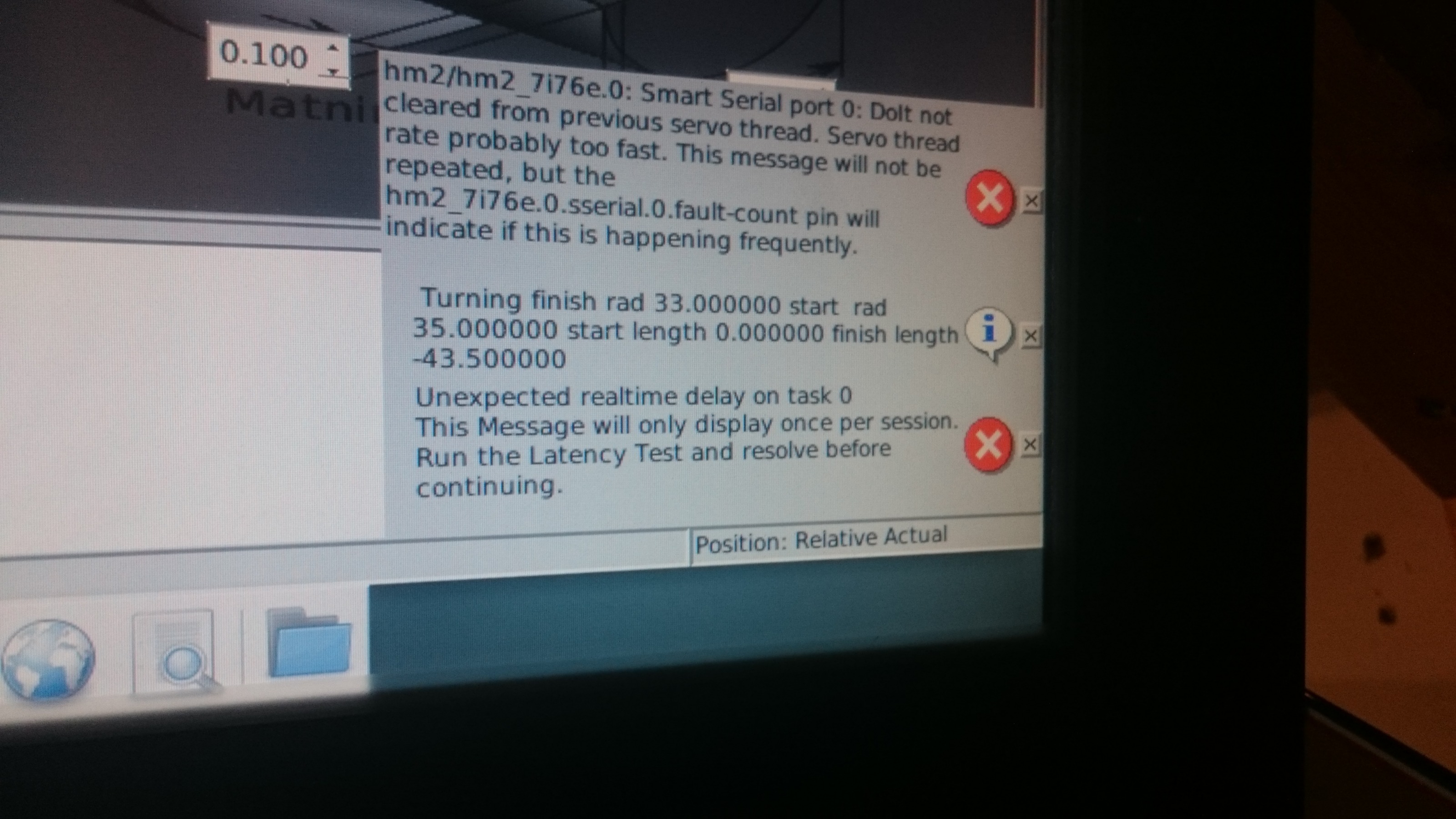

Hmmm, just started my normal INI = CNC3000.ini
But unsure as normally I do not have any text in the right panel ( as I recall ) and now there is a lot of text with LatheMacros etc...
Will have to investigate more tomorrow.
