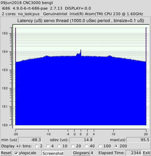

Hi Peter,
Will do that after my dinner.
Also if you have an Intel MAC you need to set irq coalescing off = sorry I do not understand what you say here, advice pls.
Only change on 2.7.12 was adding Touch and the update / upgrade

Do you have a intel MAC? (check with dmesg | grep eth)
The hm2_eth manual page describes setting the RX IRQ coalescing option
man hm2_eth
man hm2_eth

bengt@CNC3000:~$ dmesg | grep eth
[ 2.365659] r8169 0000:02:00.0 eth0: RTL8102e at 0xf825f000, 00:30:18:a6:5b:cb, XID 14a00000 IRQ 26
[ 2.519553] r8169 0000:02:00.0 enp2s0: renamed from eth0
bengt@CNC3000:~$
Latency test is running now
bengt@CNC3000:~$

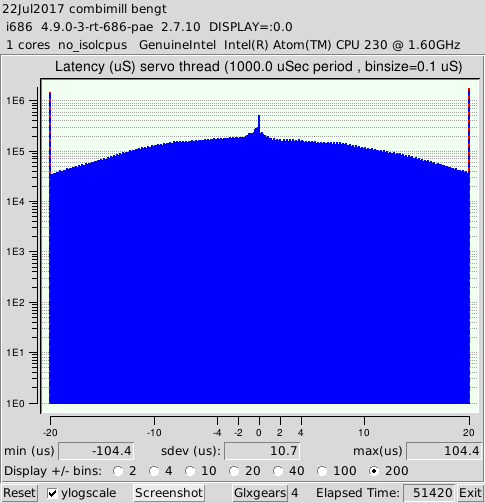

Replied by PCW on topic Upgraded to 2.7.13 -- W T F --
Seems similar but the OS version is different
My guess is this is either OS version related or that you have had some hardware failure coincident with the linuxCNC version change

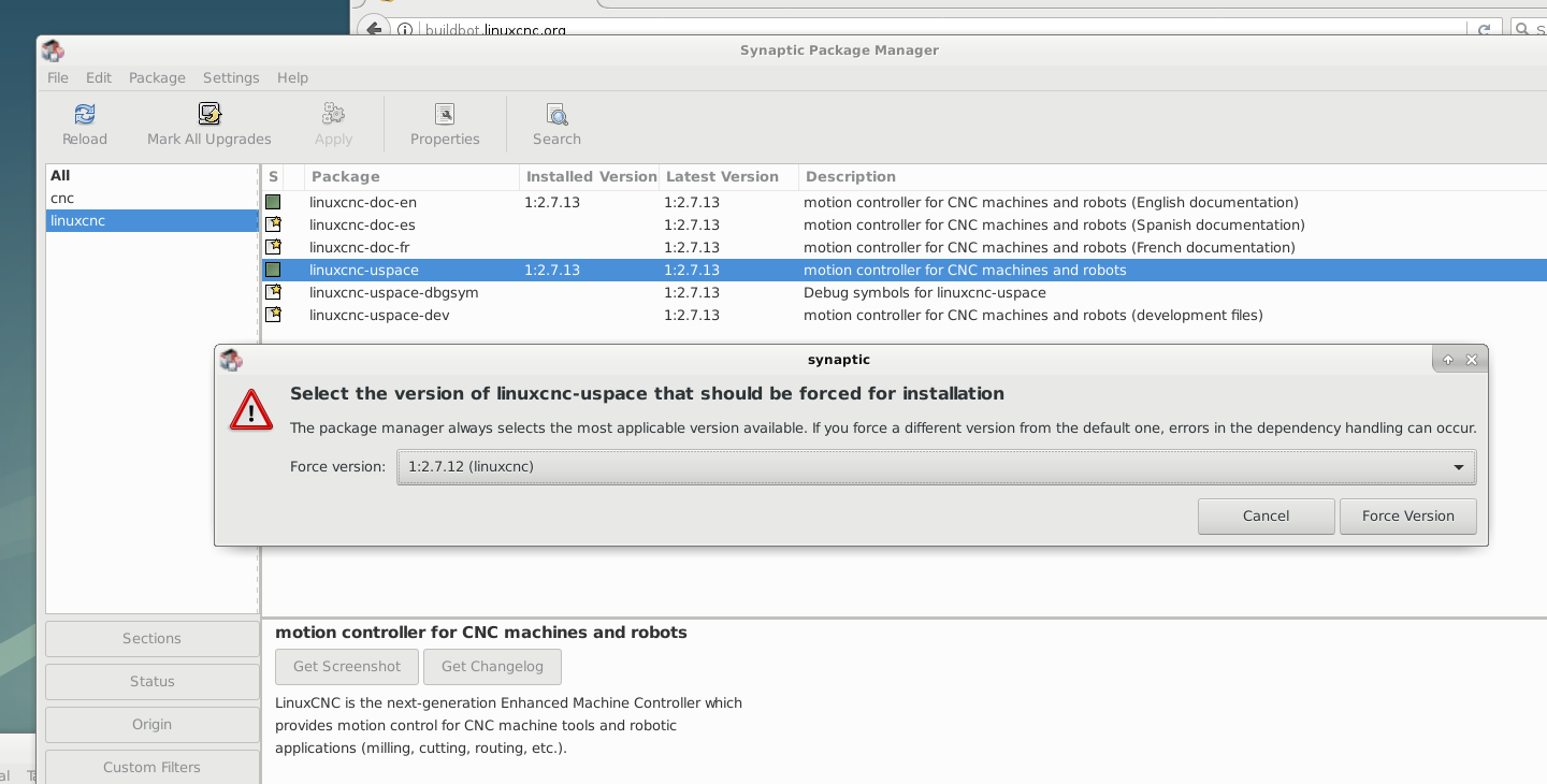

Just thinking out load, would removing the 2.7.13 version via dpkg and installing the 2.7.12 version and booting with the 4.9.0-3 kernel be worth a try ?
Would it still be possible to checkout 2.7.12 via git ? And trying a run in place
I'm not totally up on git.

You can do that in the Synaptic Package Mangler.
Replied by andypugh on topic Upgraded to 2.7.13 -- W T F --
Just thinking out load, would removing the 2.7.13 version via dpkg and installing the 2.7.12 version and booting with the 4.9.0-3 kernel be worth a try ?.
Last edit: 09 Jun 2018 18:20 by andypugh.
The following user(s) said Thank You: ozzyrob

Thanks Andy I'm not totally up to speed with all things Debian.....been a longtime Slackware user.
Would it be worth tecno trying ?
Ok after a bit of delving I was able to work out how to use git to get the 2.7.12 checked out. Got rip to build and simulate and then built the required debs as well. I was just wondering if the uspace packages thru synaptic are tied to a certain kernel version..maybe not or they might "fall apart" with the updated packages.
Like I said the "Debian Way" is kinda new to this fossil.
