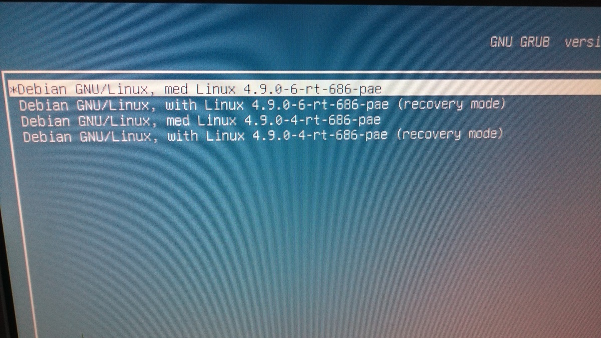

10 Jun 2018 06:58 #112129
by ozzyrob
Replied by ozzyrob on topic Upgraded to 2.7.13 -- W T F --
With a bit of luck you be able to select advance options on the grub boot menu and boot with the older kernel maybe 4.9.0-3 or something similar if there is an entry for it.
You maybe lucky and it's just a kernel issue.
I have no experience with the NUC platform...Hopefully Rod might chime in, I know he uses one.

10 Jun 2018 07:07 #112130
by tecno
Replied by tecno on topic Upgraded to 2.7.13 -- W T F --
- tecno
- Posts: 1850
- Thank you received: 127
10 Jun 2018 07:30 #112132
by tecno
Sorry but that did not help either
forum.linuxcnc.org/9-installing-linuxcnc...-t-f?start=30#112066
I get the same error as in picture above.
So is it the PC or is it something MESA related?
Just a note, I have done the same route on my milling machine = same type PC same Touch install and update/upgrade and all seems to work OK.
