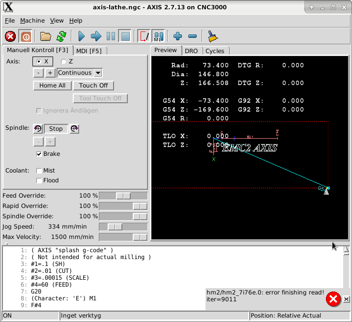

08 Jun 2018 02:45 #111970
by tecno
This output starting my backup CNC3000.ini and goes to error state
This happens after pressing F2 and grabbing the MPG to move Z
Now I get nowhere as after F2 it always goes to error.
Replied by tecno on topic Upgraded to 2.7.13 -- W T F --
Can you show us the output of:
cat /etc/apt/sources.list.d/linuxcnc.list
- Posts: 19904
08 Jun 2018 04:13 #111974
Replied by andypugh on topic Upgraded to 2.7.13 -- W T F --
Are you sure you want to be running the config in the backup folder and not the main config?
I suspect that the relative path from the backup INI is not finding the lathemacro files.
But I am not sure what the 7i76 error means.

- Posts: 19904
08 Jun 2018 04:22 #111976
I a, just going by
Why are you running the backup config and not the main config?
Embeded tab command "halcmd loadusr -Wn gladevcp gladevcp -c gladevcp -u lathehandler.py -x 44040621 lathemacro.ui" exited with error: 1
(gladevcp:1675): libglade-WARNING **: could not find glade file 'lathemacro.ui'
**** GLADE VCP ERROR: With xml file: lathemacro.ui : could not create GladeXML objectWhy are you running the backup config and not the main config?
