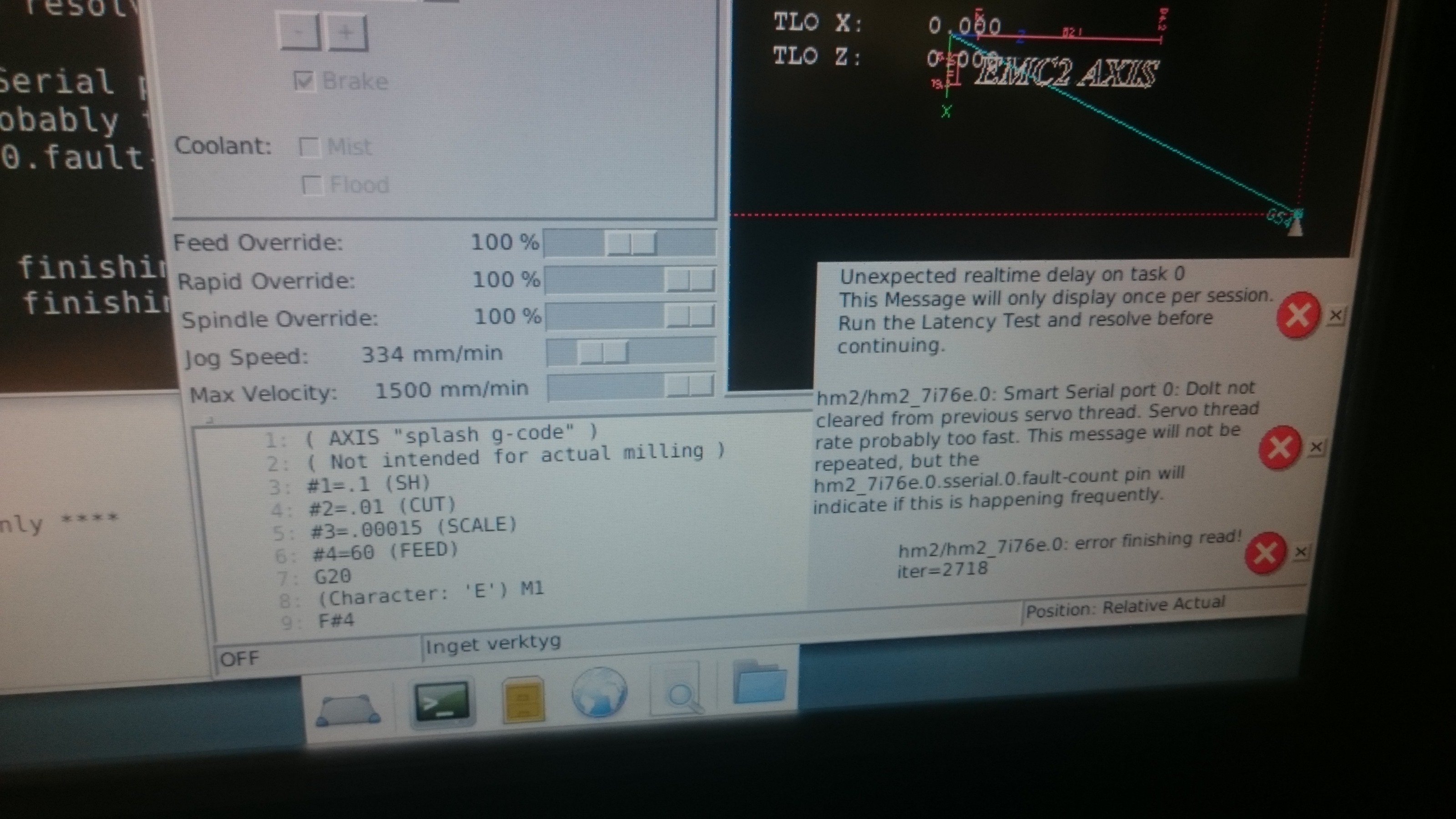

Sorry, that made it even worse as did 300000. With 200000 I can get into Axis but no other setting it fails directly.
With 200000 I can jog slow via keyboard but shift+arrow = hell is loose as it is with MPG
So there is something odd with servo thread speed, is this LCNC 13 issue or is OS related?
With 2.7.12 I could get rocket speed with MPG to stall my motors but that is nothing I want at all but I could
Now I barely touch the wheel and all hell is loose.
ps. the realtime delay on task 0 issue is also new with 2.7.13 = yes I know my PC is on the boarder

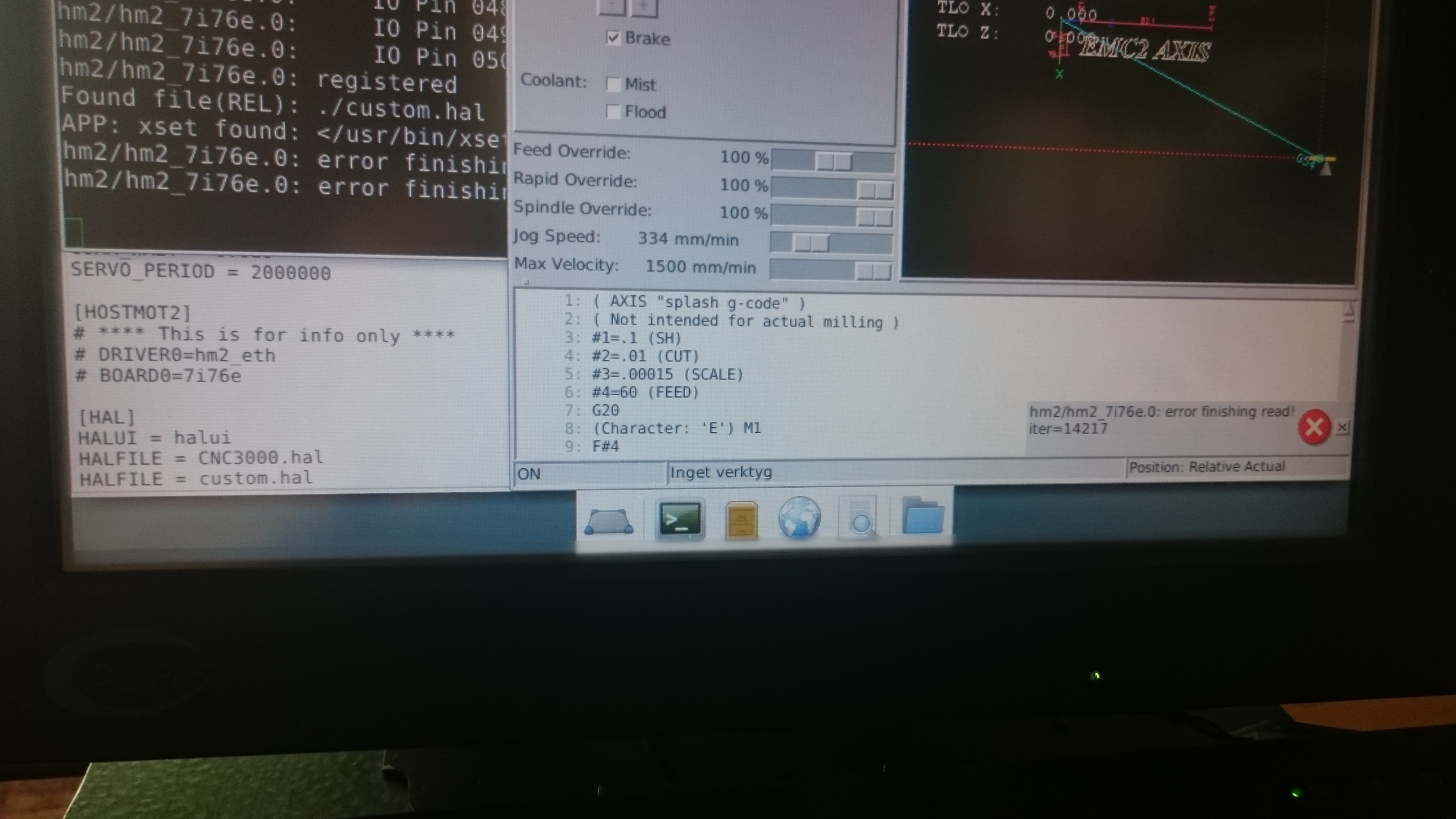

Here a new test this morning
First part is with 1000000 setting and from line 100 the setting is 2000000
this picture with 2000000 and only keyboard jogging and it fails after a while.
