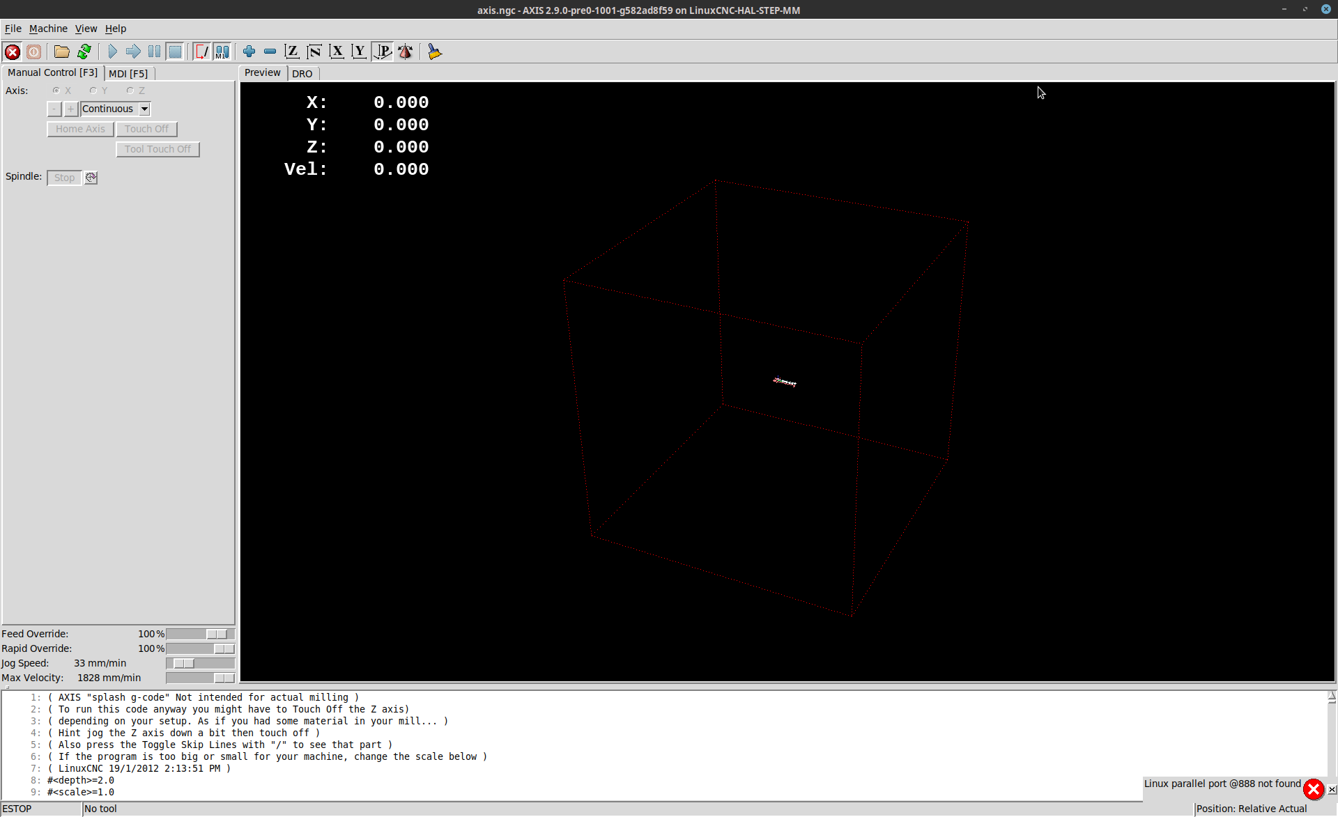

01 Mar 2020 09:16 - 01 Mar 2020 09:18 #158875 by tommylight
Replied by tommylight on topic Custom Mint-19.2 with Linuxcnc
Mint 19.2
View menu, show machine limits does nothing ????
It works here.

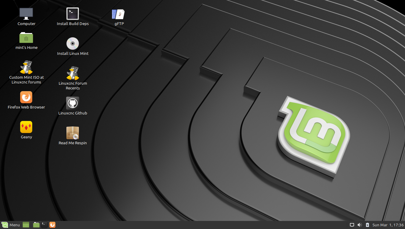

01 Mar 2020 17:26 - 02 Apr 2020 23:14 #158899 by BeagleBrainz
Replied by BeagleBrainz on topic Custom Mint-19.2 with Linuxcnc
Welcome to a respin of Linux Mint 19.2 MATE
  • New 1st March 2020 21:48]
  • Updated packages at above creation
  • Linuxcnc Version linuxcnc_2.8.0~pre1.5482.g7302cc1ba_amd64
  • pncconf will work with firmware in /lib/firmware/hm2
  • New desktop shortcut to Linuxcnc Forums
  • New desktop shortcut to first page of Linuxcnc forum thread for this iso
  • New desktop shortcut to Linuxcnc github
  • New desktop shortcut to install deps for building Linuxcnc, click and run once
  • Renamed this file to respin-20200301.txt & moved to /etc/linuxmint
  • New desktop shortcut to open this file with geany
  • Removed CNC Menu item pointing to html docs & html docs removed
  • update lsb Description: Linuxcnc Powered by Linux Mint 19.2 Tina
  • New 27 February 2020 11:14
  • ISO is now UEFI bootable
  • Moved this file to $HOME/Desktop
  • New 22 February 2020 22:04
  • QTVCP is now included
  • Glade3.8.6 has been included
  • HTML Docs have been included and added to CNC Menu
  • $HOME/utils/bin/get_linuxcnc_build_deps.sh has been included
  • Running this script by
    sh ~/utils/bin/get_linuxcnc_build_deps.sh
  • will download and install the dependencies to build linuxcnc form source
  • JT's excellent tutorial can be found here to get sources from git and compiling
  • www.gnipsel.com/linuxcnc/uspace/linuxmint19-emc.html
  • Original Release
  • Linux Mint 19.2 with RT_PREEMPT
  • Linuxcnc v2.8 from sources dated 15 Feb 2020
  • Geany, gFTP & Midnight commander included
  • Gimp isn't the default program to open pdfs
  • Initramfs modified to work when booted from a vfat filesystem, ie supports Multiboot
  • No support for qtvcp but can be added later
  • Mesaflash and limited hostmot2 firmware included
  • If booting stalls on Regenerating SSL certifcates please press shift, on a VM make sure the keyboard is captured
Please use win32diskimager if using a windows machine to write image to disk.
In Linux dd is recommended.
Unlike other images I posted this has been created using a virgin install of Mint 19.2 on real hardware.
To apply updates to fresh install open a terminal and use the following, this should not upgrade the kernel.
sudo apt-get update
sudo apt-get dist-upgrade
Iso Image:
No longer available do not ask for access
MD5Sum:
Many thanks to all who have downloaded, test, reported bugs and helped.
All issues and support should be directed to this thread.
forum.linuxcnc.org/9-installing-linuxcnc...t-19-2-with-linuxcnc
Last edit: 02 Apr 2020 23:14 by BeagleBrainz. Reason: No longer available do not ask for access
