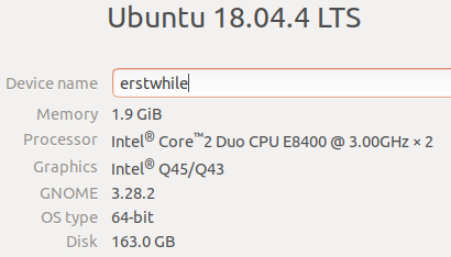

28 Mar 2020 08:56 #161803
by clunc
Replied by clunc on topic The Road to Building a real-time (RT) kernel for my favorite OS, Ubuntu 18.04.4
@BeagleBrainz
This is probably the quickest way to spec it. The machine is dedicated to running LinuxCNC--I've got a dozen other machines running Ubuntu 18 to use when this one is busy. It uses a parallel port with a Chinese mock Mach3-style controller.
@tommylight
...which brings me to why I'm passing for the moment on the much easier options, but with the same gratitude for their existence as everyone else.
#1. I want to have my LinuxCNC platform in the same adminstration fold with all the rest of my machines. I'd prefer to be in the same paradigm when jumping from machine to machine.
#2. I (really) think it's time I try to build my personal kernel--even if it's only aping someone else's...
#3. I'd like to know why in the world it can't be done on this machine, or alternatively that I can follow directions, I can compile and run a real-time kernel, only it sucks on this machine.
With luck (but see preceding diagnosis), I'll get the experience needed to build the right one on a right machine.

28 Mar 2020 09:00 - 28 Mar 2020 09:01 #161805
by clunc
Here's the error msg from the attempted 'make' step of an Ubuntu 5.0.14 kernel:
I ran it as:
% date > START; make; date > STOP; cat ST*
and learned that it took four hours. (Firefox was open with four tabs.)
CC [M] samples/trace_printk/trace-printk.o
AR samples/v4l/built-in.a
AR samples/vfio-mdev/built-in.a
AR samples/built-in.a
GEN .version
CHK include/generated/compile.h
AR built-in.a
LD vmlinux.o
scripts/link-vmlinux.sh: line 68: 12151 Killed ${LD} ${KBUILD_LDFLAGS} -r -o ${1} ${objects}
Makefile:1043: recipe for target 'vmlinux' failed
make: *** [vmlinux] Error 137I ran it as:
Last edit: 28 Mar 2020 09:01 by clunc. Reason: a little clarification

28 Mar 2020 09:15 #161814
by clunc
At first search, Error 137 might be an out-of-memory error.
Oh.
