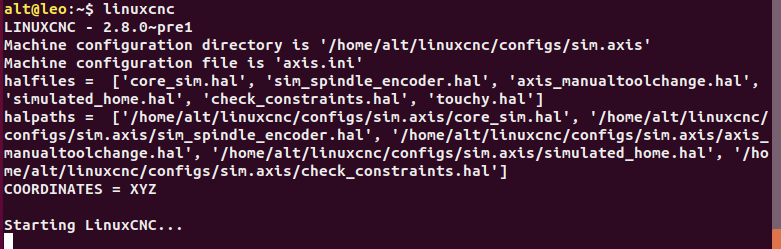

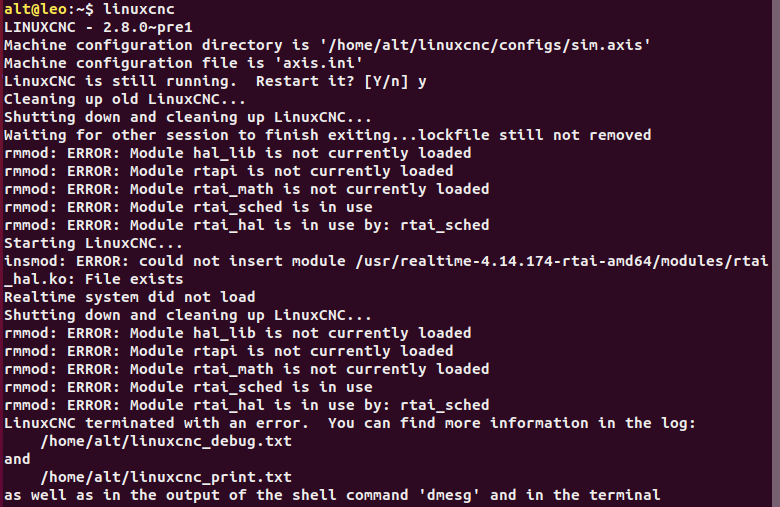

@BeagleBrainz
> Could you try running one of the sims say axis and see how long it takes to load up?
I tried it [attch1], but I don't get that far [attch2]
If I kill -HUP linuxcnc [attch3] is what I see: can't insmod.

Replied by andypugh on topic The Road to Building a real-time (RT) kernel for my favorite OS, Ubuntu 18.04.4
Once LinuxCNC has crashed and left RTAI modules installed the only way to clean up is a reboot.

> Are you starting LinuxCNC?
Stand by. I must've grabbed dmesg at the wrong time. I'll get another. (requires a reboot because no way to unload linuxcnc after trying it, which I just did to try to run an axis sim)

> Just let it run it’s course, it just maybe that it takes more than 5 seconds to load
I've waited on it 5 minutes seeing only "Starting LinuxCNC" in the console. [At that point I give up and try to Ctrl-C (nothing) and finally kill -HUP the process.]
