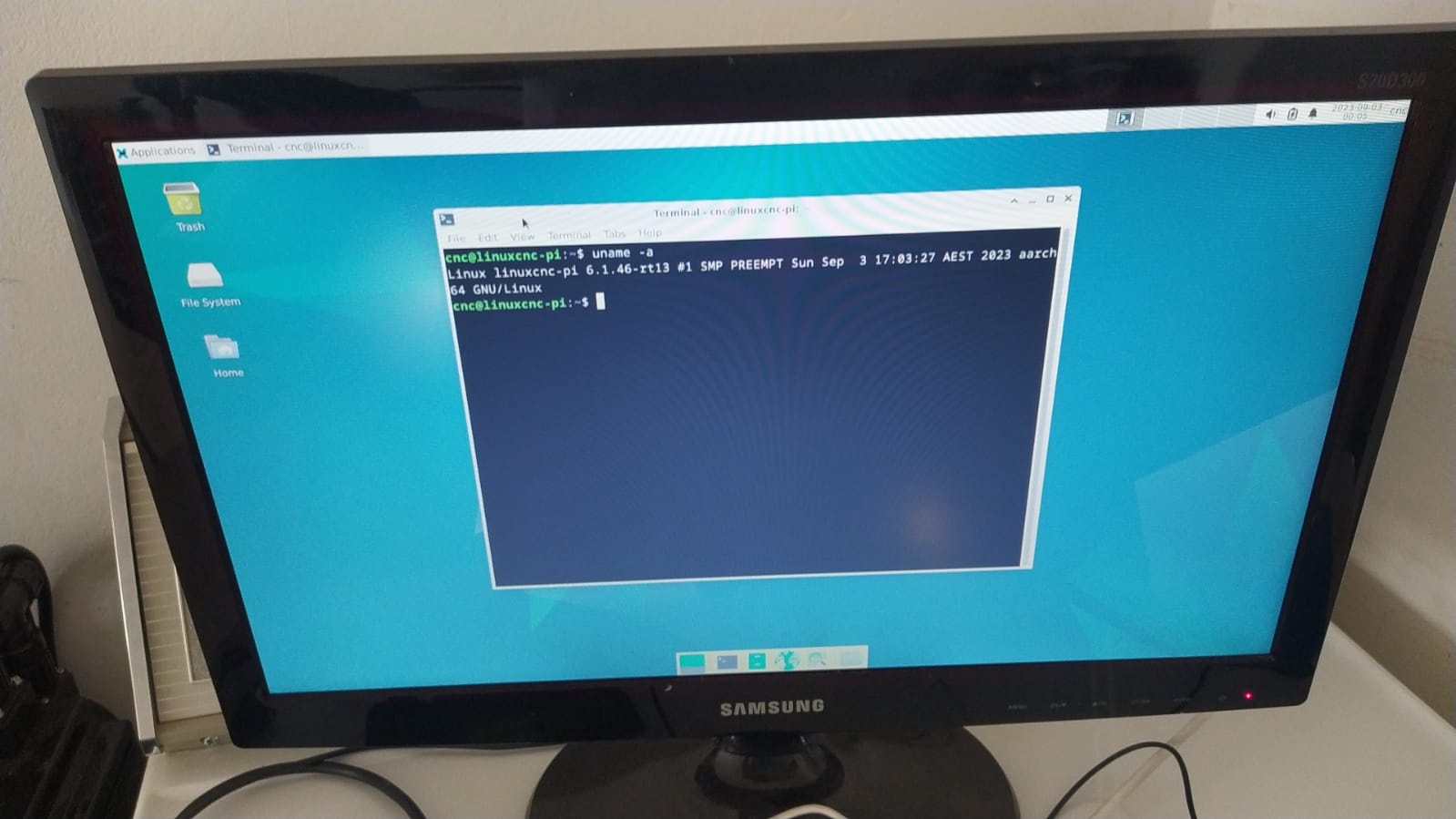

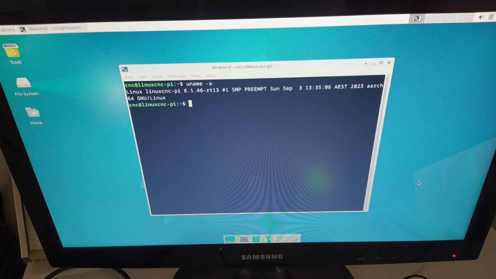

04 Sep 2023 06:33 #279790
by rbobey1989
Replied by rbobey1989 on topic RPI4 Raspbian 64 bit & LinuxCNC
hi Rodw, right now I don't have my RPI4 at hand, but I checked "uname -a, uname -v", they indicate correctly the kernel version 6.1.46-rt13 but only SMP PREEMPT (not RT), good idea to check by loading only the kernel as a *.deb file, I'll try again tonight, sorry for Cornelius and Cornholio.
I also wanted to ask about the expected latency values in an RPI4B 4Gb for the steps indicated on the Linuxcnc website for kernel installation, I have tried with 6.1.x and 6.4.x and I get values of 100us to 200us, this using debian Bookworm, now using Raspberry OS 64bits documented in another thread on this forum improves incredibly, according to the linuxcnc documentation, 100us forward is not good for software steps, but up to 200us for remora or hostmot mmmmmmm, criteria and opinions are accepted
