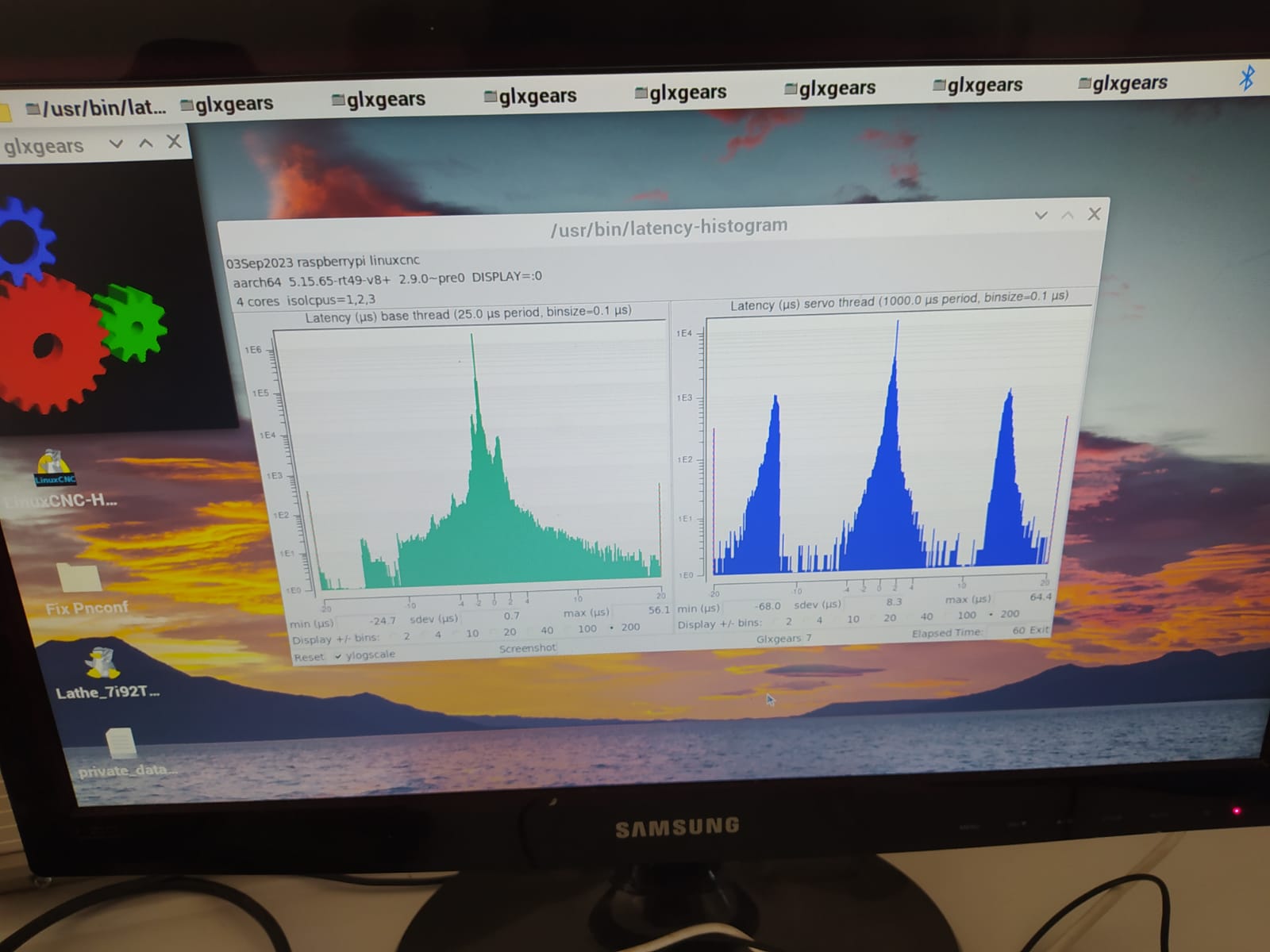

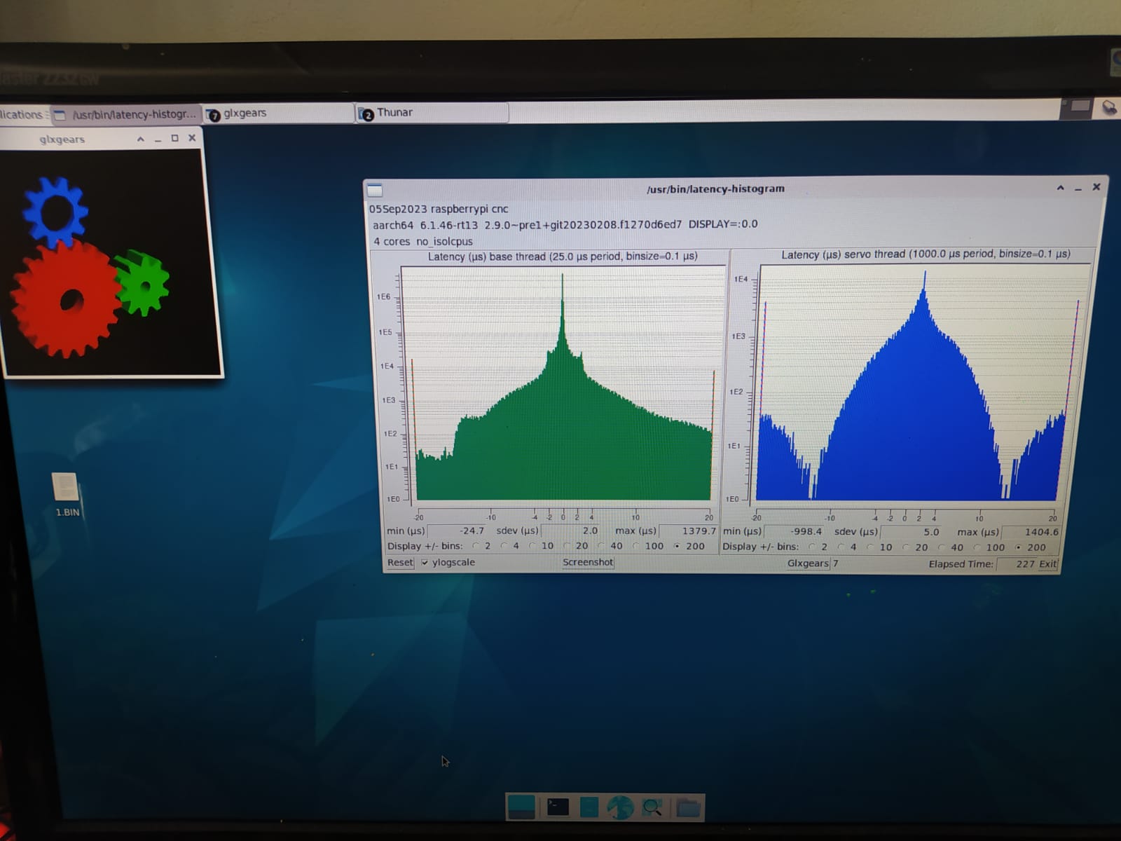

If you look closely one test had 3 cores isolated and the other has no cores isolated. That will make a huge difference.
As per my last post this has been addressed.
If you edit as root /boot/broadcom/cmdline.txt and add isolcpus=1,2,3 to the end of the line,reboot and test again then that will be a fair comparison.

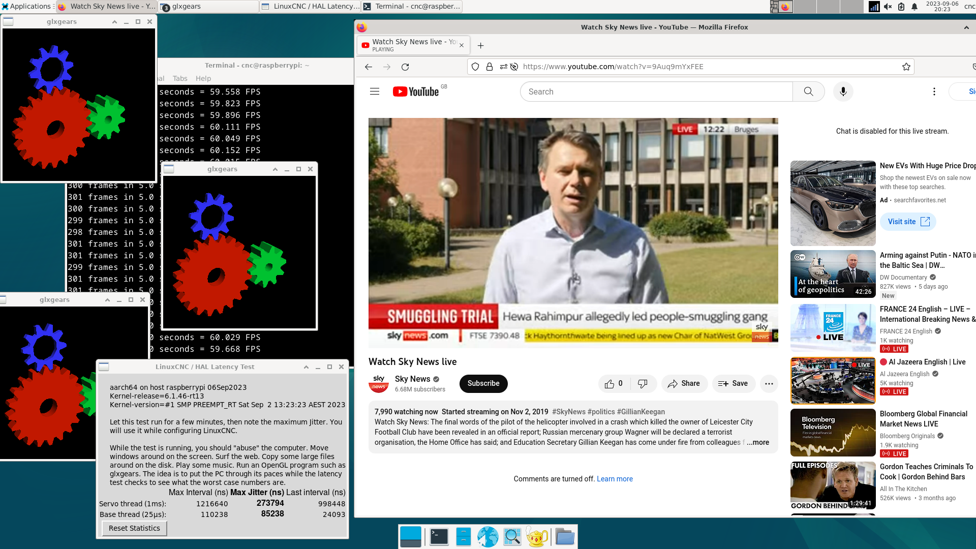

Donno only 2 cores are isolated so you wont get the same performance as your one with 3 cores isolated. But that can be fixed by editing /boot/broadcom/cmdline.txt to suit. Are you using GPIO to turn steppers, hence running a base & servo thread ?

Seems to work

Great work. Latency seems high. Have you compared isolcpus=2,3 with what you are using? Isolating 3 of 4 cores is a bit excessive as Linuxcnc only needs 2 threads for base and servo threads. (1 thread with ethernet hardware)
