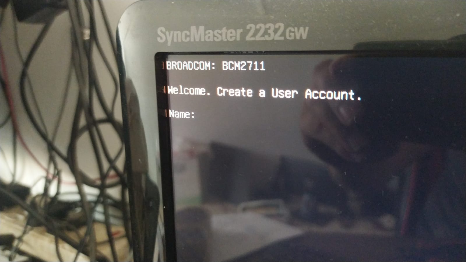

Replied by Cant do this anymore bye all on topic RPI4 Raspbian 64 bit & LinuxCNC
Ok boots fine,
but.......
before the greeter runs (login screen) you are asked to create a user in a text terminal, go through the process, gets to the greeter but you can't login with the created user or user cnc, wrong passwd, check your password.
I think it's this in useradata.txt USERACCT="1", I have mine set to zero and have no issues.
but.......

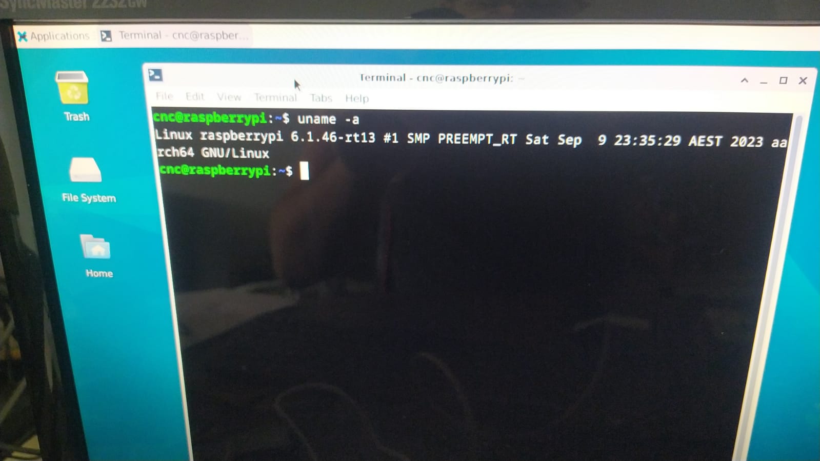

Hi rodw i tested rpi-4-debian-bookworm-6.1.46-rt13-arm64-ext4-linuxcnc-2.9--2023-09-10-0552.img.xz as Cornholio pioned out i was greeted with create user if i left it for a few seconds my system would lock up.
After a few tries i manage to get it to work ! I tipe cnc and "enter" four times fast i manage to log in with Username : cnc and password : cnc

Thanks for the screenshots. Its frustrating my Pi is dead!
Here is another image (2.10 master branch). Hopefully, it has the cnc user set up correctly
drive.google.com/file/d/1DfgpD9K1KrYJYbJ.../view?usp=drive_link
This image includes the dependencies for the Docs but does not include the docs themselves. That is my next job....
See if you can test Andy's GPIO driver.
