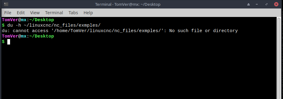

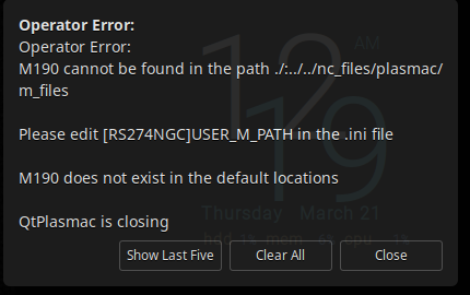

That doesn't make sense, the path listed there should be the USER_M_PATH from the .ini file.
Are you using master branch (2.10) or 2.9 branch?
Can you post the result of this:
Edit: It seems that I have made a mistake with the expected location of the codes directory in package installations. I will try to fix it before the weekend if you can respond to the above two questions.
du -h ~/linuxcnc/nc_files/examples/Edit: It seems that I have made a mistake with the expected location of the codes directory in package installations. I will try to fix it before the weekend if you can respond to the above two questions.

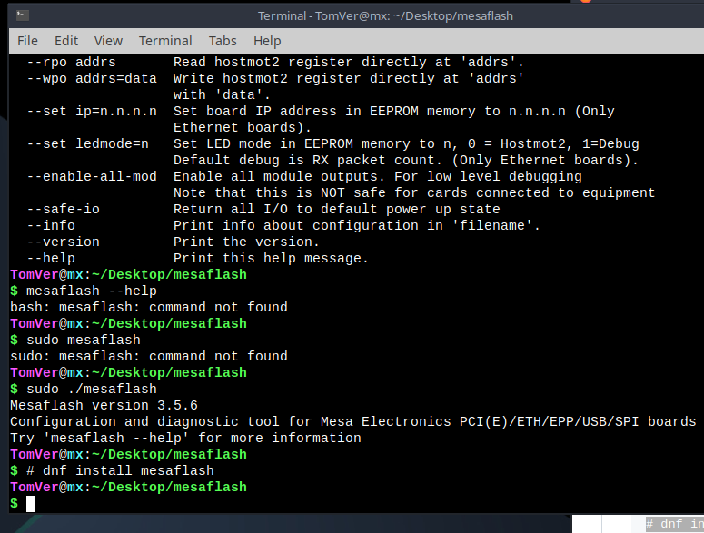

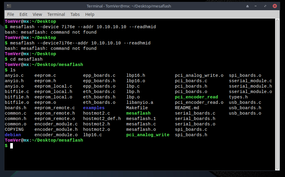

attached is the screen shot of what you asked for, and other screen shots not sure if they help.
some thing that did not happen is
mesaflash --device 7i76e --addr 10.10.10.10 --readhmid
