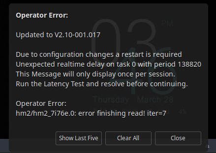

Phill I got a notice of a single new update to be loaded, is that to correct the missing folder bug you pointed out above (missing /examples/)

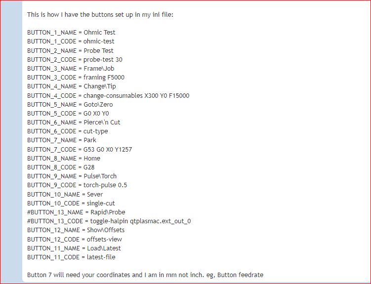

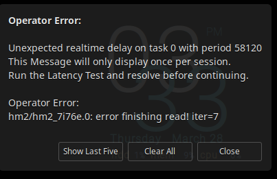

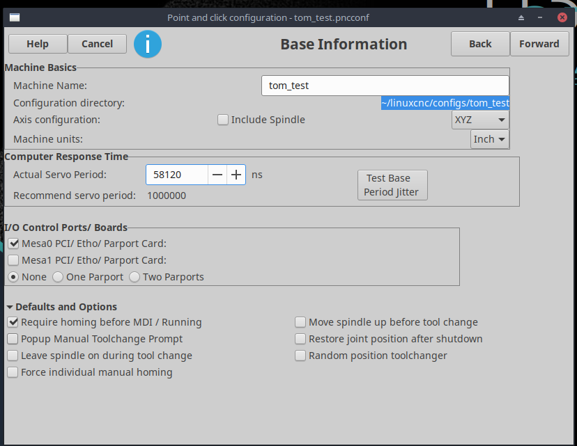

I am still having odd errors coming up and need some directions. I am getting error related to the latency test, I was told by another member to run the test and note the max jitter and write it in the box when running Pncconf. I did that and still get the error, tried different time same result. Also when I run Pncconf and then correct the missing folder (/examples/) and run QTPlasmaC it tell me a restart system is needed.
I also tried to add some missing custom buttons see list attached, but it was a total fail. Entered as they appeared on the list. In an older version I did add a simple command move torch to laser cross hair location and it worked (G1 X-5.XX Y-2.XX f70). I entered it under a page in the GUI followed with a save.

The above advice is valid only for use with parallel port and StepConf, and even then it is not very good as the value entered should always be higher than jitter value.
Set it back to 1 million and report back if it works or not.
The error you posted can also be caused by network cards, so what network card is in use?
Replied by tommylight on topic LinuxCNC Install using MX Linux 19.4 - Geared Toward New Users
Whoever told you to do that has no clue about how stuff works in LinuxCNC as servo period is normally never changed from the default 1000000 (1 million). The only usable reasons for changing the servo period is when using a really old/bad PC or when wanting faster position updates from Mesa boards.I am getting error related to the latency test, I was told by another member to run the test and note the max jitter and write it in the box when running Pncconf.

The restart message is telling you to restart LinuxCNC, that is because an update was done that modified the ini file.

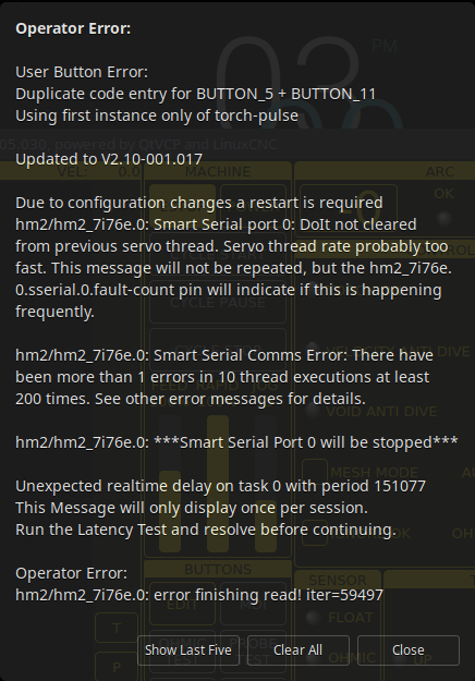

Thanks for the reply, the problem with the buttons was, I added some from the list when in Pncconf. And the next restart of the GUI the message was displayed (attached below). I went back in to Pncconf and removed those additions and did not have the error again. In a different version I had added a button to move the torch to a laser marked position (simple G-code instruction) with out a problem.
My thought was while in Pncconf that was how I add new buttons and used the example from the list as the format for them to be installed. Now after that it seems they should be added to one of the optional files for the GUI from the manual.

In the attached picture, the servo period is still 151xxx, that will not work, change it to 1 million.

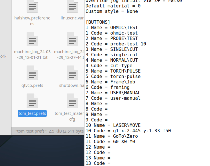

Ok I have found how to place new buttons in the GUI , it is in the .Prefs file see attached screen shot. Installed and working as it should without errors.
Thanks still learning
