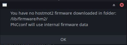

23 Sep 2021 02:49 - 23 Sep 2021 03:11 #221406
by billykid
Replied by billykid on topic LinuxCNC Install using MX Linux 19.4 - Geared Toward New Users - Discussion
the problem is that.
sudo apt-get install hostmot2-firmware-5i23
could not find hostmot2-firmware-5i23 package.
forum.linuxcnc.org/9-installing-linuxcnc...2-in-synaptic#137160
Last edit: 23 Sep 2021 03:11 by billykid.

23 Sep 2021 03:44 - 23 Sep 2021 03:44 #221409
by snowgoer540
I've been thinking you are referring to trying to run linuxcnc, but I think you might be talking about pncconf?
Is this the error you are getting?:
If so, I think it's as "simple" as putting the firmware files in that folder. Firmware files are located here in the "Specification" tab:
store.mesanet.com/index.php?route=product/product&product_id=65
Though I am not exactly sure which files/folders go where, and how (it's not as simple as dragging and dropping into lib/firmware). Someone familiar with pncconf will have to provide better guidance here.
The other option might be to ignore the error, use 5i25 to make your config, and then manually change the config files to reference 5i23.

23 Sep 2021 04:02 - 23 Sep 2021 04:06 #221411
by billykid
no not pnconf .. run linuxcnc in a working configuration on buster. i tried to manually put the files in / usr / lib / firmware the hostmot files but it doesn't work.
Could not locate firmware "//lib/firmware/hm2/5i23/SVST4_8.BIT". (No such file or directory)

23 Sep 2021 06:49 #221423
one / to many.
Replied by tommylight on topic LinuxCNC Install using MX Linux 19.4 - Geared Toward New Users - Discussion
Not the same as
one / to many.

23 Sep 2021 07:13 #221425
by billykid
Trust me Tom
the path was right, double slash was just in the message. the hm2 folder in usr / lib / firmware did not exist. i copied hm2 from buster 2.9 master disk on usb stick and with root file manager on mx 19 put it in the right place it works regularly. sorry I didn't think about it before but this problem never occurred. the 5i23 will be old but runs servo threads at 8 khz

23 Sep 2021 07:15 #221426
by snowgoer540
Replied by snowgoer540 on topic LinuxCNC Install using MX Linux 19.4 - Geared Toward New Users - Discussion
Glad you got it going!
I am curious, what exactly is in the hm2 folder? And if it's another folder, then what's in that folder, and so on?
Just trying to capture what exactly needs to go in there for the future.

23 Sep 2021 07:26 - 23 Sep 2021 07:29 #221427
by billykid
the missing folder is in: / usr / lib / firmware it is called hm2 and contains the subfolders with the various mesa tabs. I am attaching mine that I copied.
I deleted some boards for the 1.6 mega limits of the forum but the structure is that.
