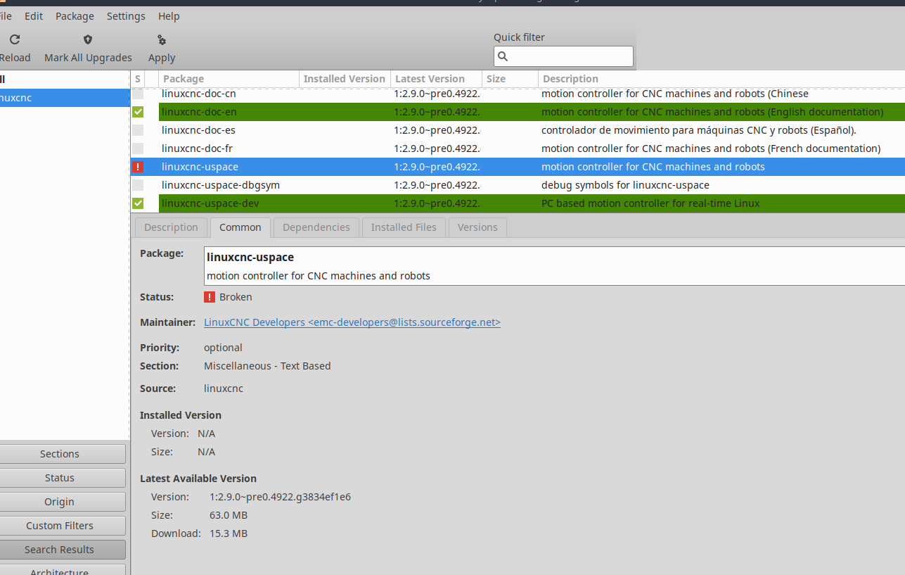

07 Nov 2021 17:32 #225565
by Clive S
Replied by Clive S on topic LinuxCNC Install using MX Linux 19.4 - Geared Toward New Users - Discussion
- Posts: 22005
- Thank you received: 7488
07 Nov 2021 17:40 #225566
Replied by tommylight on topic LinuxCNC Install using MX Linux 19.4 - Geared Toward New Users - Discussion
sudo apt-get -f install
That will install or fail with report.
- Clive S
- Posts: 2204
- Thank you received: 486
07 Nov 2021 17:47 #225569
by Clive S
$ sudo apt-get -f install
Reading package lists... Done
Building dependency tree
Reading state information... Done
0 upgraded, 0 newly installed, 0 to remove and 108 not upgraded.
