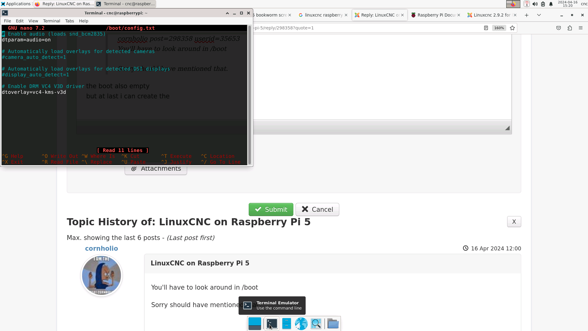

But at last i can create the config.txt
After reboot no changes...
Replied by xenon-alien on topic LinuxCNC on Raspberry Pi 5
The boot also emptyYou'll have to look around in /boot
Sorry should have mentioned that.
- xenon-alien
- Posts: 157
- Thank you received: 4
16 Apr 2024 12:41 #298361
by xenon-alien
The BOOT is a different partition with the config.txt and i must to remove the card from the RPi5 and use a card reader. It is not comfortable to make and test the changes...
Before the file was created in the sytems boot folder
So, how can I open this config.txt on the RPi5?

16 Apr 2024 13:43 #298372
by xenon-alien
But this image for RPi5 i can't understand, how to set up. (no standart configs...)
Left HDMI audio, resolution and the orientation...
But I have no clue which tutorial to use...

16 Apr 2024 15:01 #298374
by xenon-alien
Nothing happening after reboot.
Checked the SD card on a PC the BOOT partition's config.txt file is changed, like I did it on the RPi5.
Any ideas?
How to change the resolution, orientation and make it sound?
A connection with a Windows tablet everything is working on the display.
Any ideas?

16 Apr 2024 15:48 - 16 Apr 2024 15:50 #298380
by elovalvo
It can be done as you see here
forum.linuxcnc.org/38-general-linuxcnc-q...ge-resolution#292499
Replied by elovalvo on topic LinuxCNC on Raspberry Pi 5
Any ideas?
Last edit: 16 Apr 2024 15:50 by elovalvo.
