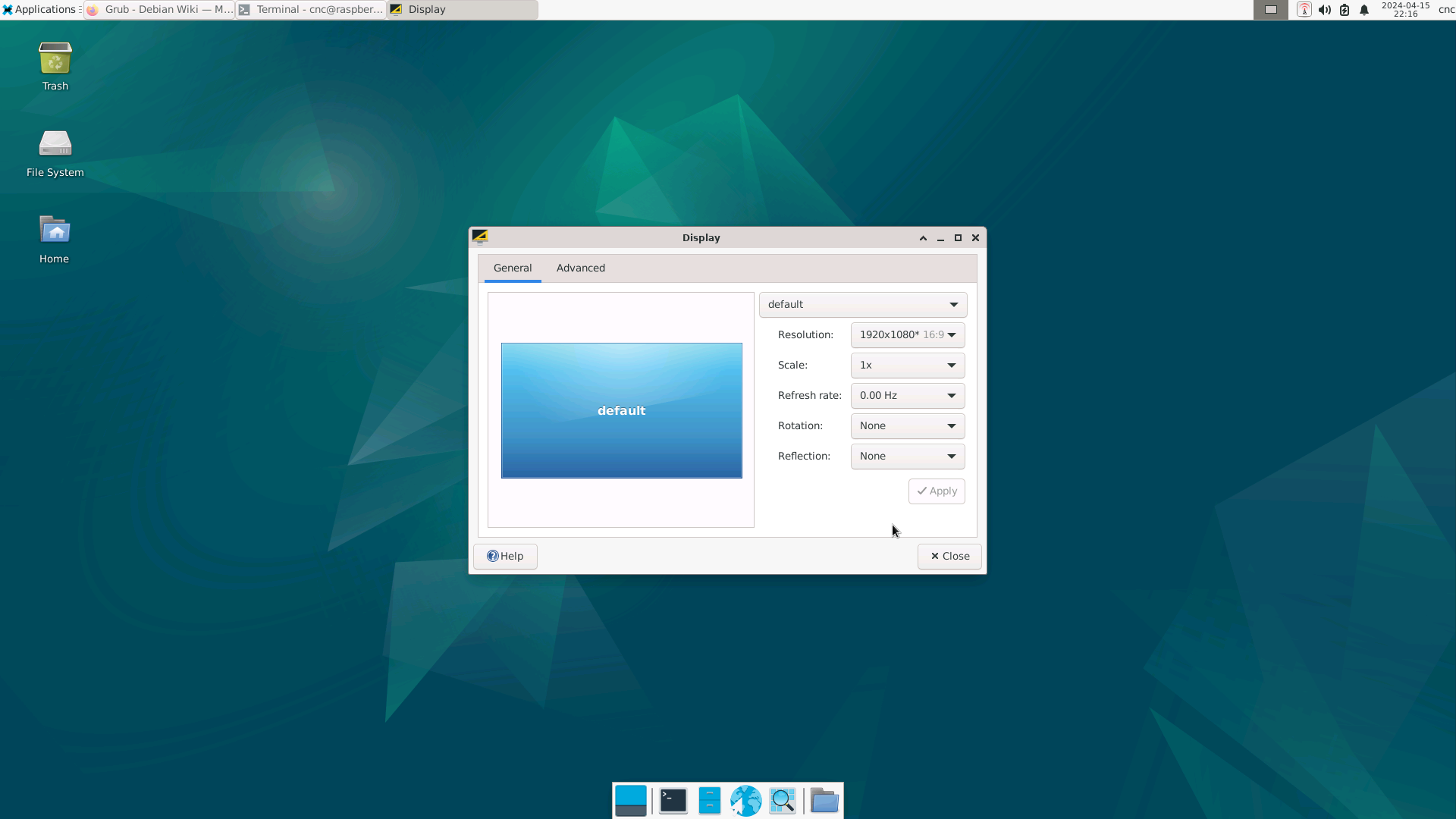

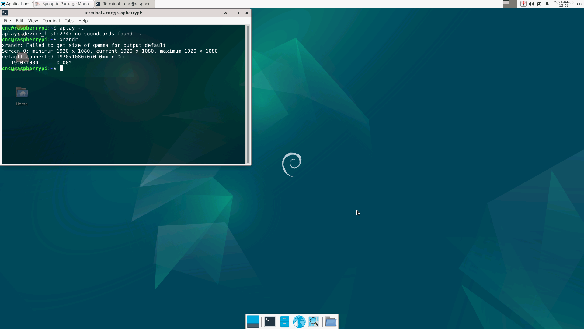

Hello.
I'm newbie linux and RPi5.
I did the connection with the Mesa card.
I also have a 10.1" IPS Touch display with resolution 1920x1200 @60 Hz + audio speakers.
But there is no sound, the resolution is only 1920x1080, no possibility to rotate the screen and can't find the grub (/etc/default/grub in sudo nano says it's a new file).
I'm hoping for your help.

- Posts: 1200
- Thank you received: 426
15 Apr 2024 23:52 #298317
Replied by Cant do this anymore bye all on topic LinuxCNC on Raspberry Pi 5
Raspberry Pi doesn't use grub
Resolution is a issue with this image
You may have to enable sound see
www.raspberrypi.com/documentation/computers/config_txt.html

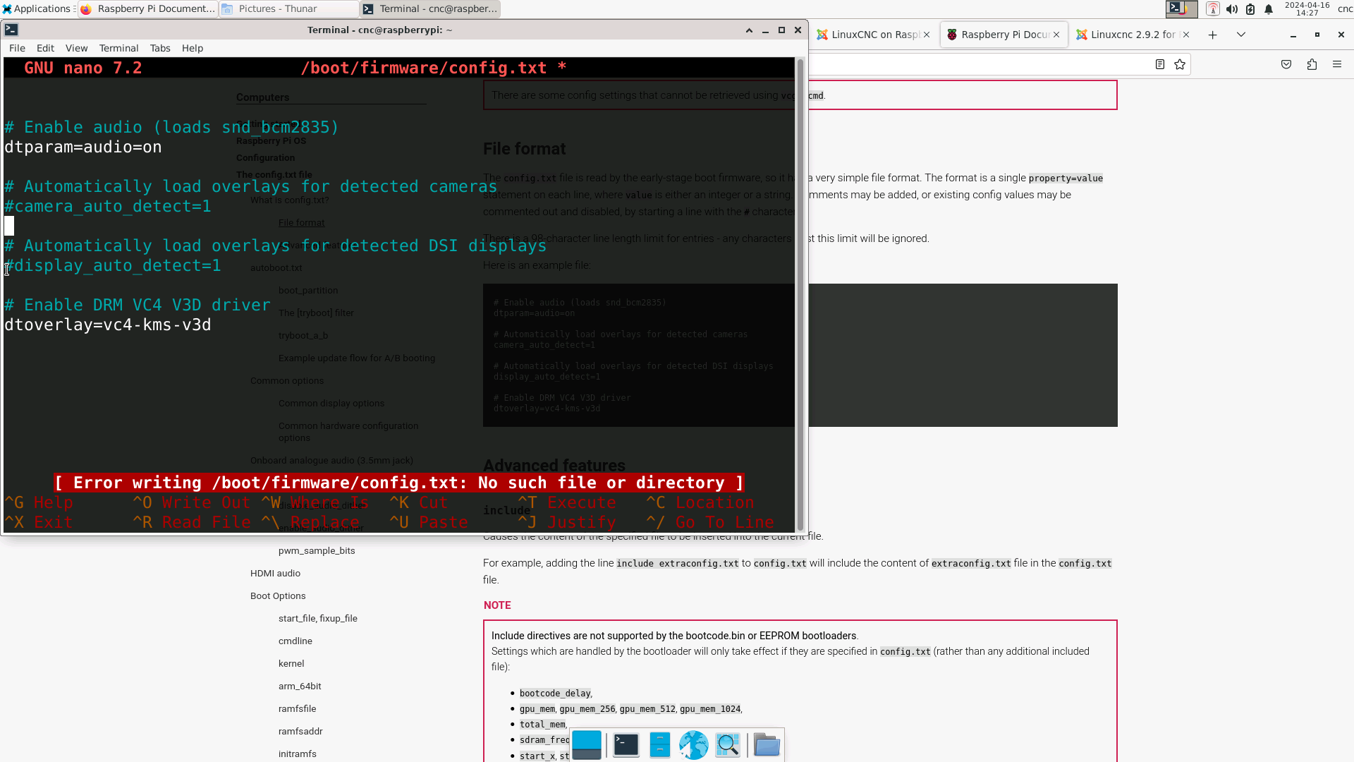

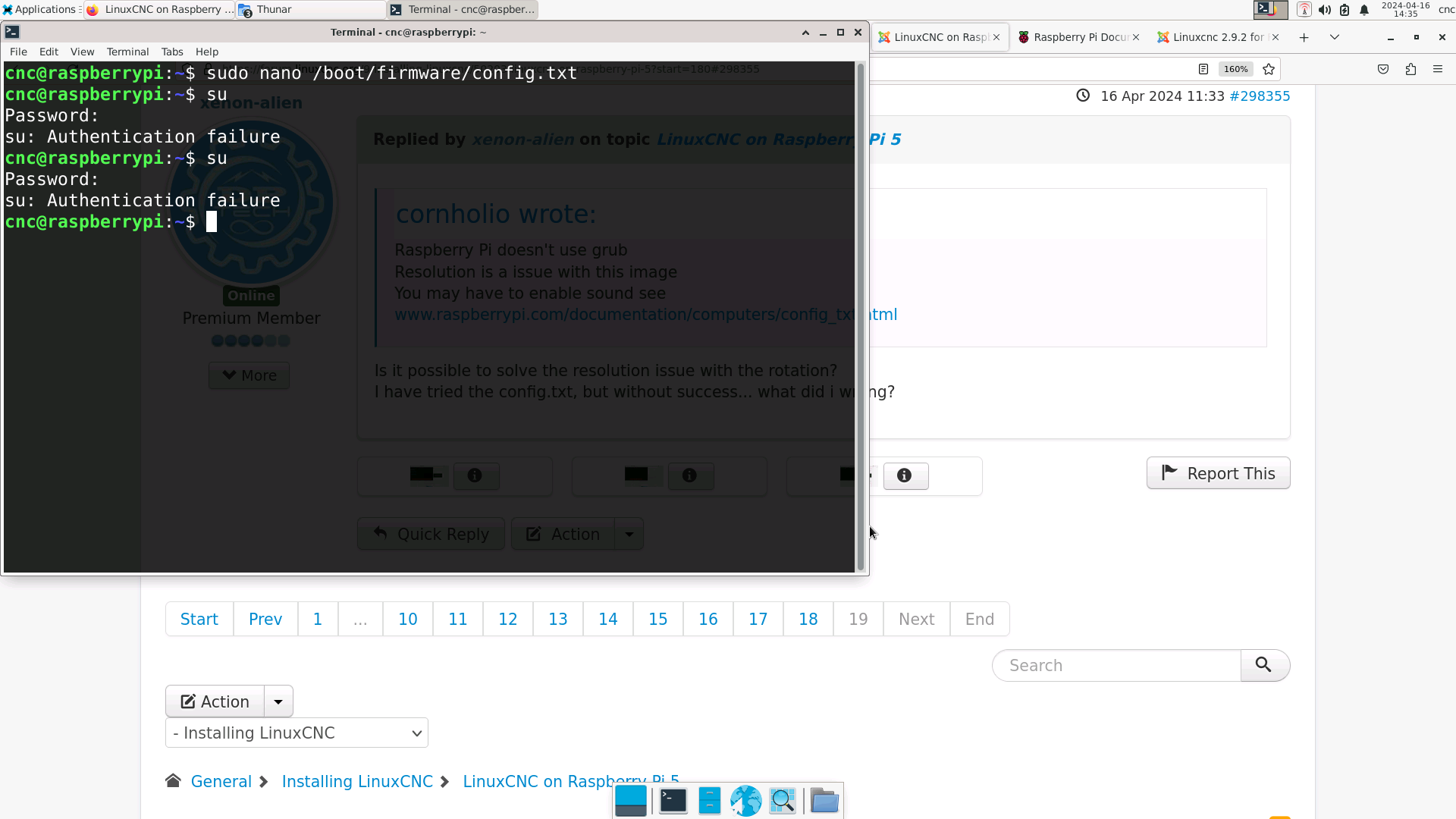

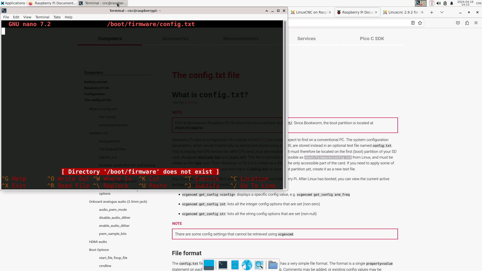

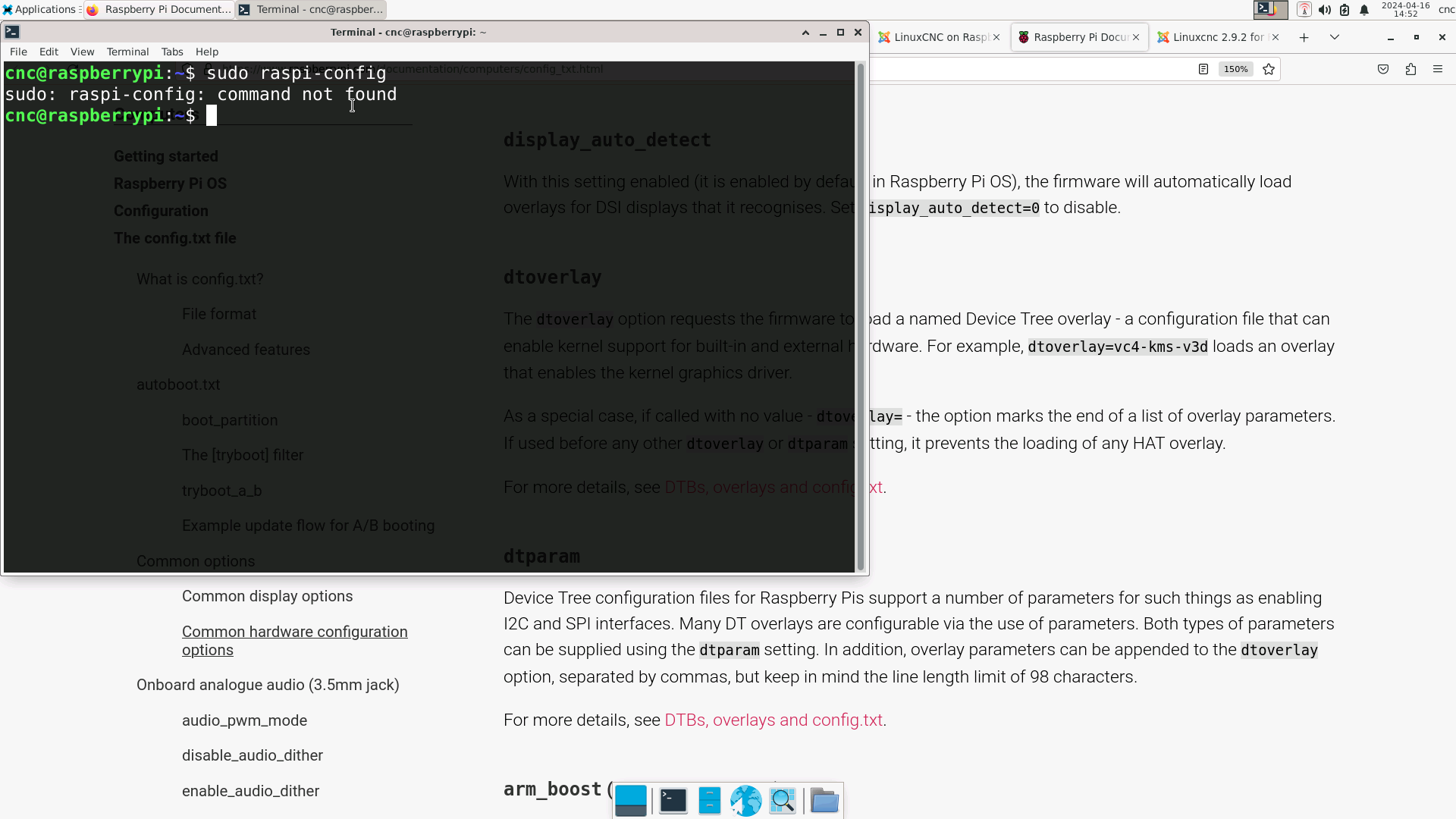

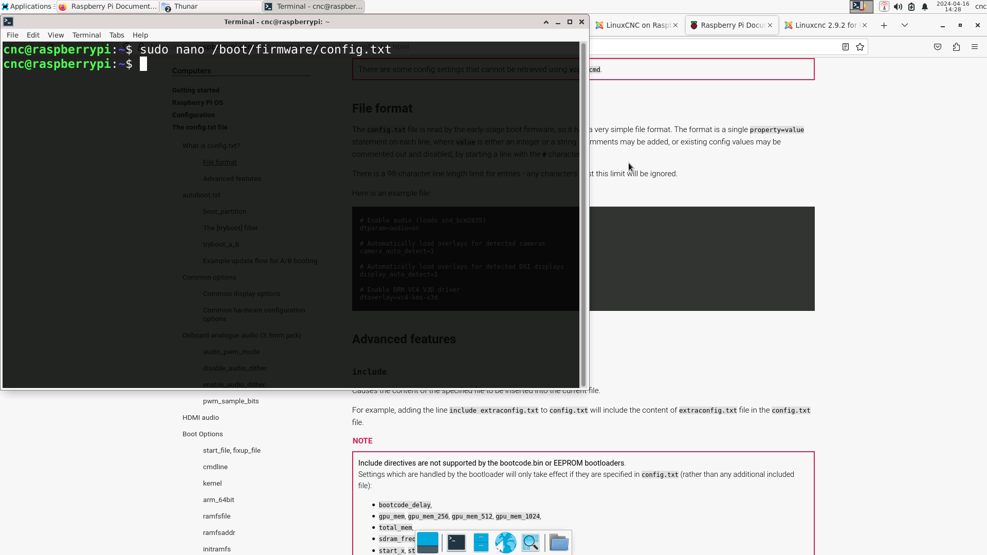

16 Apr 2024 11:33 #298355
by xenon-alien
I have tried the config.txt, but without success... what did i wrong?
Replied by xenon-alien on topic LinuxCNC on Raspberry Pi 5
Is it possible to solve the resolution issue with the rotation?Raspberry Pi doesn't use grub

- Posts: 1200
16 Apr 2024 12:00 #298358
You'll have to look around in /boot
Sorry should have mentioned that.
