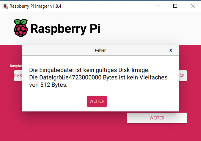

I get an error if I try to install the image for a Pi 5.

here is the translation:
The input file is not a valid disk image.
The file size 4723000000 bytes is not a multiple of 512 bytes

Replied by rodw on topic Linuxcnc 2.9.2 for Raspberry Pi 4 & 5 images
It appears that there is something about our image that the Rpi Imager does not like.
The guys are working on it.
Could you please try burning with Balena Etcher? etcher.balena.io/
This burnt and validated the image for me.

Yes, balena works for me,too.

It seems that we are using a slightly different compression method that the PI imager does not like.
Great! Please test it out a bit and give me some feedbackYes, balena works for me,too.
