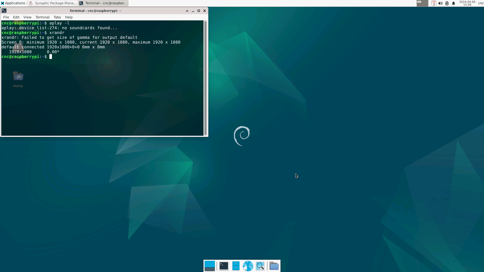

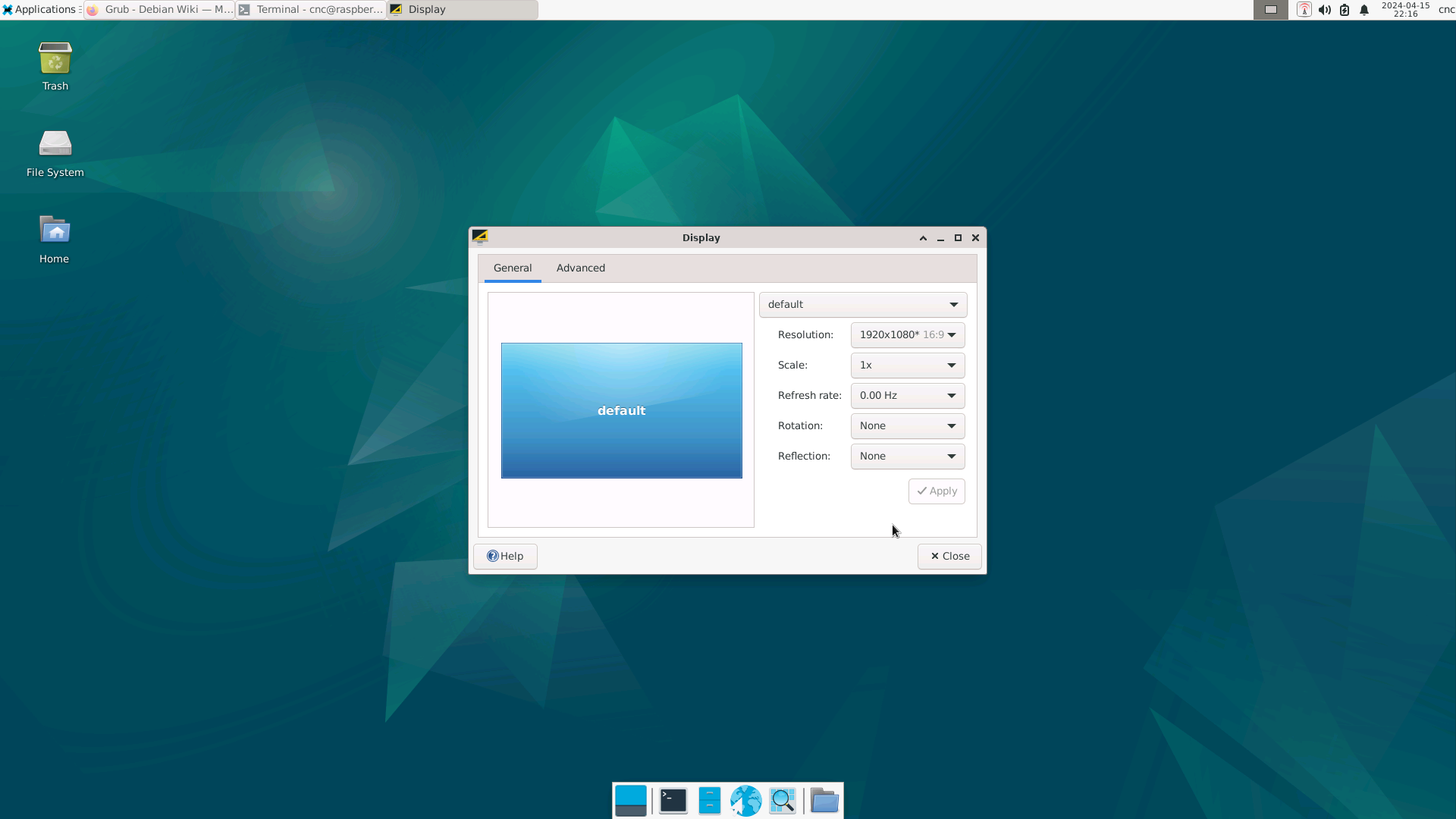

Hello.
Sorry that I'm asking 2nd time, but...
How can I change the resolution, orientation (+touch) and make it sound?
I have a 10.1" IPS Touch display with resolution 1920x1200 @60 Hz + audio speakers.
But there is no sound, the resolution is only 1920x1080, no possibility to rotate the screen.
Is it possible to make it work?
On a Windows system the display works fine. (even tried on the Orange Pi PC with Armbian and it almost worked)
My config.txt file
My config.txt file
arm_64bit=1
initramfs initrd.gz followkernel
# uncomment if you get no picture on HDMI for a default "safe" mode
#hdmi_safe=1
# uncomment this if your display has a black border of unused pixels visible
# and your display can output without overscan
disable_overscan=1
# uncomment the following to adjust overscan. Use positive numbers if console
# goes off screen, and negative if there is too much border
#overscan_left=16
#overscan_right=16
#overscan_top=16
#overscan_bottom=16
# uncomment to force a console size. By default it will be display's size minus
# overscan.
framebuffer_width=1920
framebuffer_height=1200
# uncomment if hdmi display is not detected and composite is being output
hdmi_force_hotplug=1
# uncomment to force a specific HDMI mode (this will force VGA)
hdmi_group=2
hdmi_mode=87
hdmi_cvt=1920 1200 60 5 0 0 0
# uncomment to force a HDMI mode rather than DVI. This can make audio work in
# DMT (computer monitor) modes
hdmi_drive=2
# uncomment to increase signal to HDMI, if you have interference, blanking, or
# no display
#config_hdmi_boost=4
# uncomment for composite PAL
#sdtv_mode=2
# camera
#start_x=1
#gpu_mem=128
# automatically load overlays for detected cameras
#camera_auto_detect=1
# automatically load overlays for detected DSI displays
#display_auto_detect=1
# uncomment to overclock: https://www.tomshardware.com/how-to/overclock-any-raspberry-pi
#arm_freq=
#gpu_freq=
#core_freq=
#over_voltage=
#force_turbo=1
# uncomment some or all of these to enable the optional hardware interfaces
#dtparam=i2c_arm=on
#dtparam=i2s=on
#dtparam=spi=on
# uncomment this to enable infrared communication.
#dtoverlay=gpio-ir,gpio_pin=17
#dtoverlay=gpio-ir-tx,gpio_pin=18
# additional overlays and parameters are documented /boot/overlays/README
# enable audio (loads snd_bcm2835)
dtparam=audio=on
# enable uart
enable_uart=0
# disable wifi and bluetooth
#dtoverlay=disable-wifi
#dtoverlay=disable-bt
#dtoverlay=pi3-disable-wifi
#dtoverlay=pi3-disable-bt
# remove test rainbow
disable_splash=1
# disables the warning overlays
#avoid_warnings=1
[cm4]
# Enable host mode on the 2711 built-in XHCI USB controller.
# This line should be removed if the legacy DWC2 controller is required
# (e.g. for USB device mode) or if USB support is not required.
otg_mode=1
[pi4]
# enable DRM VC4 V3D driver on top of the dispmanx display stack
dtoverlay=vc4-kms-v3d
#dtoverlay=vc4-fkms-v3d
max_framebuffers=2
arm_boost=1
max_usb_current=1
