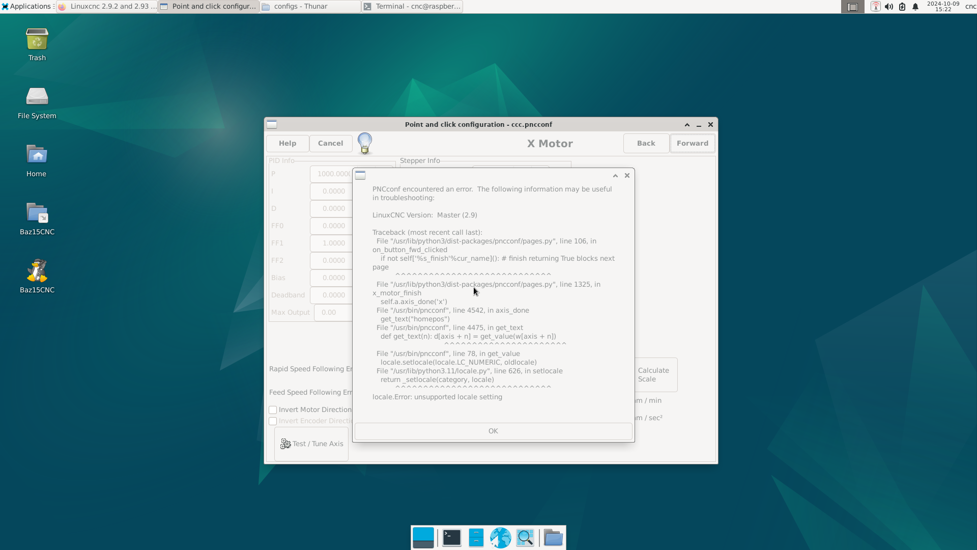

Set the Linux locale to UTF-8, probably like this
stackoverflow.com/questions/20577764/set...system-default-utf-8

I did something, to display the correct time choosing Kyiv (Ukraine) in local.... something (and want to use other languages to type and search on the internet)
May be that was the cause?

Do I have to return it in landscape mode before rotating it with this script?
Can you tell me how can I rotate the touch part of the screen too?
Try this, otherwise it is a mess to sift through endless posts on several forums to get the right answer, been there and done that, twice.
gist.github.com/mildmojo/48e9025070a2ba40795c

11 Oct 2024 19:13 #311829
Replied by tommylight on topic Linuxcnc 2.9.2 and 2.93 images for Raspberry Pi 4b & 5
No, it should do the rotation of both the screen and touch.
At least that is what it says, i have not used it, i did it the old way and it is long and painful, so if this works, do report back, please.

12 Oct 2024 14:02 - 12 Oct 2024 14:03 #311865
by xenon-alien
If it will rotate both, I need to change it from portrait orientation back again to landscape and only after that use the script.
Is it correct?
Because it's now in portrait mode and the touch works not correctly. (as on the photo above)
Replied by xenon-alien on topic Linuxcnc 2.9.2 and 2.93 images for Raspberry Pi 4b & 5
You confused me...No, it should do the rotation of both the screen and touch.
Is it correct?

From the link
Rotates modern Linux desktop screen and input devices to match.Please Log in or Create an account to join the conversation.

The English not is my native language and not really understand that sentence.
I'm not a Linux advanced user in terminal and scripts.
So, what does it mean?
1) I'm rotating the screen with Linux graphical UI and after that I have to use the script to rotate the touch.
2) The script rotates the screen and the touch together (both) in one direction. (in this case i need to return the default landscape mode)

Even in english it is not very clear, but should be 2.
The following user(s) said Thank You: xenon-alien
