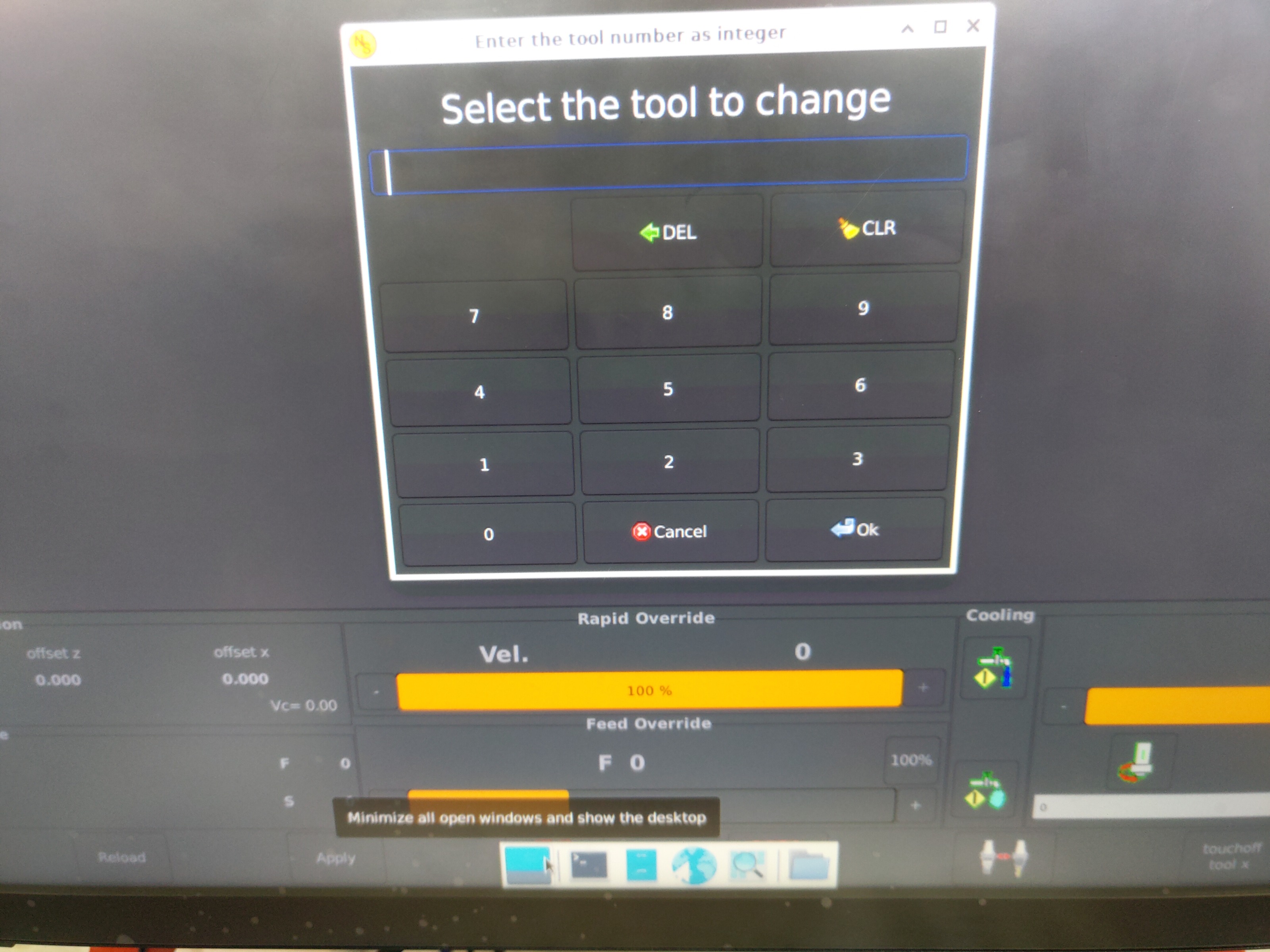

I found another small bug. Then I change a tool the icons of the desktop menu become visible (see picture below).

That is nothing to do with the installation process. I can't help. Report in the correct GUI sectionHi,

That's normal behaviour for the bottom panel in Debian for XFCE (for amd64 & arm64) when you move the mouse over the area where the panel would be no matter the application you are using, if you right click on the panel you can change the properties. Not a bug & does not require reporting.

Aah, now I know what you were looking at. an XFCE feature
