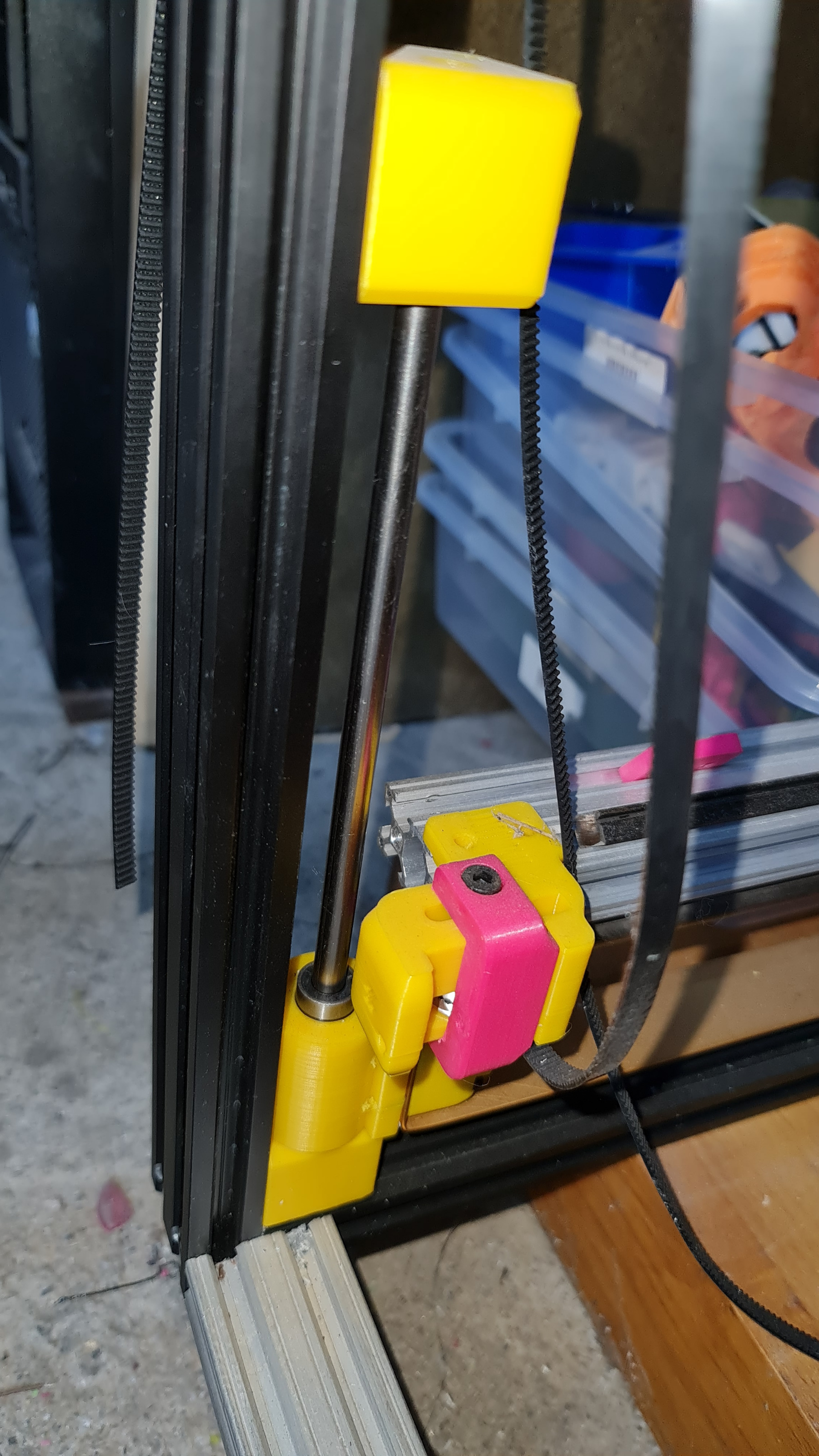

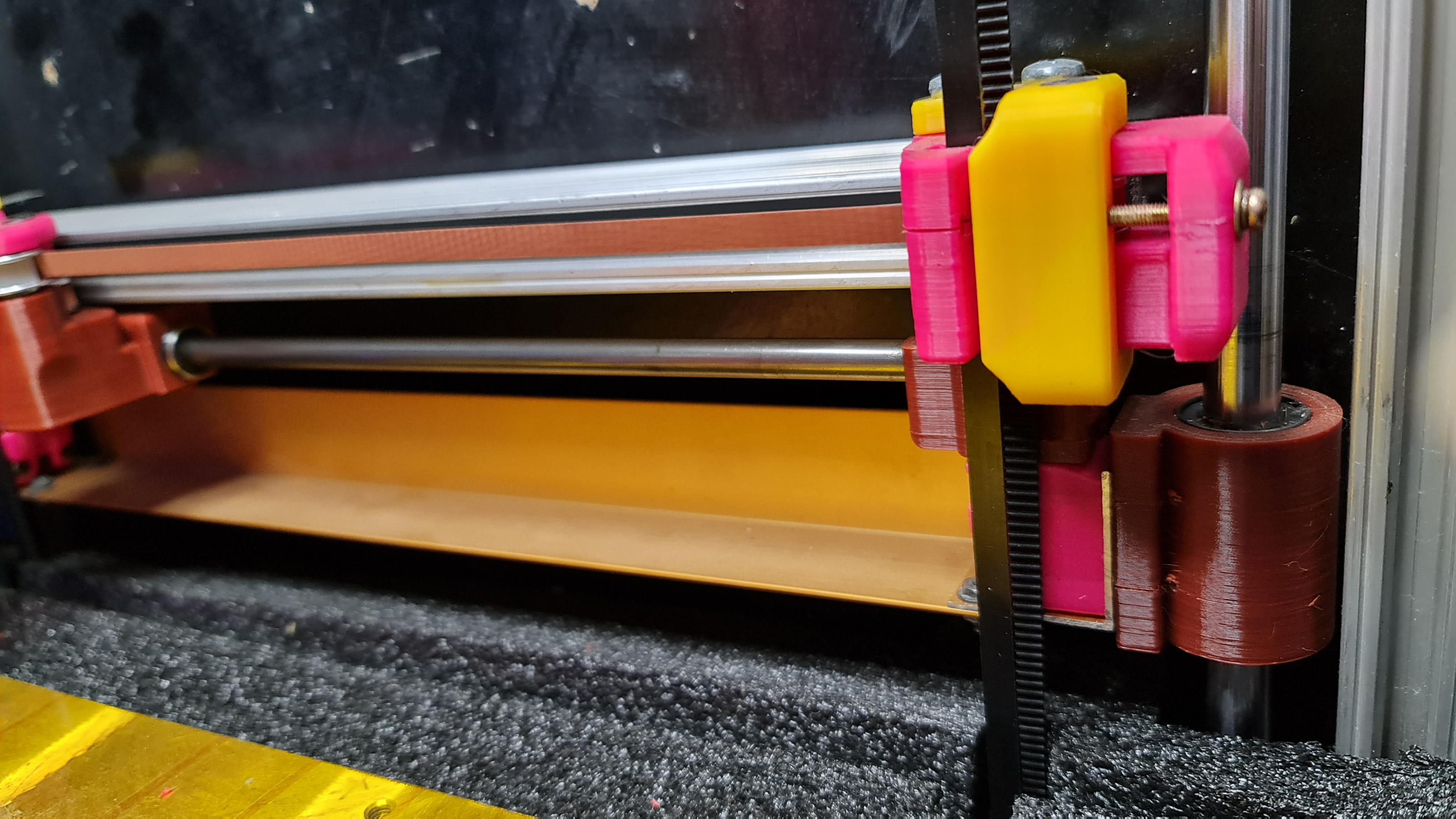

09 Jul 2024 23:57 #304779
Replied by tommylight on topic 3D printed stuff, showcase it here

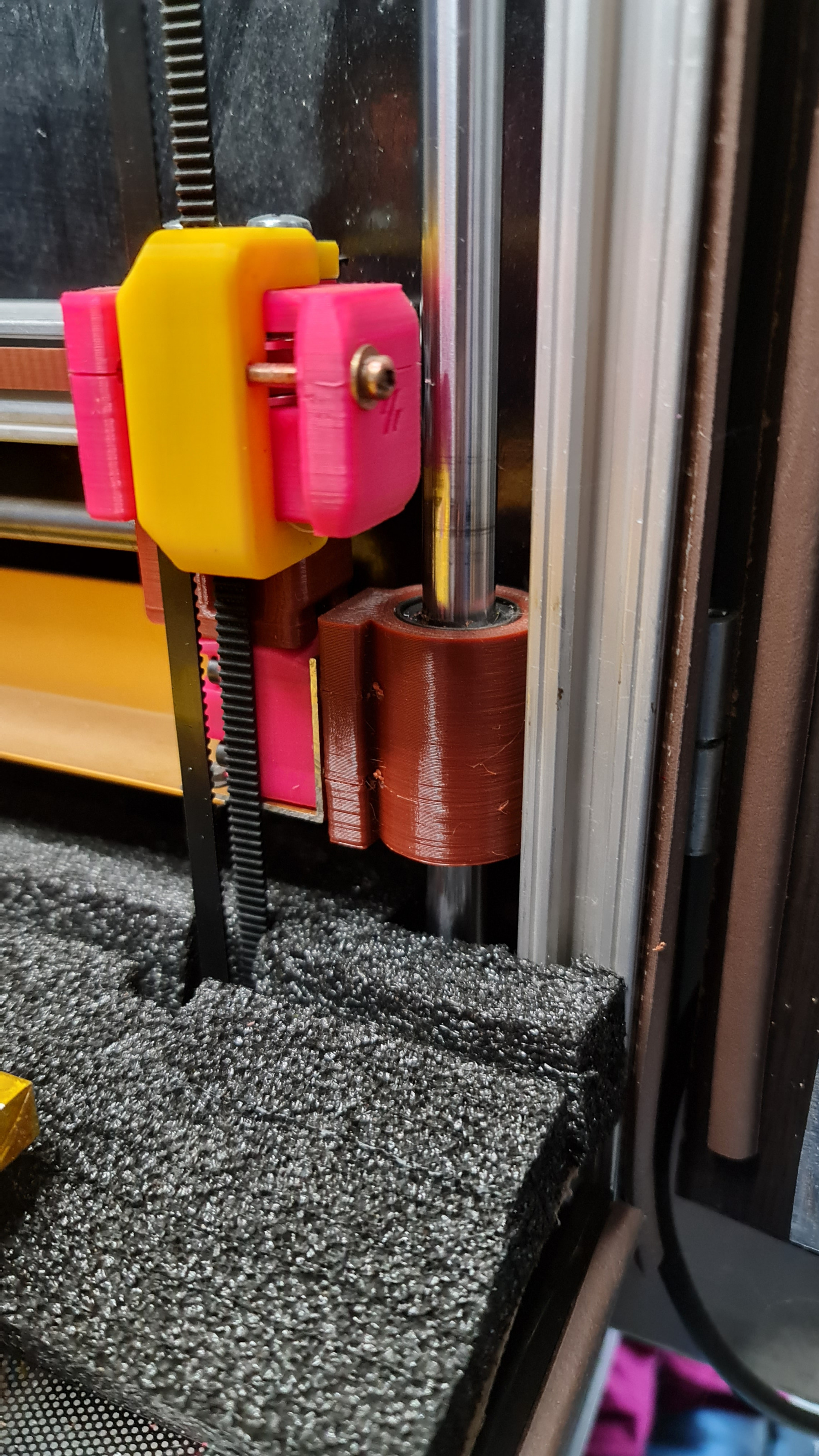

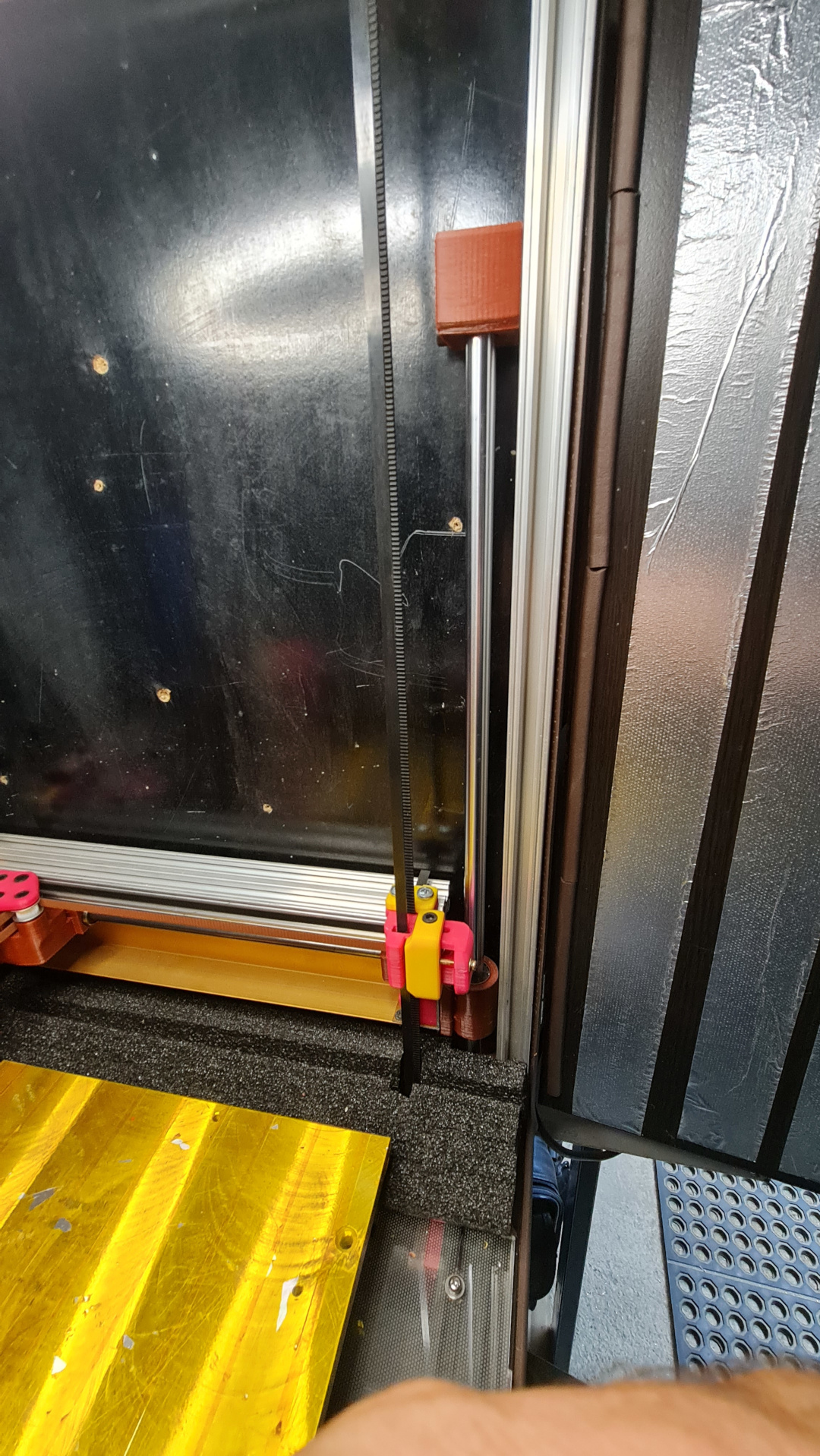

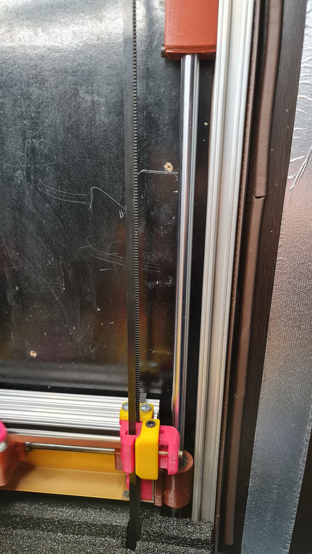

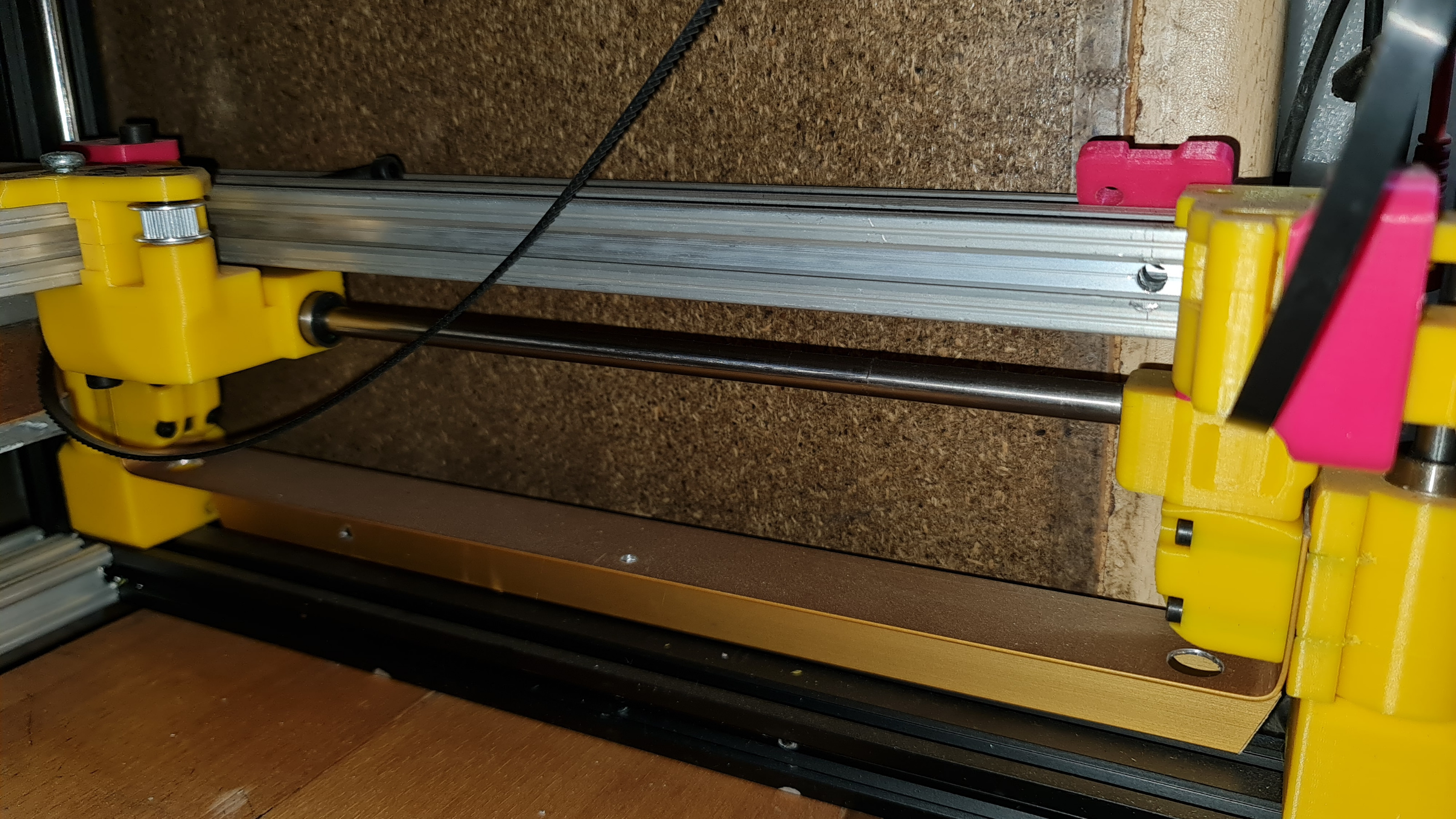

Some close ups of the modified Voron 2.4 that uses linear rods instead of linear rails on Y and Z axis, so only a single linear rail is required in total:
-Z and Y rails, brown parts are modified only, and an aluminium L profile is added to prevent carriages from moving sideways while still leaving some flex for up/down motion during quad gantry leveling
-one of the Z rails with the rail mount up, the lower mount can not be seen from the insulation foam, all Z rod mounts are the same and have holes for side or top/bottom mounting, this has 10mm Z rods
-a smaller printer, this one with 8mm rods on Y and Z
-a smaller printer, full Y axis with L shaped aluminium mounted upside down there is enough space for it
-full view of the bigger 10mm Z axis
-full view of the 3d printer, it did some 20 days of 24h printing in one go, gets used weekly.
This one i am calling "woody" as it is fully enclosed in wood and during long prints the motors get to 112 degree C! Probably overdid with thermal isolation...
Will also release the full STL's on printables when i double check them and sort them properly as the Y axis uses only 8mm rods but i have two versions for 6mm belt and for 10mm belt, the Z axis has options for 8 and 10 and 12mm rods.
The 3 printers i built with these mods are of following volumes:
210x210x350mm
300x235x250mm
460x460x1200mm
