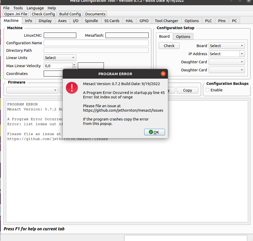

25 Sep 2022 15:41 - 25 Sep 2022 15:48 #252714
by mgm
Replied by mgm on topic Mesa Configuration Tool
Last edit: 25 Sep 2022 15:48 by mgm.

25 Sep 2022 19:08 #252726
by JT
Replied by JT on topic Mesa Configuration Tool
That error was fixed with Build Date 9/23/2022. Looks like I forgot to build a deb and push it. Get a fresh copy of the deb in a few minutes after I build and push.
JT

25 Sep 2022 19:18 #252730
by HansU
Replied by HansU on topic Mesa Configuration Tool
It still appears with the version from 09/25 e538b0fe9d77512bf4ea0e5d9a5c0648e494d017 (at least under Ubuntu, see also my other post)
