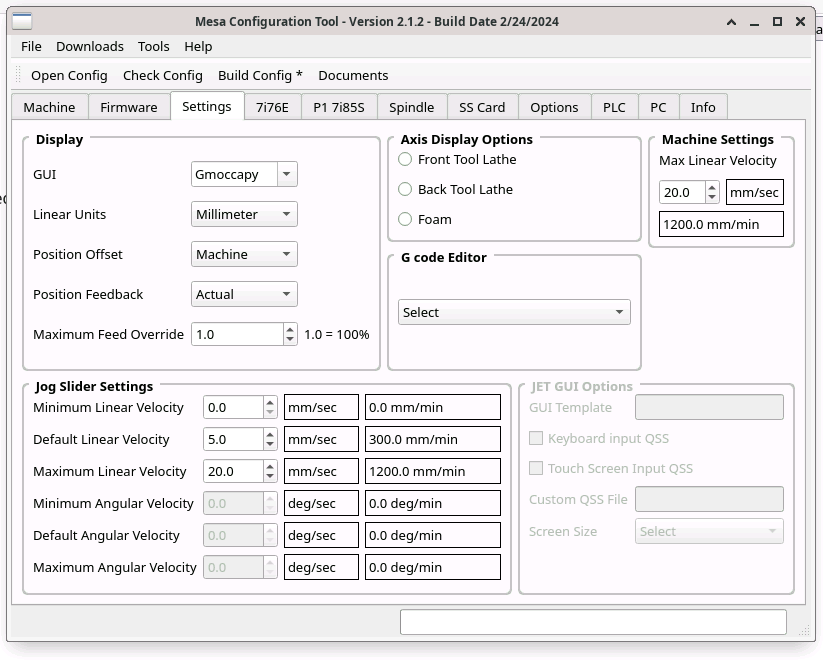

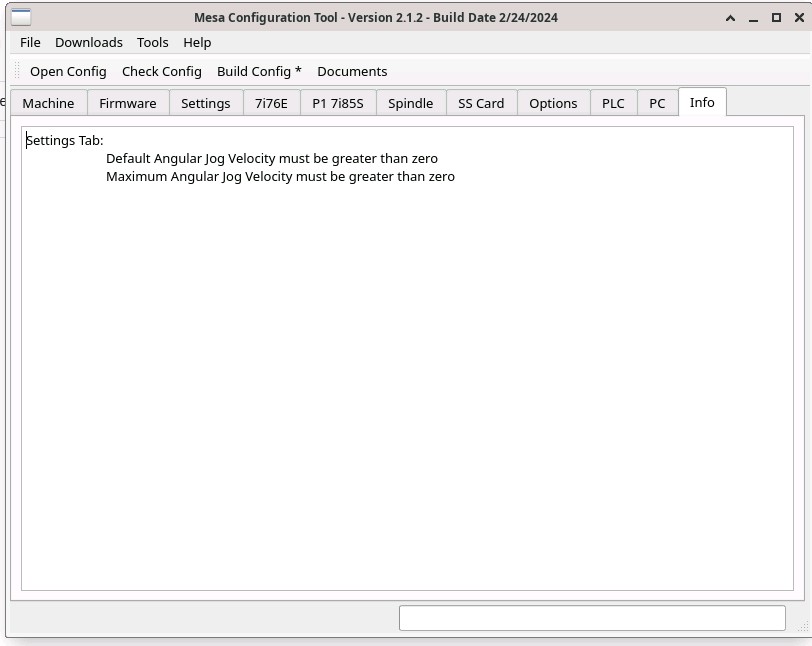

Great tool but I'm having a problem. I'm running Linuxcnc 2.9.2 on a RPi5 with MESA 7i76E and 7i85S boards. In the Setting/Jog Slider Settings the three Angular Velocity setting are greyed out so I can not enter values. The result of Build Config is a message in the Info tab :Settings Tab:Default Linear Jog Velocity must be greater than zeroMaximum Linear Jog Velocity must be greater than zero
Is there something I've missed in the settings somewhere?

If you don't have any rotary axes the angular velocity settings are not used.
For linear axes you must set the default linear jog velocity.
Just looked at the images and it shows default angular jog velocity must be set. What axes do you have configured?
