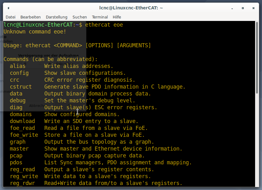

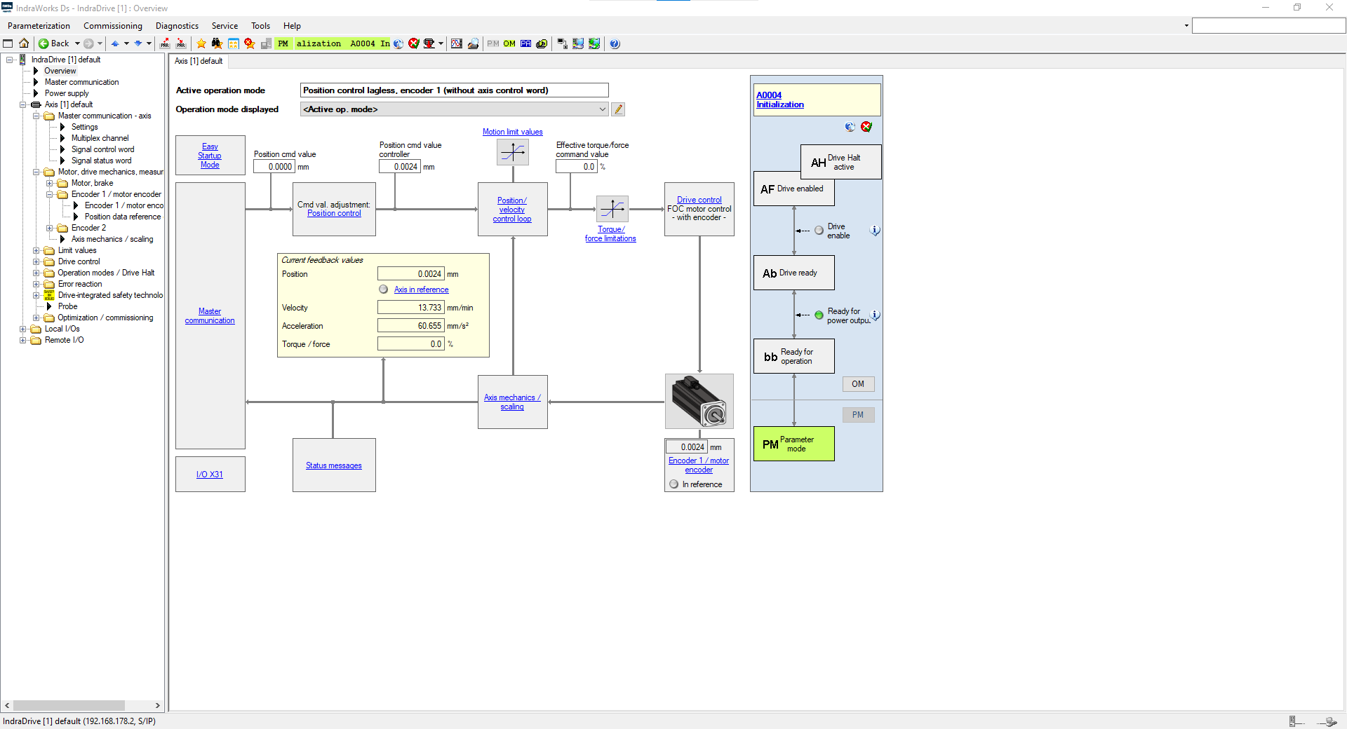

I dont know which OperationMode is selected from LinuxCNC.
In TwinCAT it is Position Control lagless Encoder 1
The ethercat eoe command in terminal gives an error message. I tried it earlier today, as i read the IGH Etherlab master manual. seems it isn´t activated.

you've said before that all control stuff is done in the drive, that meens that in linuxcnc there is no pid controller, joint-x-pos-cmd is directly connected to position command pdo.... So the drives behaviour should be as before.
Is there any difference if you control the drive with the indradrive setup functions to the drives behaviour with twincat? (may the twincat control loop makes the movement smooth)
I think that after switching the communcation to coe in indraworks another set of parameters gets active, so this parameters have to get tuned again.
can you please post the terminal output of "ethercat eoe" before and after linuxcnc start.

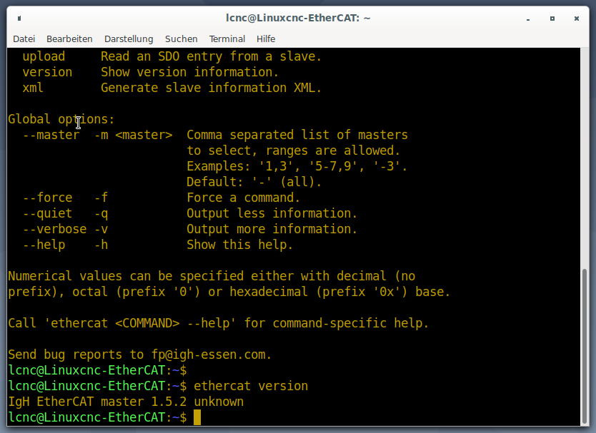

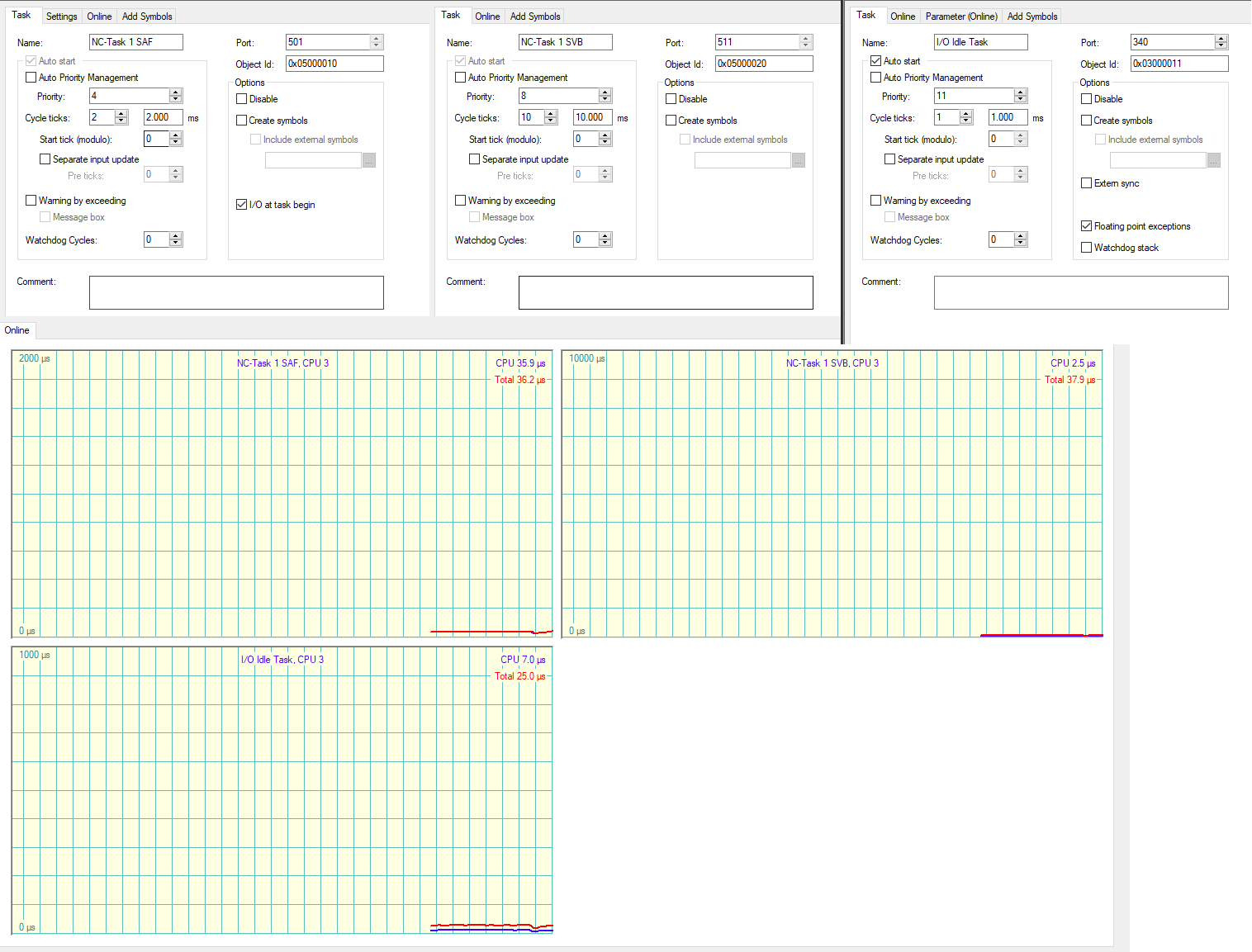

What is Twincat Base Cycle Time, NC SAF Cyle Time and NC SVB Cycle Time ?
What is the output of "ethercat version" ?

EtherCAT Version replies this: The other things i must boot in Windows and look after it.Hope this is what you meant.this is full control loop in the drive, trajectory output from twincat direct to pos-command. Twincat control is done after switching to CoE, that meens that this are the same Parameters as for LCNC. Strange... What is Twincat Base Cycle Time, NC SAF Cyle Time and NC SVB Cycle Time ? What is the output of "ethercat version" ?
Last edit: 18 Feb 2021 19:15 by jc2ktr. Reason: Image Cycletimes added

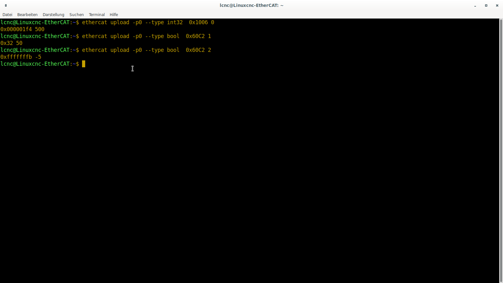

19 Feb 2021 12:44 #199413
by jc2ktr
which type of value are them?
lcnc@Linuxcnc-EtherCAT:~$ ethercat upload -p0 --type int32 0x1006 0 = 0x000001f4 500
lcnc@Linuxcnc-EtherCAT:~$ ethercat upload -p0 --type bool 0x60C2 1 = 0x32 50
lcnc@Linuxcnc-EtherCAT:~$ ethercat upload -p0 --type bool 0x60C2 2 = 0xfffffffb -5
hope i got the types right.

- db1981
- Posts: 790
- Thank you received: 276
19 Feb 2021 13:25 - 19 Feb 2021 13:53 #199417
by db1981
Replied by db1981 on topic Ethercat HAL driver
hello,
0x1006 is the com cycle time = 500µs this is equal to your ethercat app cycle time
0x60C2 is the interpolation time, it's also 50ms * 10^ -5 = 500µs.
is your servo_period in the ini (thread which executes lcec_read/write) also set to 500000ns (2khz) ?
