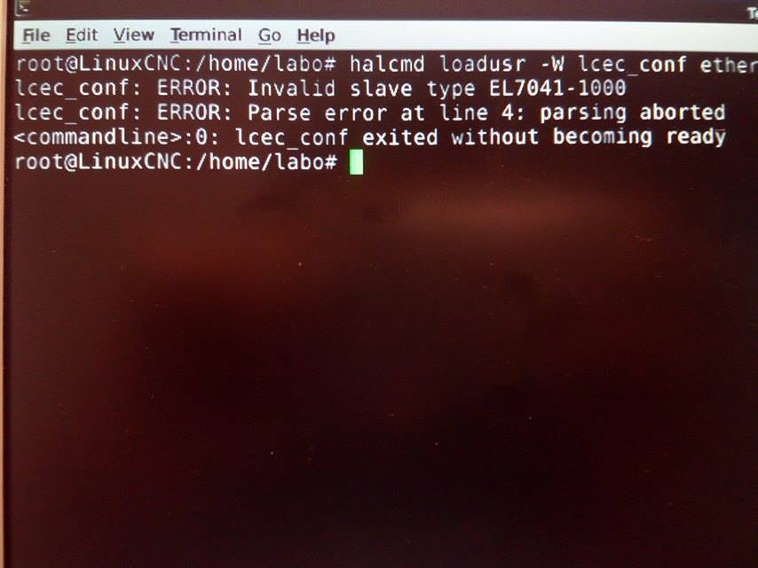

The problem is: When I enter a line in the .xml file such as:
<slave idx="2" type="EL7041" name="7041"/>
It says: ERROR: invalid slave type EL7041. ERROR: Parse error at line 6: parsing aborted.
This is bcs EL7041 is not in the list of supported hardware. EL7041-1000 is.
So I am guessing I need to add some data to that "glue" layer that automatically connects the registers/addresses in the hardware and assigns variables from the type lcec.0.2124.dout-1 for example...which is lcec_conf, right? So I was asking for a bit of help on this maybe..how to proceed and what are all of the files that need to be modified.

write <slave idx="2" type="EL7041-1000" name="7041-1000"/>
and use the 7041.
It is running.
regards Frank
